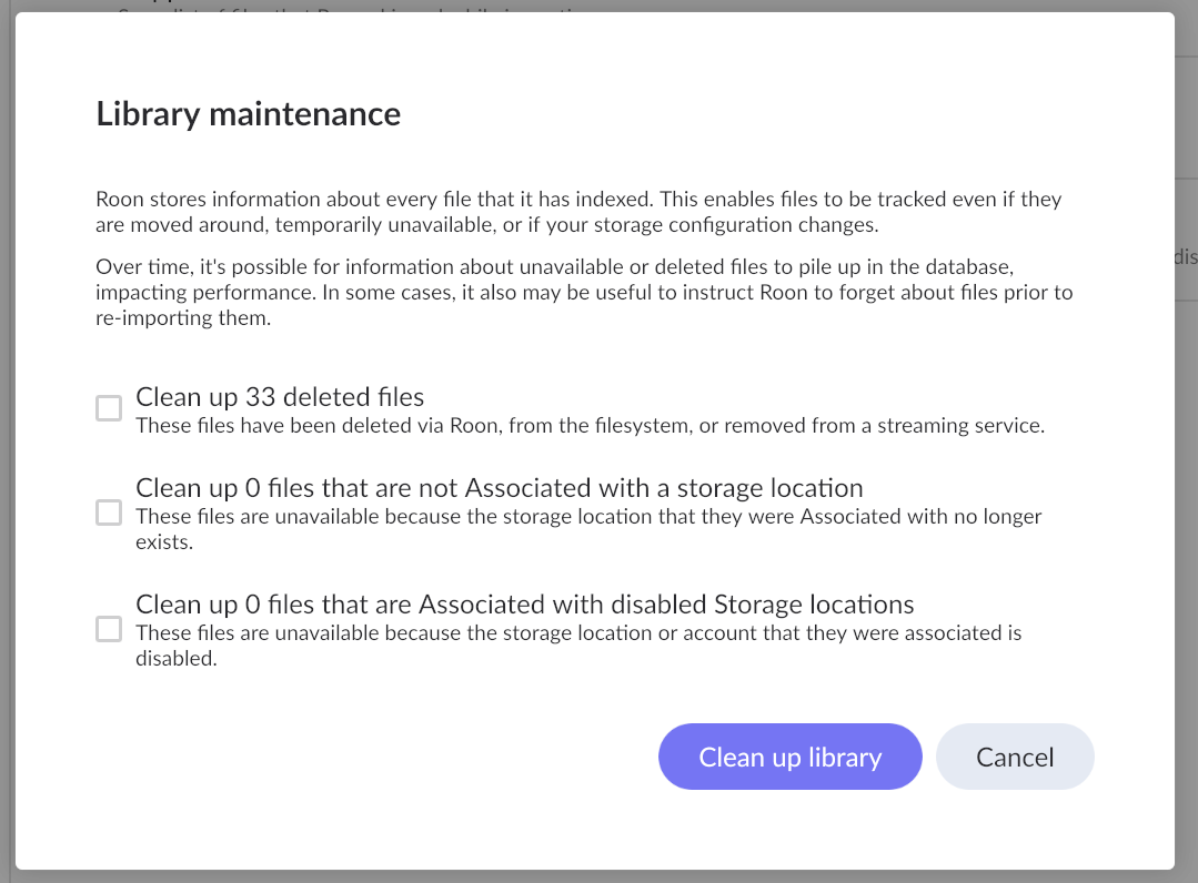

So my system just updated to 1207, and took ages to update the database. It is working now but Library Clean-up shows this;
It didnt show that before.
My album count has also dropped.
How do I identify the files (presumably Qobuz titles?) that are now missing?
I just checked here - 369 files to be deleted when the figure was zero before the update. Hmm.

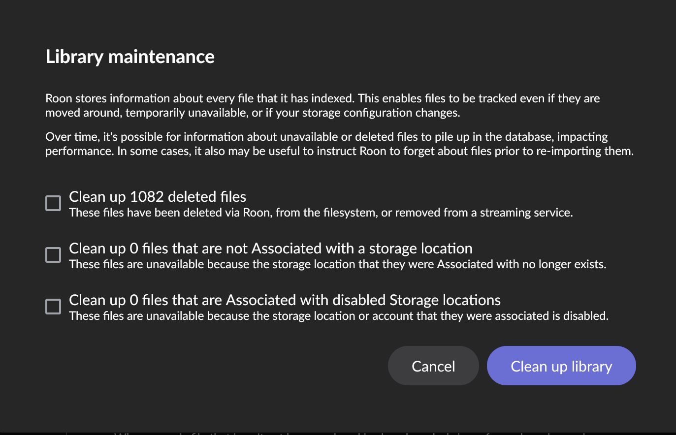

So now I have 1082 suddenly and I obviously won’t click the Clean up button now as long as this issue isn’t clarified. However, even without the current uncertainty I would never want to click that.
Even more now :slight_smile:

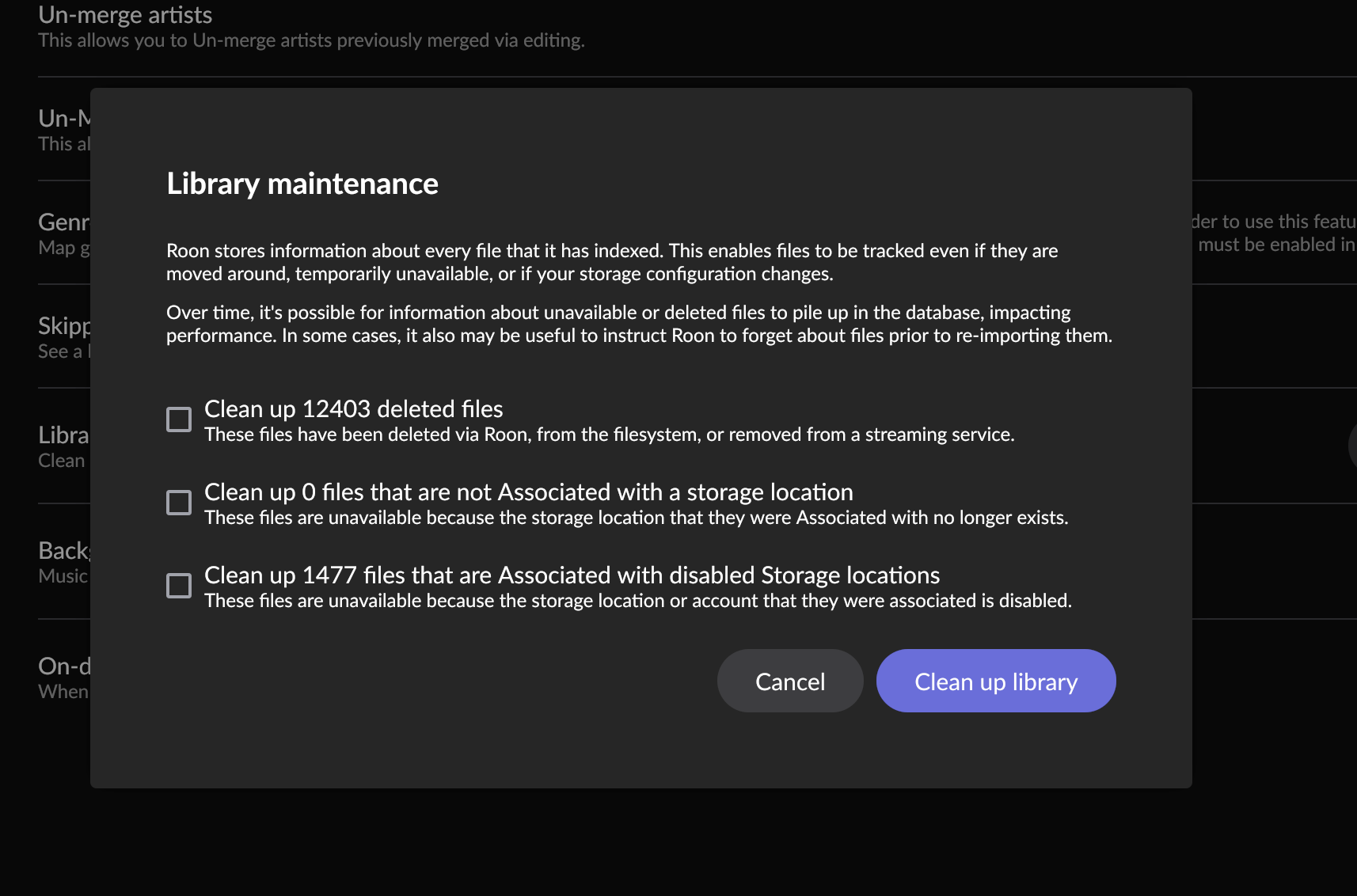

I’ve never dared touch the ā€˜Clean Up Library’ button, so don’t know what was there, previously, like there’s, but it does seem that there’s a lot of files previously indexed that I’m rather surprised about.
I seem to recall ā€˜starting again’ with my Roon library very early on, which may account for the rather large amount of files Roon is reporting below

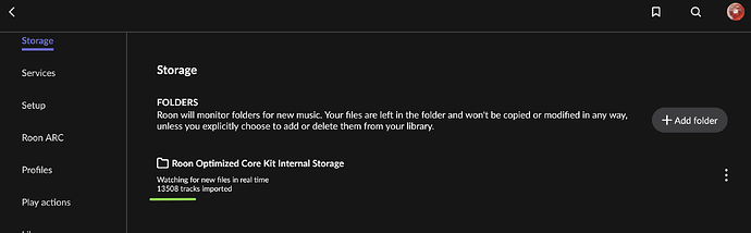

I don’t know if it’s related, but the reported numbers changed after I had to restore from last night’s backup because I inadvertently deleted an album of local files (with edits. By the way I am pretty sure that Roon showed me a streaming version and I removed this from the library, but then it actually removed the local version). The files were, however, still there on the storage drive after this.

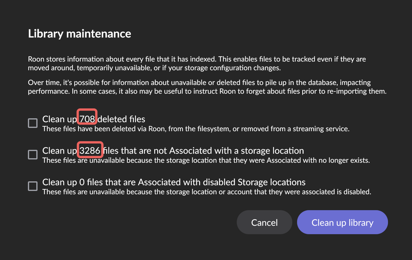

After the restore, it is now reporting 708 deleted files as opposed to the 1082 from 2 days ago (see a few posts up).
More concerning, it reports 3286 files not associated with a storage location, and the Home screen indeed shows 37860 tracks instead of the normal 41.146 (or so, definitely above 41K) . That wasn’t there 2 days ago (again, see above)
However, this is on a ROCK that only ever had the one internal storage location that it is still using, and as far as I recall it shows the same number of files it always did. (I thought I posted a screenshot recently somewhere but can’t find it)
Turns out that after the backup restore it failed to auto-login to Tidal, causing the 3287 files ā€œnot associated with a storage locationā€.

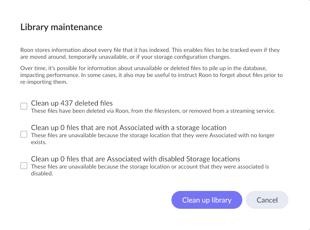

I did as you asked and did not clean up my library to retain the 437 ā€˜deleted files’
However yesterday 1212 was installed on to my core and remotes and the picture has now changed;
So now the number of deleted files has reduced a lot, but is still non-zero (it was zero before all this happened).
Any ideas as to what is going on here?

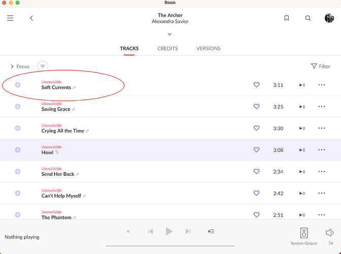

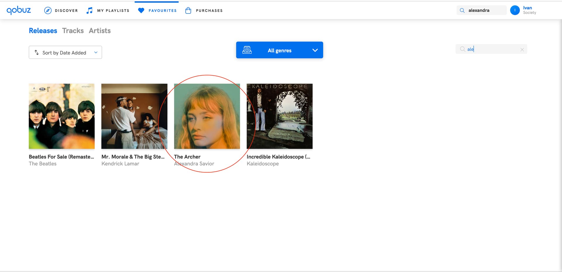

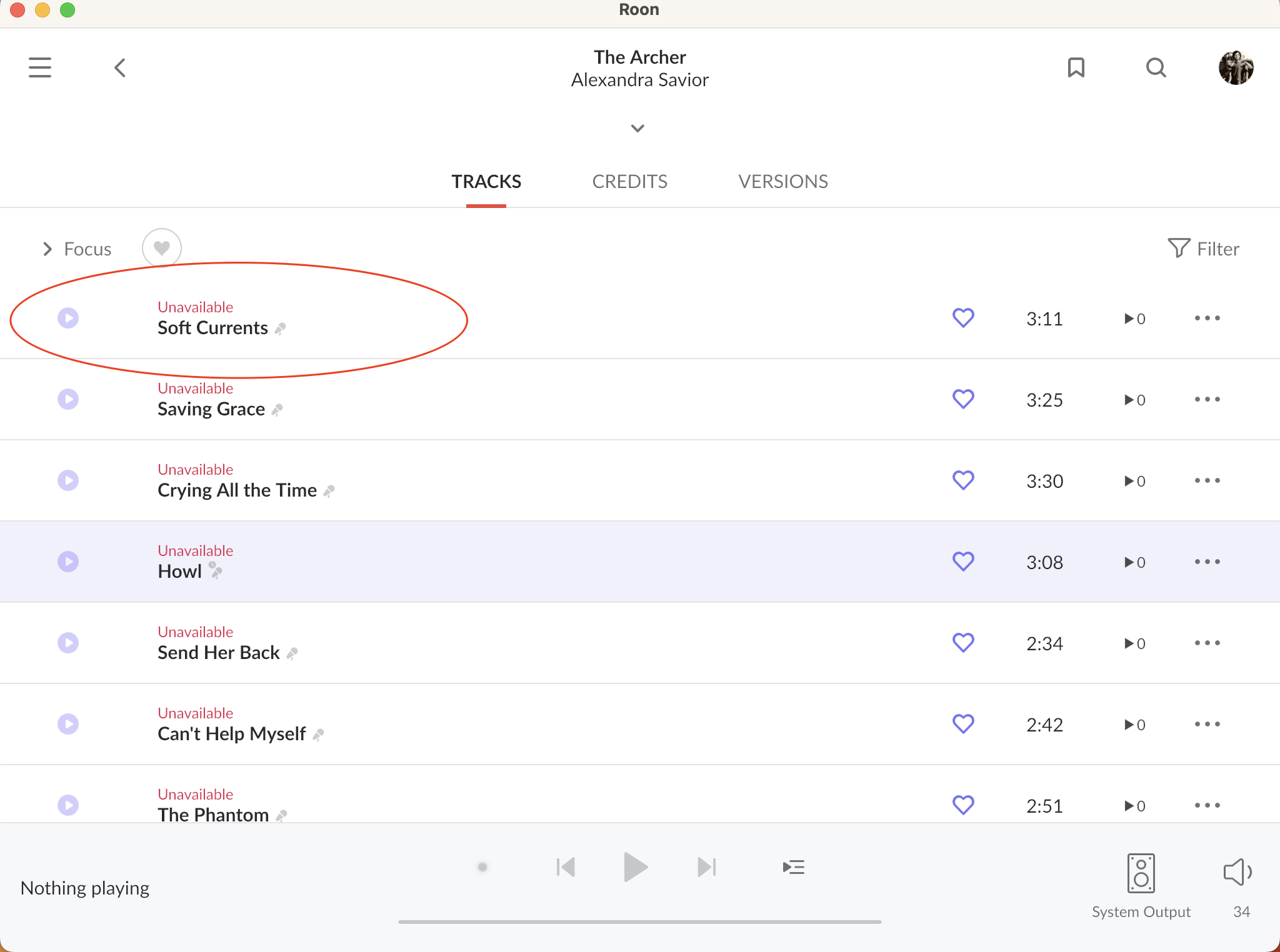

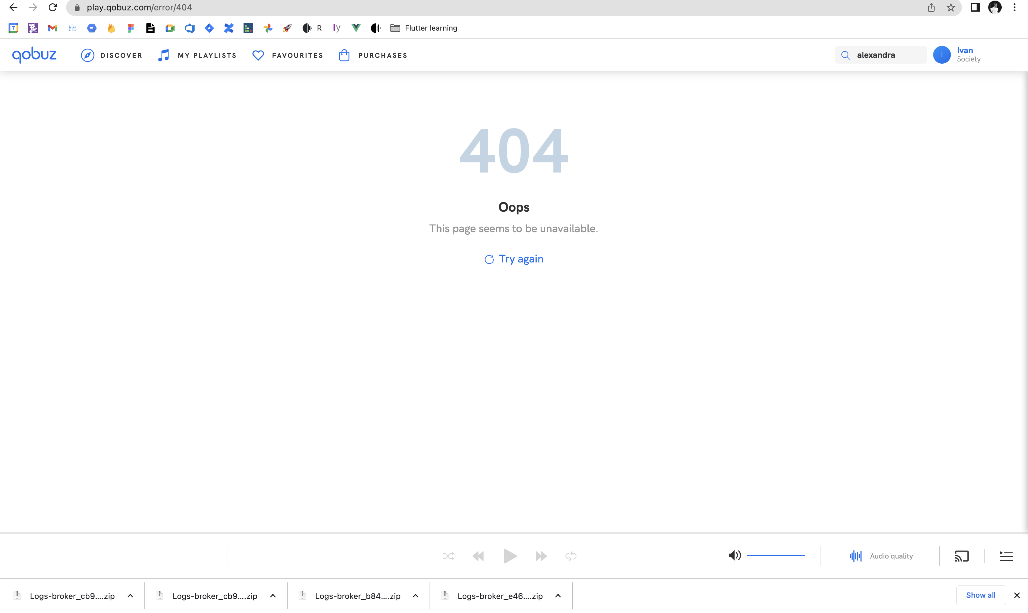

Hi, @Tim_Rhodes. The problem with deleted file is that Qobuz sometimes pulls down albums completely due to different reasons or pulls down and edition of an album and then puts back another version of this album but it’s album id changes. In the latter case such album will still be marked as favourite on Qobuz but a link to it will lead to a 404 Not Found page.
We will still show such album but none of the tracks will be available since. Here’s the example from my library:
So, when you first reported this problem deleted files appeared because Roon was not longer showing album which exhibited this behaviour. The fix was to restore this behaviour and make it align with production #1202 which also had a problem with that part but it exhibited itself in a bit different way. To sum up, the ā€œgood newsā€ here is that deleted files are not something which is still available and Roon randomly removed it but rather stuff that Qobuz pulled down and we cannot really control that part :frowning:
