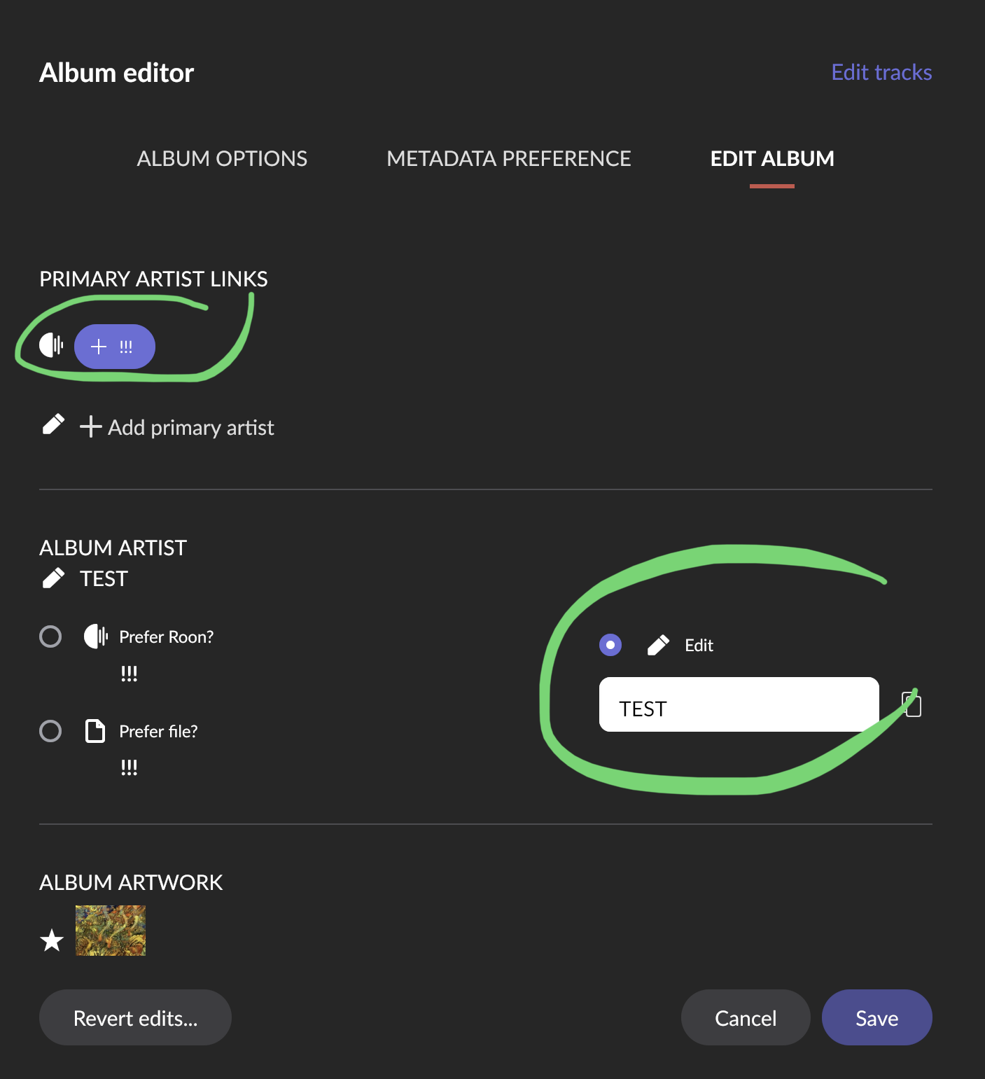

Asking because two somewhat similar display issues from 1235 were confirmed to be fixed on macOS and iPad with 1237, and if I see that correctly yours might not occur for me on iPad with 1237 either. At least in a quick test, I edited an album artist into an album:
And it looks fine on the album page if I understand your problem correctly:

But would you say that my test case looks as you would expect?
Unfortunately I can’t test on macOS right now because I poured a cup of hot cacao over my new Air and it’s in for a (costly) repair, so limited to iPad right now….
I would say that your test case is kind of correct. I tag my files in Yate so it would be the “prefer file” option that is already correct but that Roon is ignoring. If I go in & manually override it by typing something into that box, it then sorts where it’s supposed to.

Oh right, then your case may well be very different, my test was just a quick edit of the album artist in Roon directly, not in the file
Well, at least I know that will sort things the way I want them sorted, so it was worth it for finding that out.
