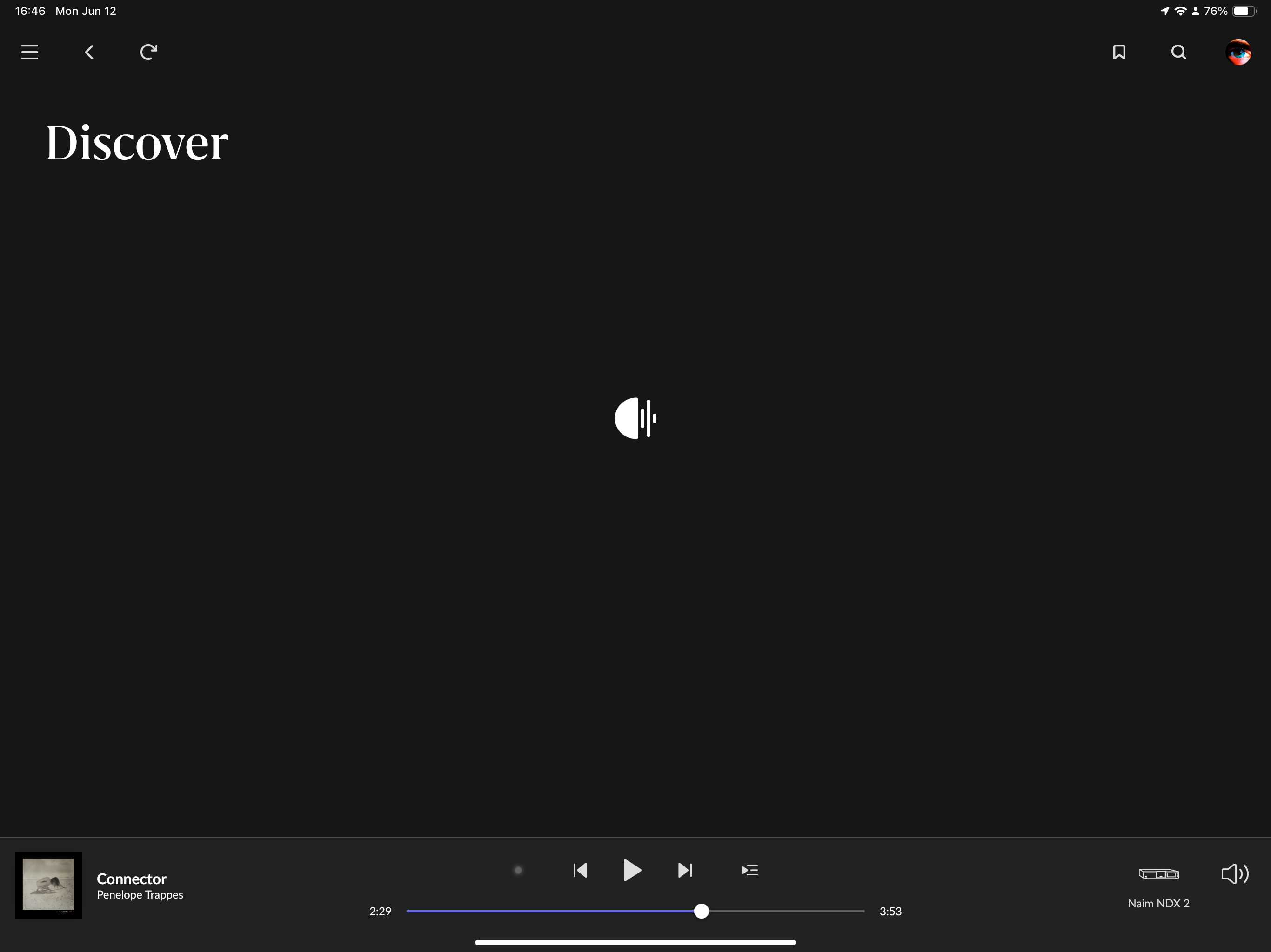

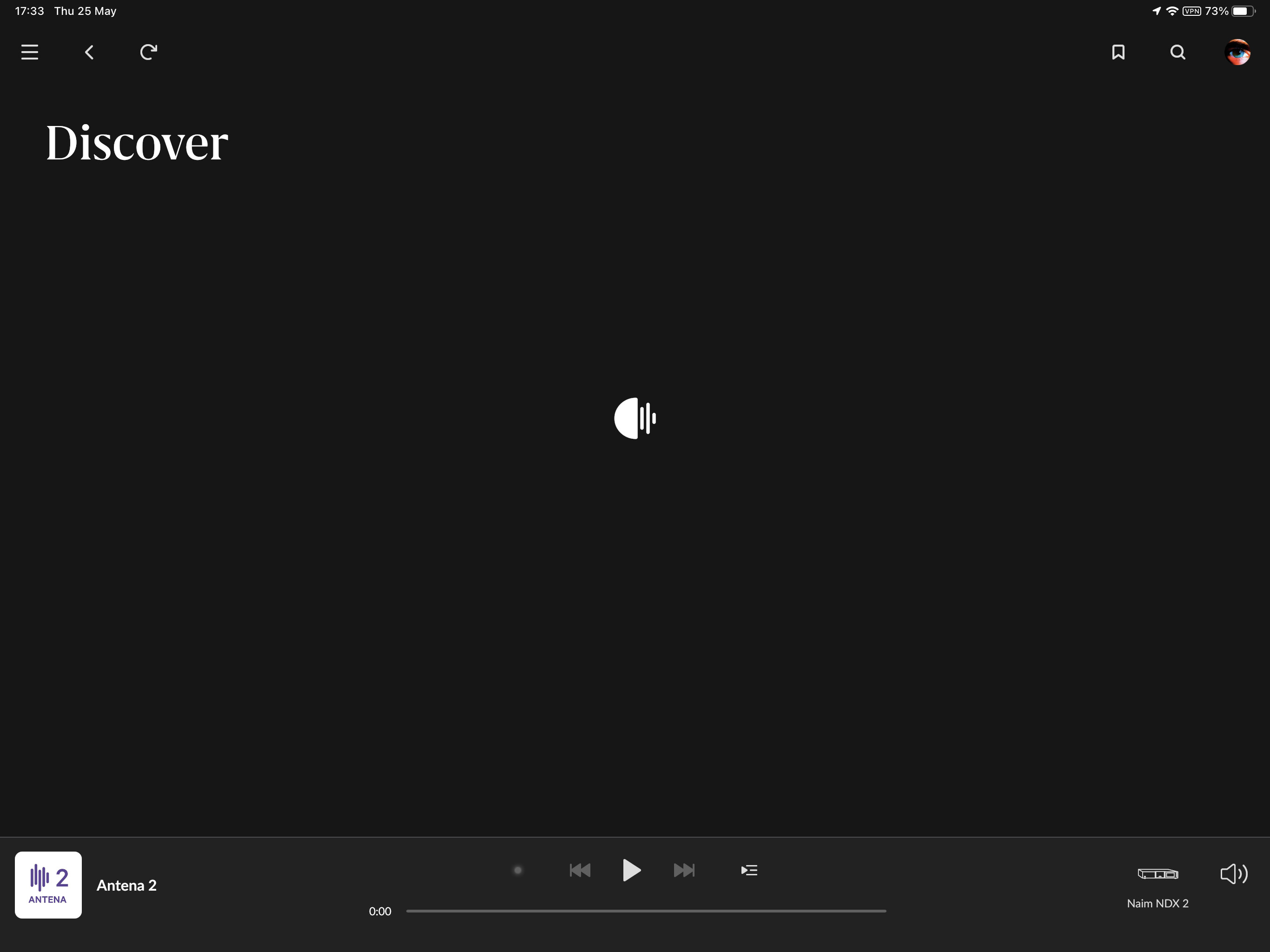

My issue is when I go in to the discover tab, nothing happens it stays in a loading stage indefinitely.

Unfortunately not, started fresh with Roon to see if it was a database problem, and it worked in the beginning, but after indexing 3000 to 3500 álbuns the discover issue came back and stopped to work again.
So I restored the backup again. Still present on early access build 1280.
Took a screenshot a few seconds ago.

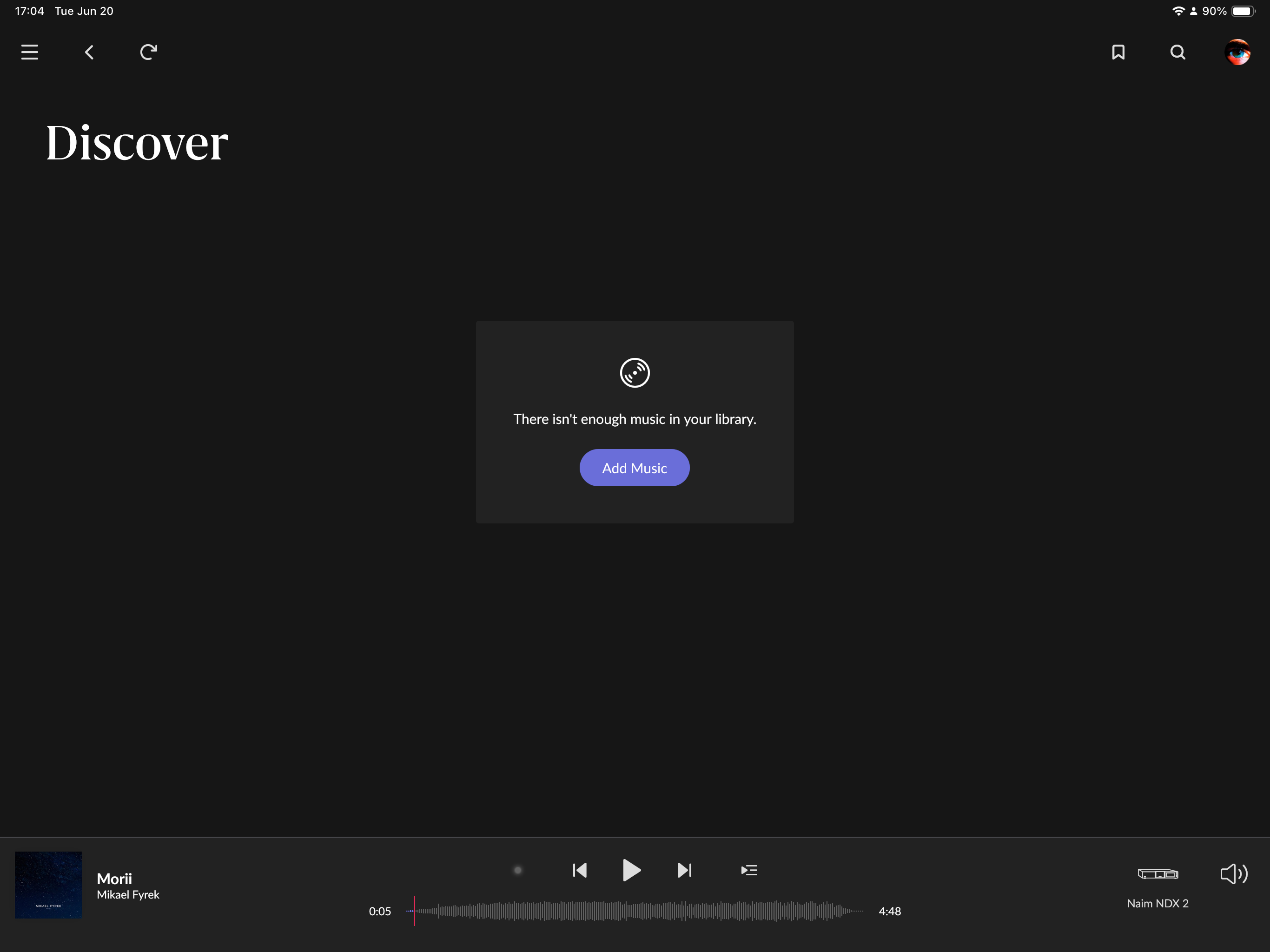

In addition to that, you can try to disable your local storage and check if the Discovery page is working.

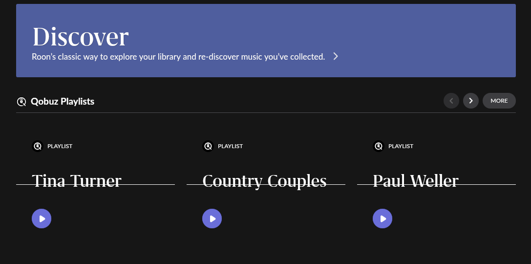

Disabling my library makes discover work, because I have not added álbuns from Qobuz or tidal the attached screen is presented, but appears to be ok.
It will be very difficult to identify what is the damaged track in my library, and I only came across this accidentally, but I will try to dig more into this.
