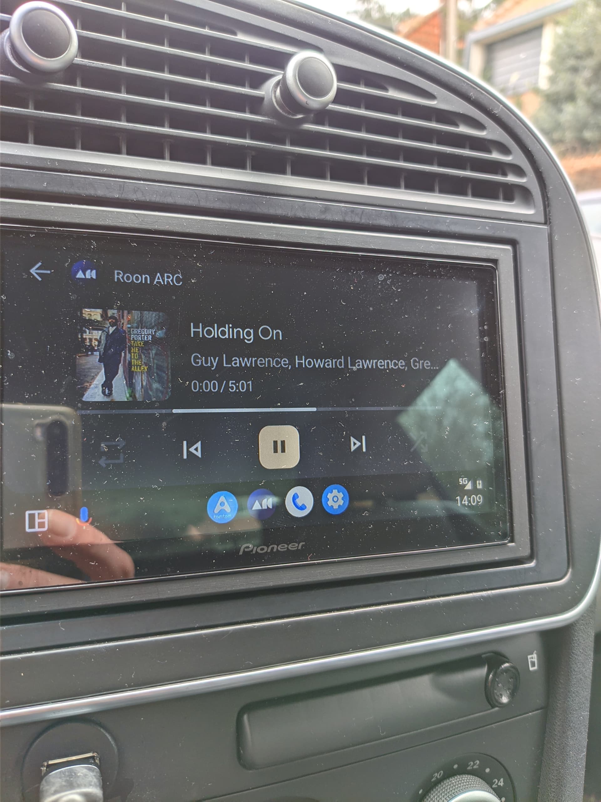

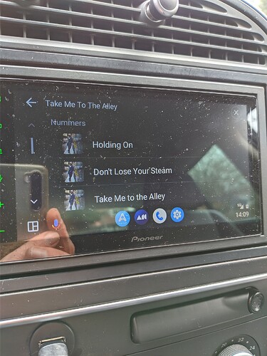

Hi @ivan,
Tested it today.
13:09 CEST. First connect with Arc not running on my phone. No items displayed at all.
Drove my car so no time to test.
14:09 CEST. Start test.
Can select an album. When selected to play the song is displayed but not loading/playing
Reconnecting doesn’t change anything.
When disconnected I opened Arc on my phone. It showed the selected track below in Now playing with the spinning wheel. Stopping and trying to restart didn’t play the track. Edit: I meant on Arc on my phone.
I had to close Arc completely and then I can restart the album and the first track starts playing on my phone.
Stopped the playback on my phone, reconnected the cable. Then I can also play the track on AA.
Hope this helps to identify the problem. Let me know if you have additional questions.
