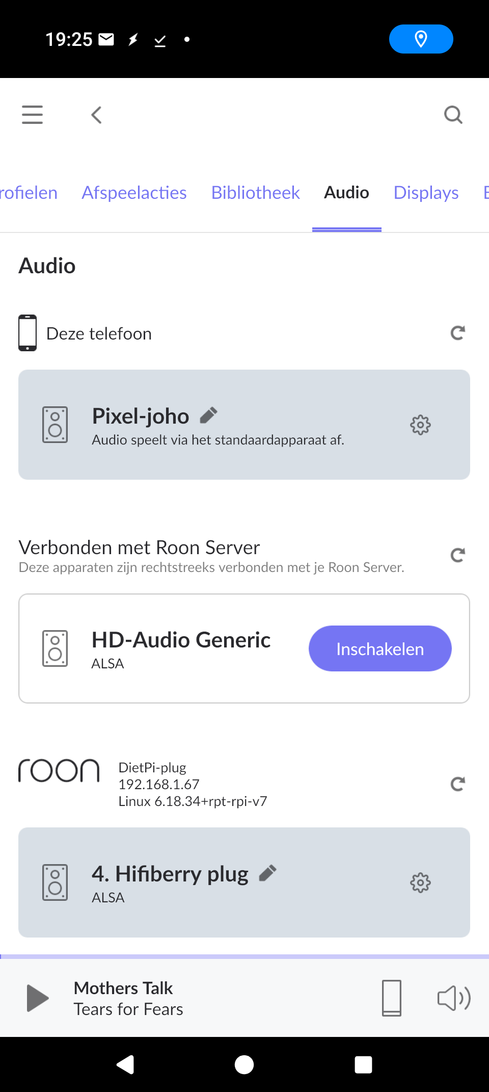

Hi @vova , after installing the earlyaccess version of today my local zone has magically returned!
Let’s us know over time whether issue returns, and we will try to look deeper.
I will do that. Thanks.
