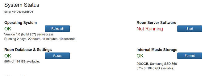

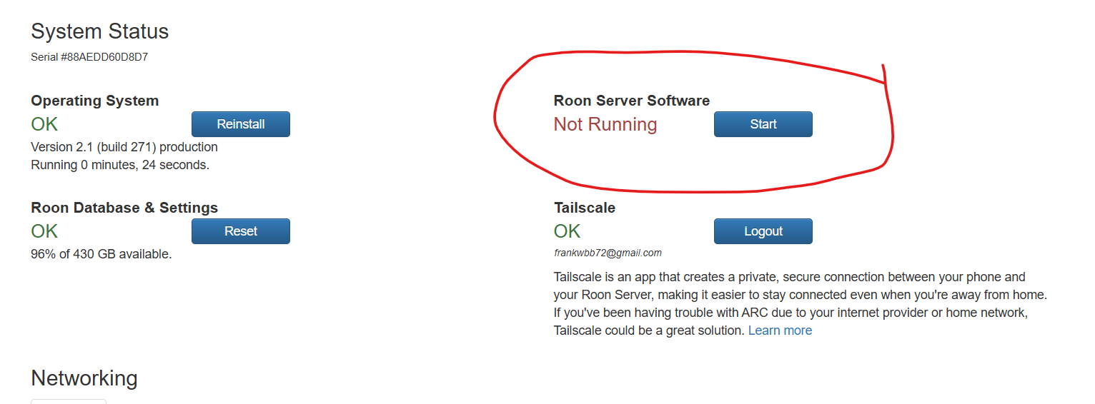

Inside RoonOS the Roon Server software is listed as not running but Roon is running correctly.

I have just updated ROCK on my NUC to 2.71, all went well but if you access the Roon console via Setup, find Roon core and then clicking on the ip address it shows Roon Server NOT RUNNING, however Roon runs just fine, not a problem as such but I though you might want to know?

After an automatic software update, I got the same, Nucleus One. My difference is I am also on EA RoonOS Version 3.0 (build 279). At first, Roon was working fine. But, about 20 minutes later, it wasn’t responding and the remote could not connect. I did a system reboot from this admin page, twice. Still same status and unresponsive Roon from a remote. I then did a hardware reset from the Nucleus One. Same status.
So, then I downloaded the BIN file, loaded it to the Reinstall folder and went through that process. Roon is working fine now and I can play, swap playlists and even endpoints from the remote. But the Admin page still shows Roon Server Software status as Not Running.
I’m just leaving it alone…music is more important than an incorrect status on the Admin page.
I had the same issue, went back to production which has exactly the same issue.
So dev has introduced a new bug which went straight to production release. Great work from the team :-1:

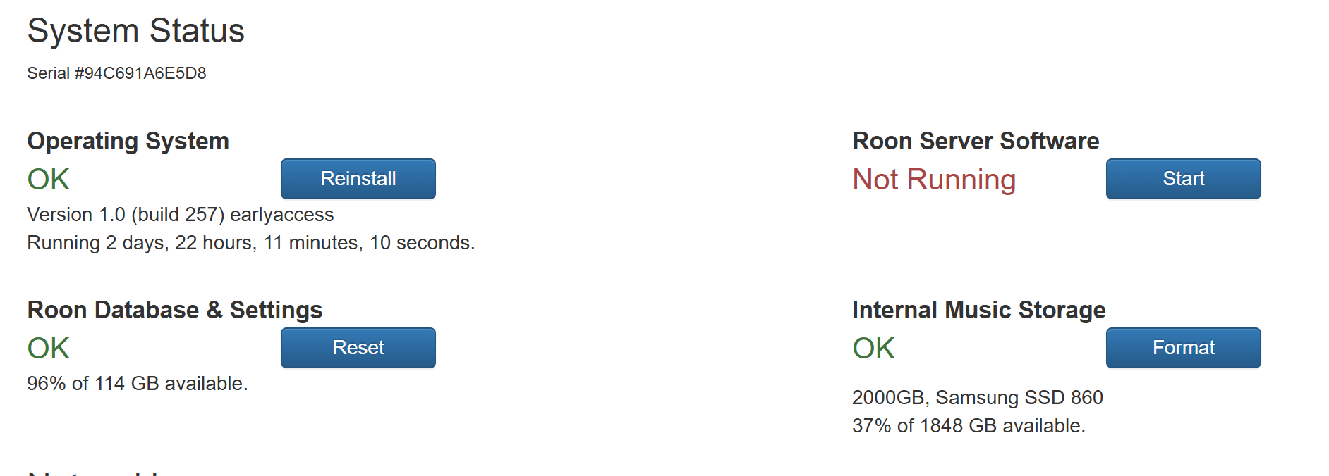

Rebooting does nothing. I have done a full wipe, installed from USB, updated to latest production, restored backup… exactly the same issue. Really bad practice to implement without testing first!

It’s likely an issue with Roon OS not allowing Roon Server to run. Likely a quick fix.
