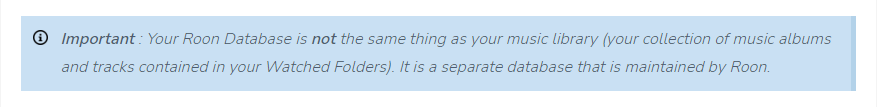

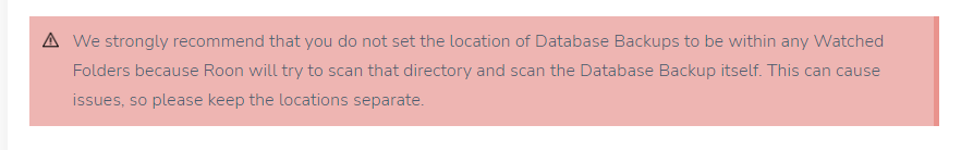

It is not a good idea to set your backup location to either the OS drive or the internal storage in the ROCK. As the internal storage is the “Watched” location.
See here for more details.
Also,
It’s best to use an external location (NAS, external USB drive, shared network drive/directory) to do database backups. As noted these locations should “NOT” be watched folders.
