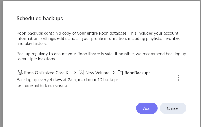

@David_Smith3, For clarification, can you post a screenshot showing your backup location? Similar to this… Thanks.

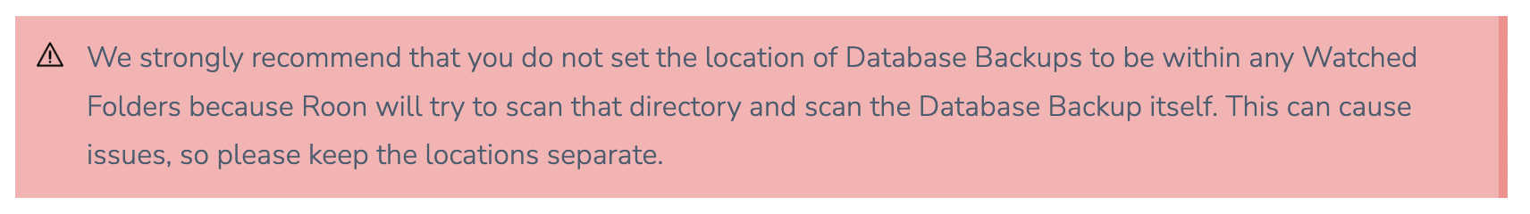

We’ve pulled backend diagnostics from your Nucleus, and there are errors attempting to mount the backup directory. Reinstalling RoonOS and renewing your database may solve this issue. However, as I understand it, there’s a distinct possibility you’re 1) storing your Roon library on the same drive you’re backing up to, and 2) have this location enabled as a Watched Folder. I believe this was the information @jamie was hoping to confirm when requesting a screenshot of Backup location above. If you are in fact backing up to a Watched Folder, see this warning from the article @Marin_Weigel and @Jim_F suggested on June 11:
