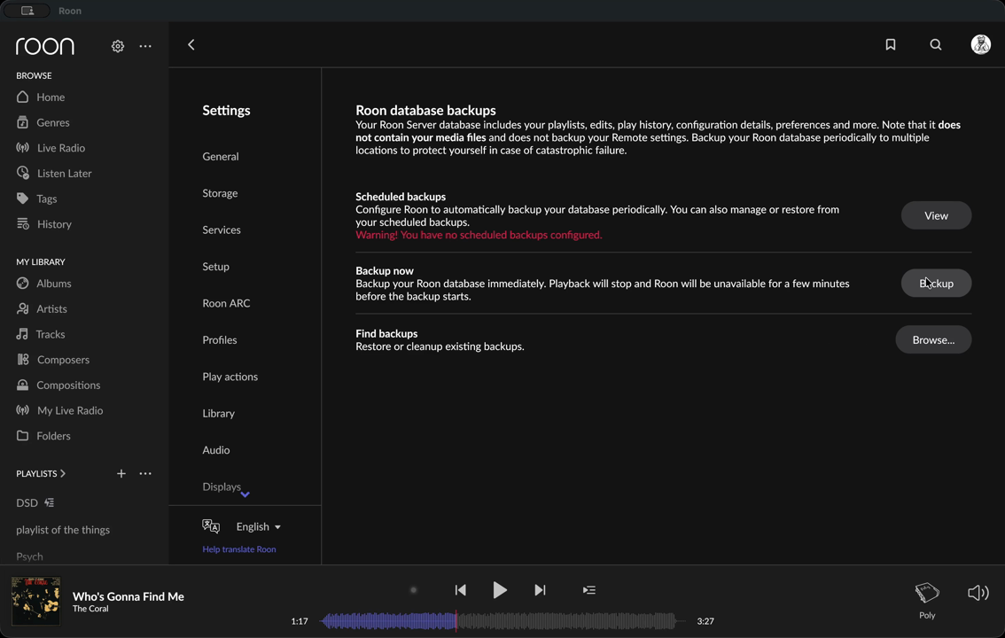

Here is a short animation:
bk

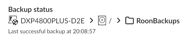

4. Started ROON container and backup works once again.
