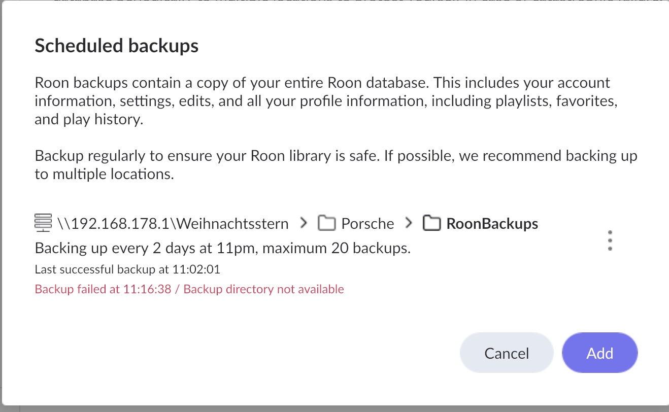

Roon is configured to make backups on the USB hard disk connected to the Fritzbox. A backup works exactly one time. A second backup at any later time (also immediately after the first one) fails. When the back up directory that Roon created during the first backup is deleted or renamed, then a new backup is possible.
This means that scheduled backups are not possible. Creating a new backup requires deleting or renaming by hand the previous one.

Seems, you‘re trying to direct Roon backups into a subfolder on the disk.
If so, try using the root directory instead and report back, please.

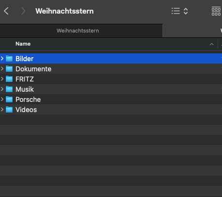

“Weihnachtsstern” is the name of the network. Then, the Fritzbox has these preinstalled folders. When mounting the USB drive, it appears as an additional folder (“Porsche”), like the preinstalled ones (please see the enclosed screenshot).
If I now change the roon backup destination directly to Weihnachststern, then Roon attempts to use for backup the built-in very limited storage of the Fritzbox instead of the USB drive.
