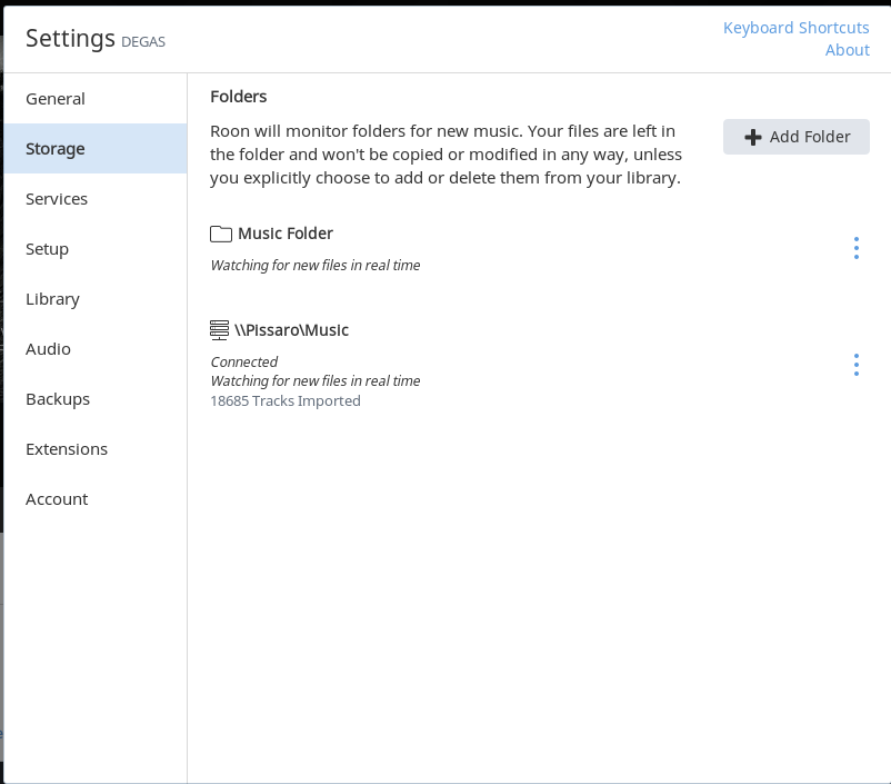

Well, I live in the Windows world, so we might do things differently from you folks over in Mac land, but in my world, I have a number of computers on the home network that may share one or more folders as a network share. So, for example, I have the following computers that at this moment happen to be visible on the network:
That means that if I want to add this network share to the Roon Core, I just add it using the “+ Add Network Share” screen and give the network address of the shared folder (\\Pissaro\Music in Windows-speak), plus the Windows credentials needed to access the folder. It then gets added as a network share:

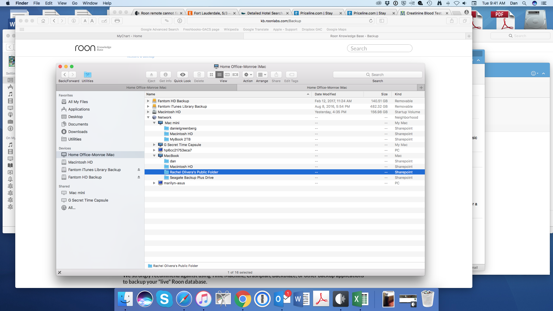

When I consult the link Daniel was kind enough to supply, I have the same problem. I really do not want to put in where the music is, but I believe rather where I want to send the backup to. You can see below that I have used Finder to find the network share specification which does not work.
Well maybe the lightbulb has not gone on yet, but I can only save the backups to the machine where Roon is installed and Dropbox. I cannot save it to the other drives on the network that have space (usb connection for the external drives on other network computers).
I am making an inquiry about how to find the address of the target drive on the network. The address (in Finder) when I connect to Server does not show as an suitable address acceptable to Roon There are a number of vnc addresses when I try to connect to server, but not clear on what my be applicable.
