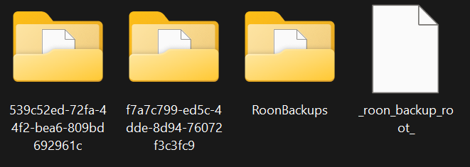

Can you please confirm with us whether backup structure in folder with backups looks like this:
having file “roonbackup_root_” is important, if you don’t have it - that will cause exactly the problem you face.

Thanks, I’ve checked and the roon_backup_root is there. I have three folders though:
Maybe that has something to do with the problem with the restoration of the backup?
While typing this I realized that it might have something to do with the structure of the folders. I copied the folder with the backups I wanted to restore to the RoonBackups folder, and now Roon recognizes the backups again! Restoring as we speak :smiley:
