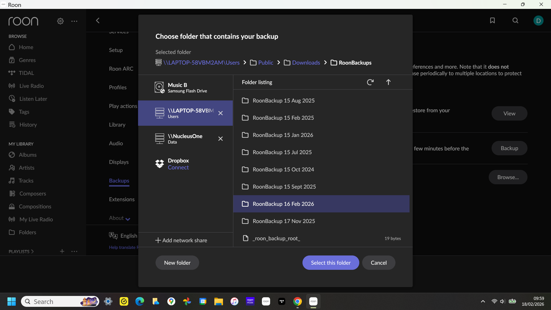

Trying to restore Roon backup on Nucleus One: copies of that currently held in both laptop folder and on USB stick. They were created from Innuos Zen Mini with same Roon build number.
Restore Backup from laptop-held folder will begin process but then screen just says "Processing" for hour after hour (longest has been 8 or 9 hours). Have tried several times now.
Restore Backup from USB stick plugged directly in to back of Nucleus One: can see the backup on the stick via Roon Interface, but when I try to begin the process, message comes up "no backups found". Despite having previously shown them on the screen.

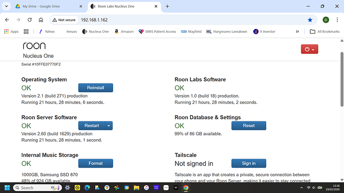

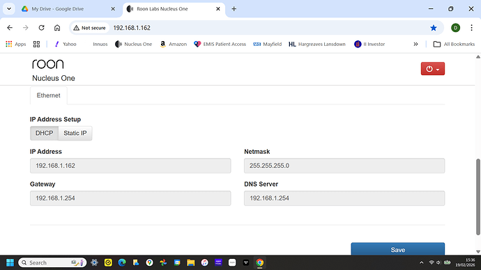

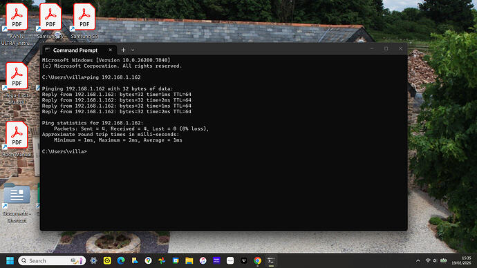

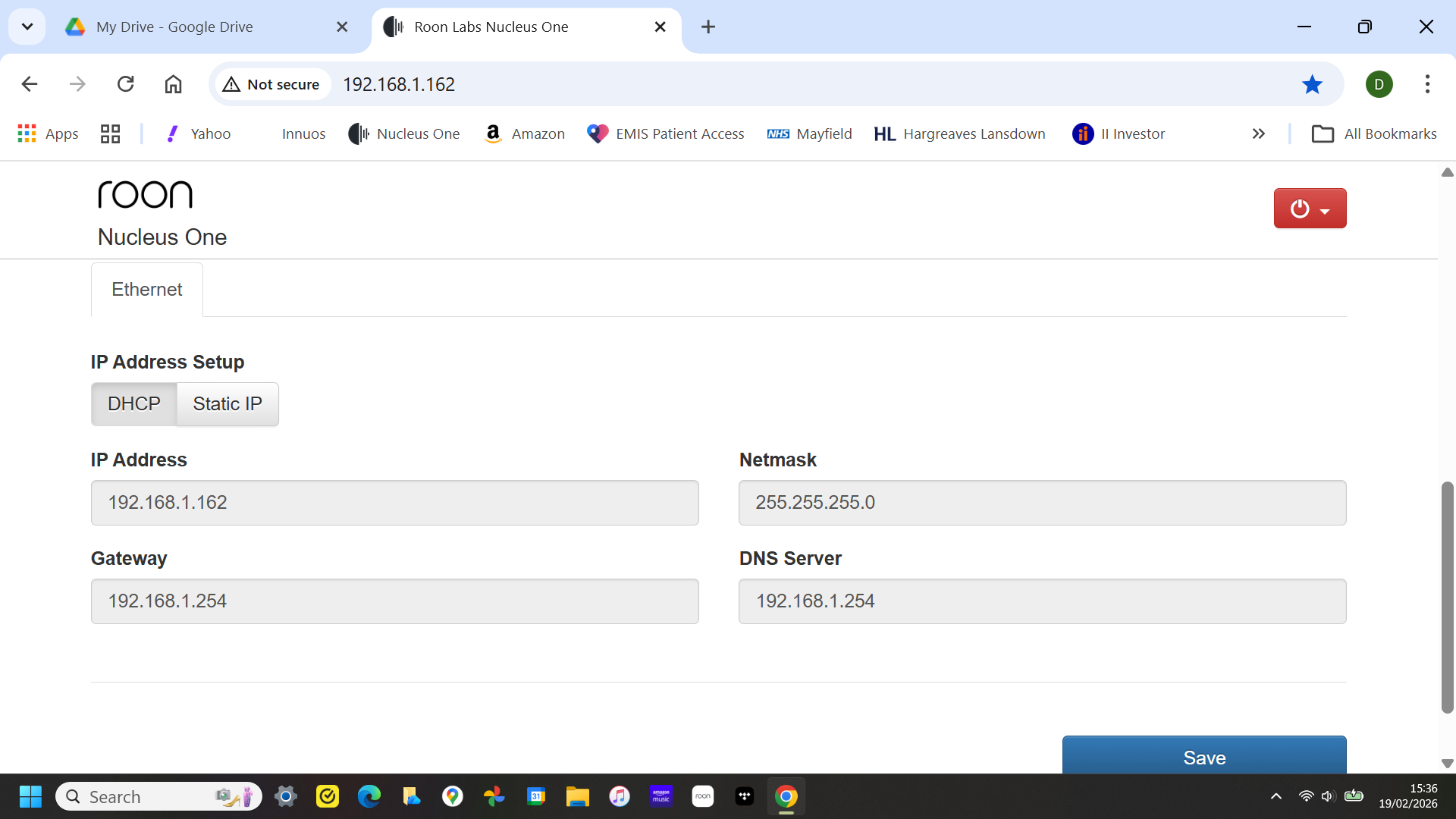

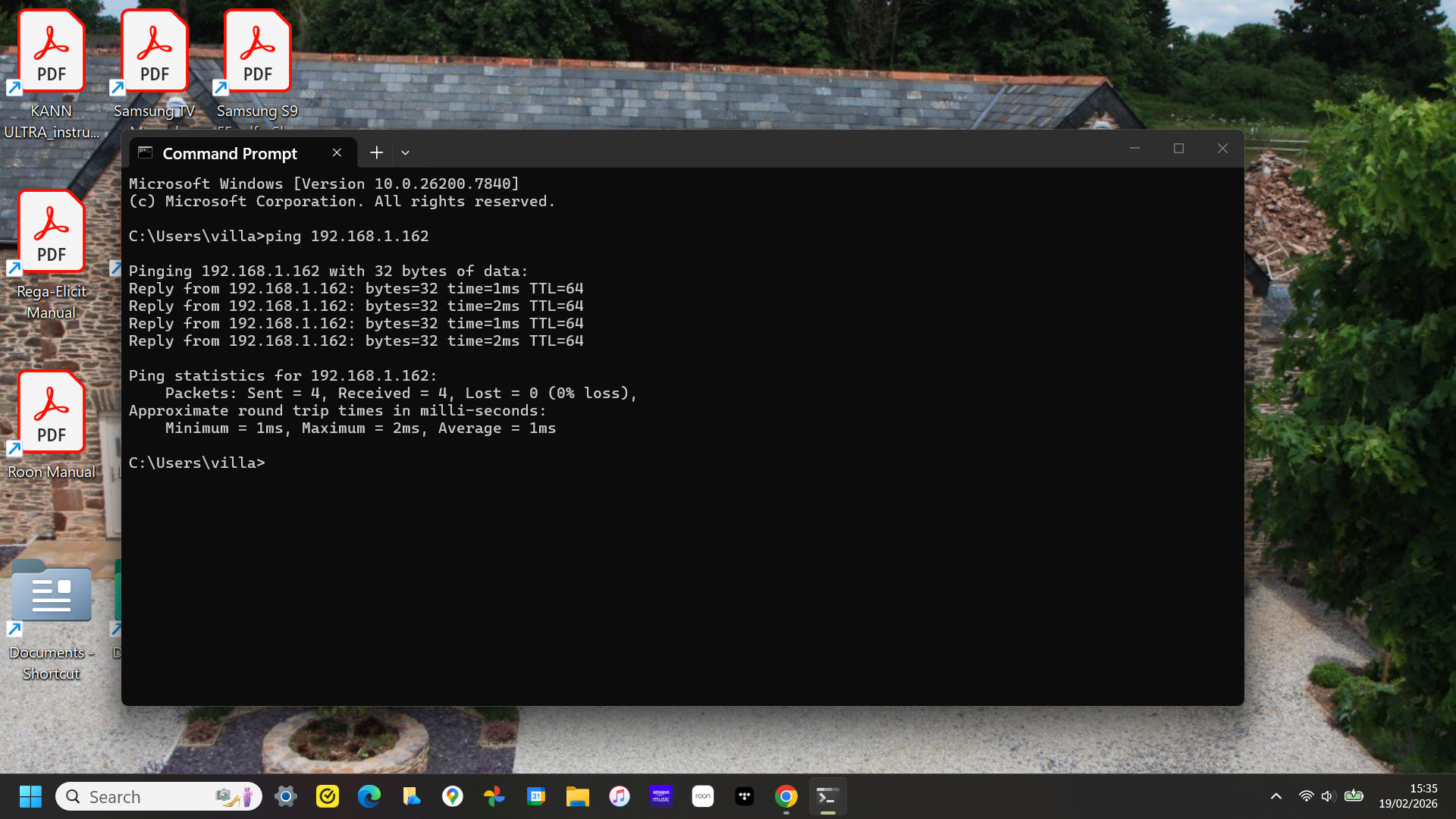

I’m not sure what you mean when you say that you can’t see the NucleusOne device registered against my name. Do you mean that it’s not showing on a Network or something? Since the first time I plugged it in, and despite having Network Discovery and Sharing activated on my laptop, I’ve never been able to see the device listed on my Network. BUT…it’s definitely there. See attached ping screenshot.
This was a secondary issue that I was going to ask about once the much more concerning Restore Backup issue had been addressed. As I say, it’s clearly ON my network as I can ping it, the Roon Remote shows it being present, etc etc. And yes, I’ve made sure everything is open to sharing / finding devices on my laptop, even to downloading additional Group Permissions Editor software for Windows 11 Home in order to enable SMB files.
So, also attached here a couple more screenshots showing the IP/gateway numbers and addresses.

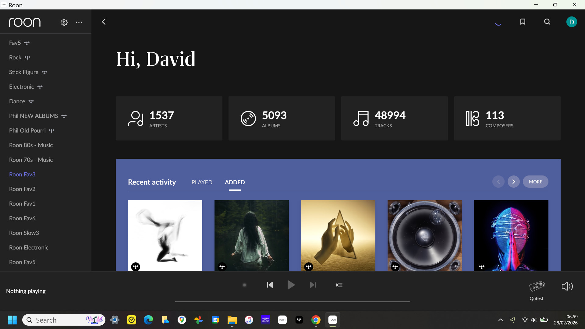

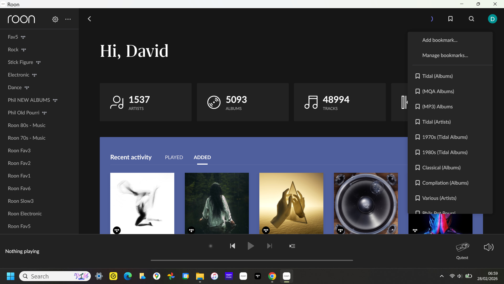

Obviously, what I’m first trying to do here is get the Roon Bookmarks and Playlists etc that I used to see when Roon Core was on the Innuous Zen Mini, to now also be visible when the core has been moved to the Nucleus One. The additional matter of getting a new backup after that to schedule and work from the Nucleus One is further down the road.

Morning Benjamin. I’m rather lost as to what your last message means. Or what you want me to do next. Or what solution there might be to all this. Just to repeat. I moved the Roon Core temporarily back to the Zen Mini and then uploaded the OS folders to your site. The Roon Core is now back on the Nucleus One again.
I’m assuming you plan to do some analysis of those Zen Mini sourced OS folders or something? Current situation: i still can’t see my Roon bookmarks and playlists when the Core is on the Nucleus One.

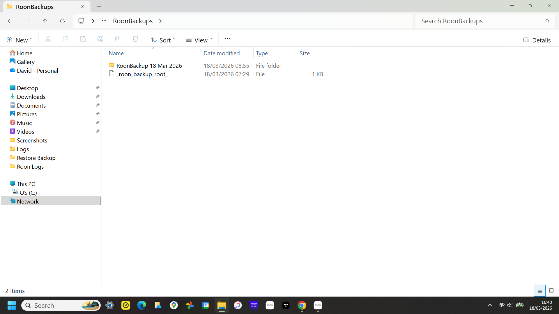

The reason you might not see the backup from the USB stick on your Nucleus is a missing “roonbackup_root_” file.
Here is how the backup structure should look:
If you do not have this file next to your backup folder, Roon Server will not recognize the backup.
This file is universal, meaning you can take one from any of your existing backups. If you did not place it on the USB stick before trying to restore it on your Nucleus, please try putting this file next to the backup folder and attempting the restore again

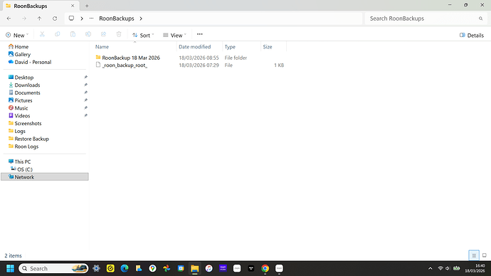

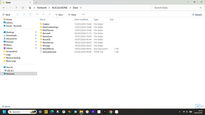

Morning Benjamin/Alex.

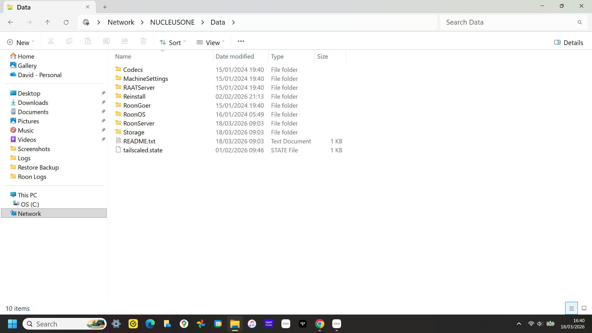

OK. Yesterday I created a new Roon backup on my Innuous Zen Mini. Then transferred Roon core over to new Nucleus One. Made sure that the root file was sitting in parallel with the latest backup folder as you suggested:
Was then able to drill down to the relevant latest backup folder on the Toshiba external USB plugged directly into back of Nucleus One, and set a backup restore going:

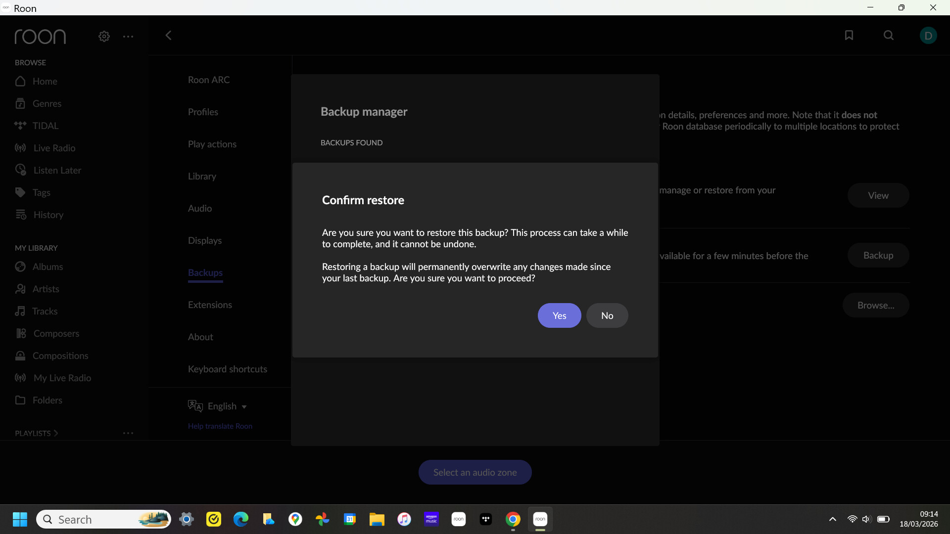

Backup restore confirmed; went to “Preparing” screen and then sat there for the next 8 hours achieving nothing [same behaviour as when many many weeks ago I first ever tried to restore a backup to Nucleus One from its storage folder on my laptop]. In the end, had to end the process: tried pressing “Cancel” and waiting but that achieved nothing, so had to restart the Roon Server on the Nucleus One. You can see that something appeared to be trying to happen from screenshot below, if that’s what the presence of a “readme” text file means:
Now… As I said before, I’ve got around 49000 tracks in my Library. In all the time I was using Roon Core on the Innuos Zen Mini I never had to restore a backup, so I’ve got no idea how long it’s supposed to take. But surely not that long and still achieving no result?
I’m at a total loss. What am I doing wrong? Is it supposed to take forever to restore a backup? Is something just not working properly?

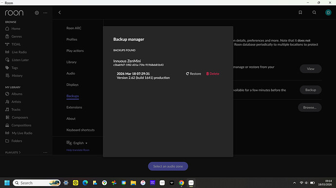

Grasping at straws: does it matter that I renamed the backup folder from the unwieldly string of numbers and letters to something date recognizable (i.e. Roon Backup 18 Mar 2026)? Does that cause a “mismatch” with the root file’s metadata?
Any thoughts would be much appreciated. I’ve followed the on screen instructions to the letter; I can get to the screen that says “preparing” but nothing seems to ever happen.
Best. Dave
Hey @David_Carter,
Thanks so much for the reply and including screenshots!
In your first image, I can see the folder renamed to “Roon Backup 18 Mar 2026”. While it makes sense to us humans, Roon uses a UUID (Universally Unique Identifier)—that long string of letters and numbers—to link the metadata in the roon_backup_root file to the actual data chunks inside the folder.
Even though Roon “sees” the backup (as shown in your second image), it’s likely hanging at “Preparing” because it’s looking for a folder named c5bab9d7-1f82-d31a-75fe-91968eb81b43 (the ID shown in your screenshot) and can’t find it to begin the extraction.
See if this helps:
Connect the USB drive to your computer.
  • Rename the folder "Roon Backup 18 Mar 2026" back to exactly: c5bab9d7-1f82-d31a-75fe-91968eb81b43
  • Make sure there are no trailing spaces.
  • Plug it back into the Nucleus and try the restore again.
With that, you mentioned using a Toshiba USB drive.
  • Nucleus One runs a Linux-based OS (RoonOS). It works best with exFAT or EXT4 formatted drives.
  • If that drive is formatted as NTFS (common for Windows), the Nucleus can sometimes struggle with "write" or "deep read" permissions during a heavy restore, leading to that "Preparing" hang.
  • Note: If you can see the backup in Roon, the drive is at least readable, but exFAT is the safest bet for cross-platform compatibility here.
