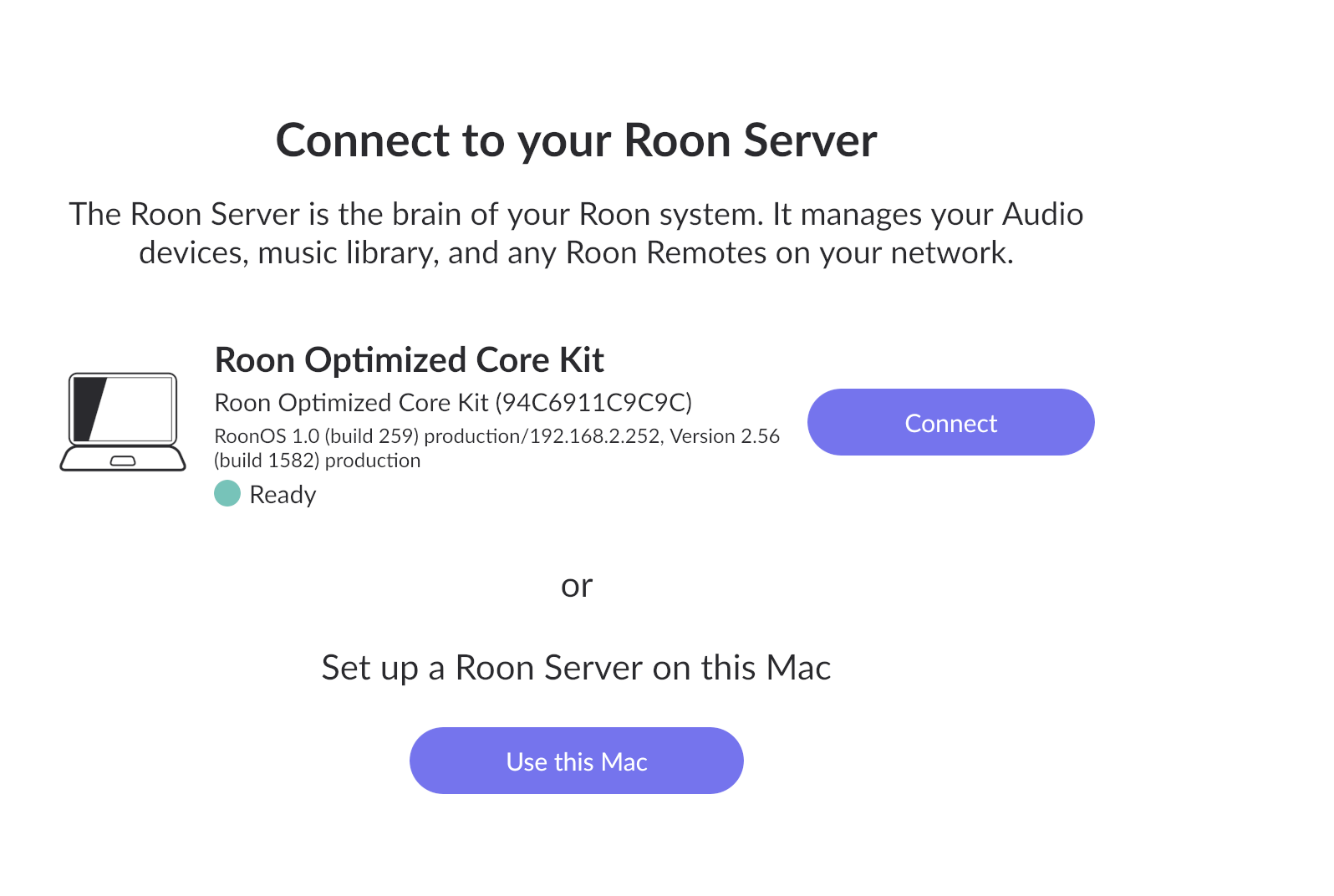

I'm lost my roon server and want to connect again and place a backup on the system Roon Rock. I connect to server and then i have to log on. Go to safari, click on account and than it returns to my roon on my mac. But it is not logged in. When i select to restore a backup, the systems says: restore failed. Please check your backup folder and try again. It was on my Synology NAS, i replaced it to a hard drive directly on my nuc. Both do not work.
wired network. no issues with connection

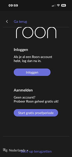

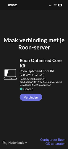

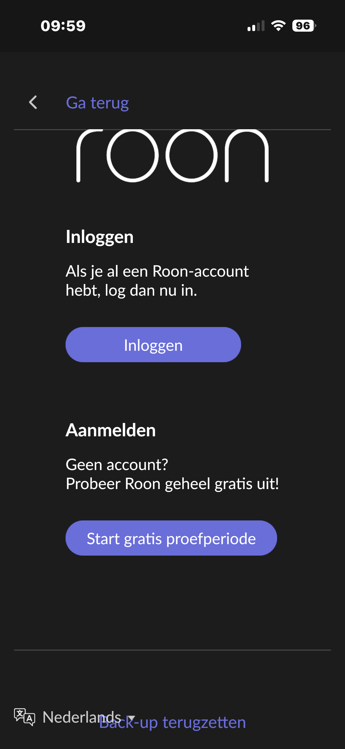

When i go to my Roon App on my mobile apple device, the same happens. Can not log on to the system but everything just look fine. When i click on log on, it goes to the account.roon.app and i find my credentials, click on them and it returns to my roon app on my device but it’s not logged in (same screen as before).
