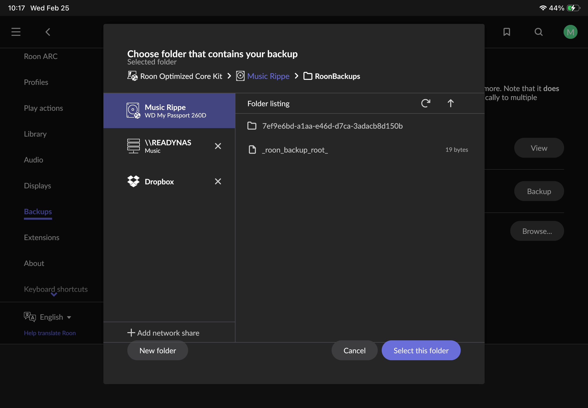

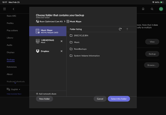

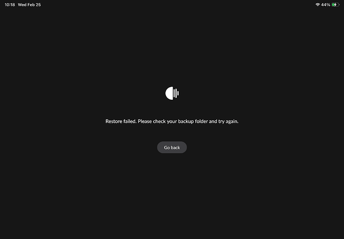

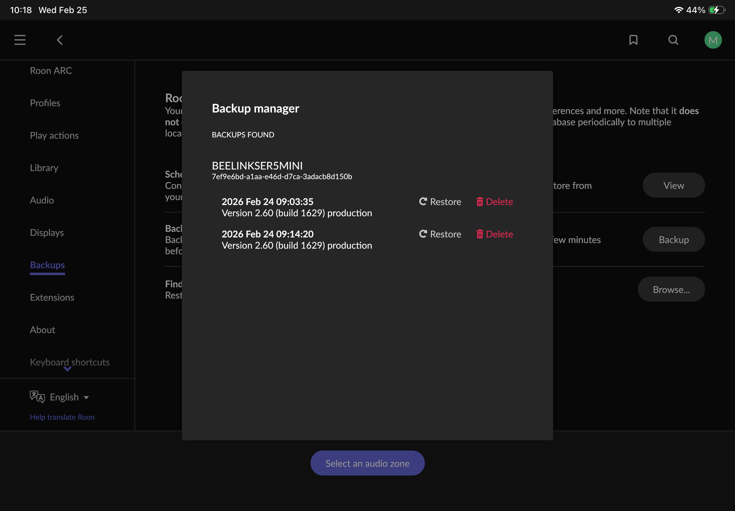

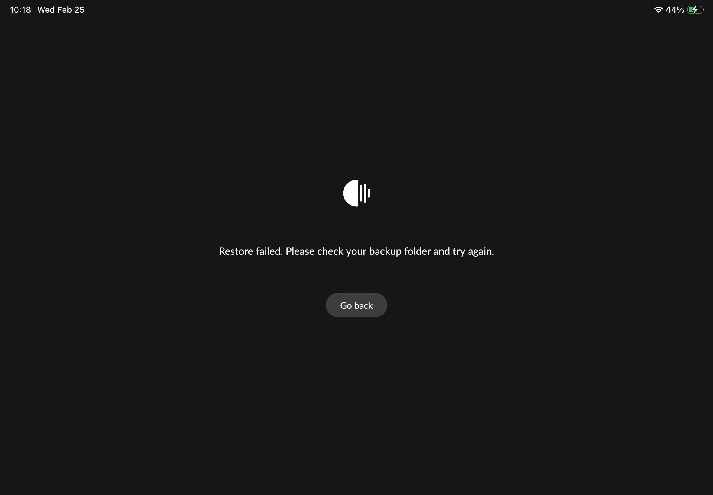

The snippet you provided appears to not be related to my data. I don’t own any Robert cray and my back up was performed 02/24 not 02/20. Here are screenshots from attempts on 02/25 10:17 am cst
• Fresh ROCK install on Beelink SER3
• Created new backup 02/24 via Google Drive from old Windows Roon.
• Downloaded RoonBackups folder from Drive (zipped → unzipped once).
• Copied full RoonBackups (with timestamped subfolders + roon_backup_root file) to root of exFAT USB.
• Plugged USB into Beelink, browsed via Roon app: Settings > Backups > Find Backups > Browse > selected RoonBackups parent folder.
• Backup detects (lists dates), but restore fails every time at ~8% progress—no detailed error, just “Restore failed” or stalls.

Please also share a screenshot of the actual Backups folder in a file viewer. RoonOS logs show errors related to nested Backups when attempting to access the location while creating new Backups.
