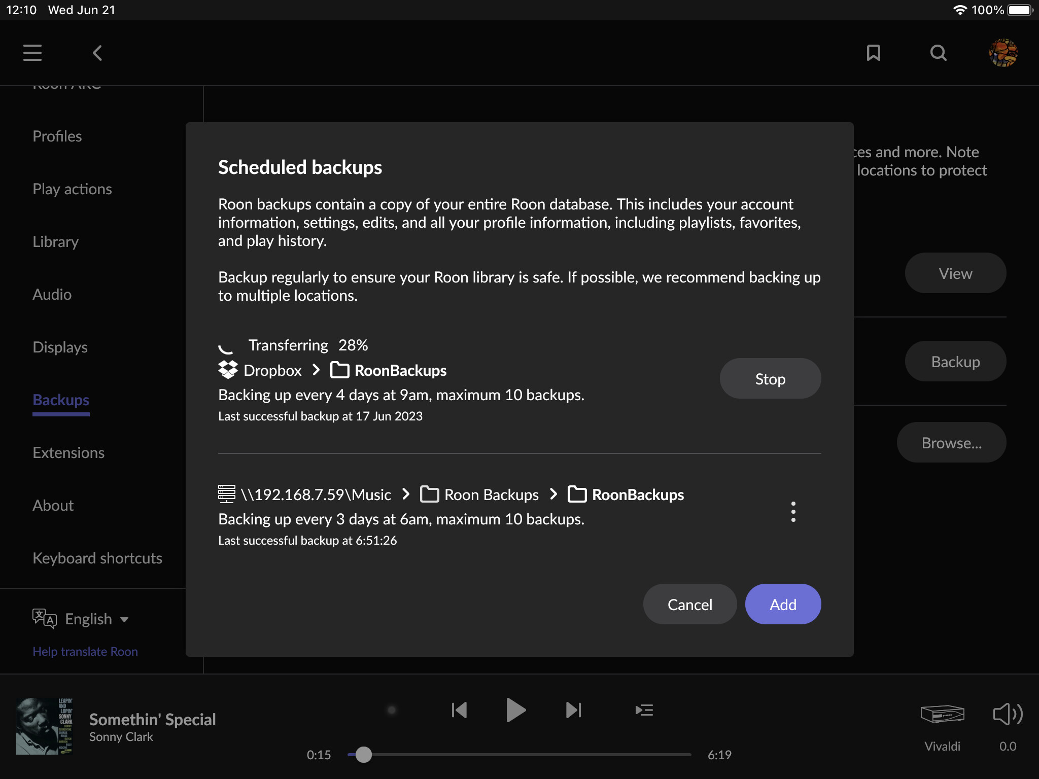

Earlier this morning the scheduled backup to the local Mac SSD ran successfully. It’s scheduled every 3 days. The Dropbox backup (every 4 days) should run tomorrow morning I believe. I’ll let you know how that one goes. In the past, it’s the Dropbox backup that occasionally fails, although I don’t understand why the snapshotting process would be any different. Back on Thursday 6/8, after the Dropbox failure, I tried forcing backups 4 time - twice to Dropbox and twice to the Mac. All 4 attempts failed during the snapshotting phase, leading me to believe something was indeed wrong. In any case I’ll give you an update tomorrow.

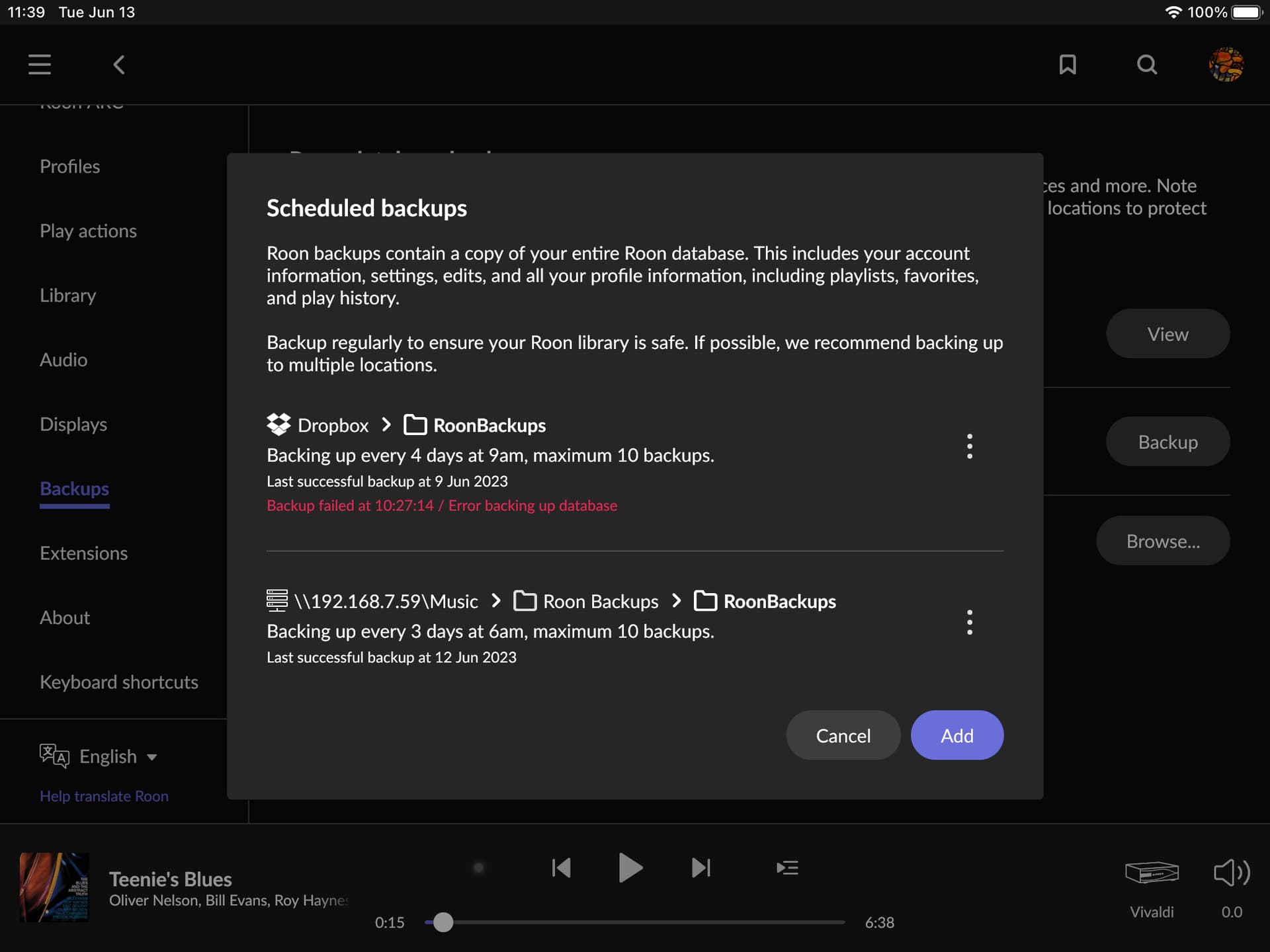

Hi Benjamin,

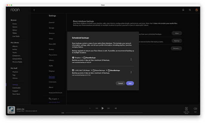

The backup to Dropbox failed again this morning. See attached screenshot. Let me know what next. Thanks.
Chuck
Hey @Charles_Craiglow,
Thanks for the update! When reviewing your core diagnostic, the only error trace I’m seeing in relation to the falling back up is:
06/13 22:38:36 Info: [broker/dropbox] no account configured
There seems to be a hiccup or miscommunication between Roon and your Dropbox account. Perhaps a password reset followed by a re-sync of your Roon and Dropbox account may help in this case? If you try to manually back up to your Dropbox account, does the same issue occur?

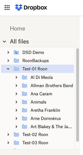

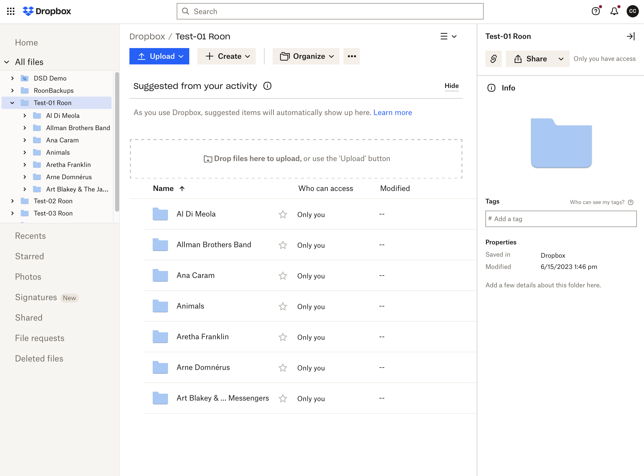

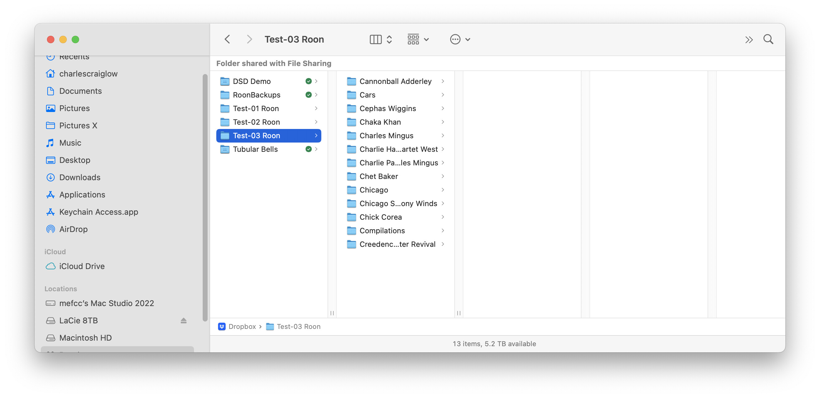

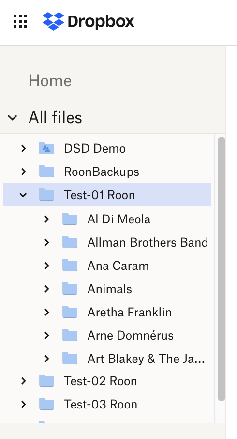

  5. The Mac Studio is connected directly (though by a much longer cable run) to same ethernet switch as the Nucleus+. To check communication between the local network and Dropbox, I created 3 large test folders on the Mac Studio – Test-01 Roon, Test-02 Roon, and Test-03 Roon (31 GB, 33 GB, 48 GB respectively). I then uploaded all three folders (sequentially) to my on-line Dropbox account. During much of that time, Roon was also streaming internet radio to the Mac, or Tidal and Qobuz files to the audio system, without any problems. All 3 folders were transferred to Dropbox without issues or interruptions of any kind. (See screenshots.) Though not definitive, I tend to feel this demonstrates there is no communication issue between the local network and Dropbox. Whatever problem there may be would seem to be specific to Roon and/or the Nucleus+.

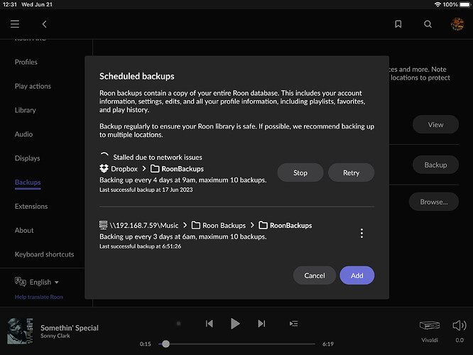

Hi Benjamin,
Update…
Yesterday (6/21) Roon attempted to run both scheduled backups.
The backup to the local Mac SSD ran successfully (as usual).

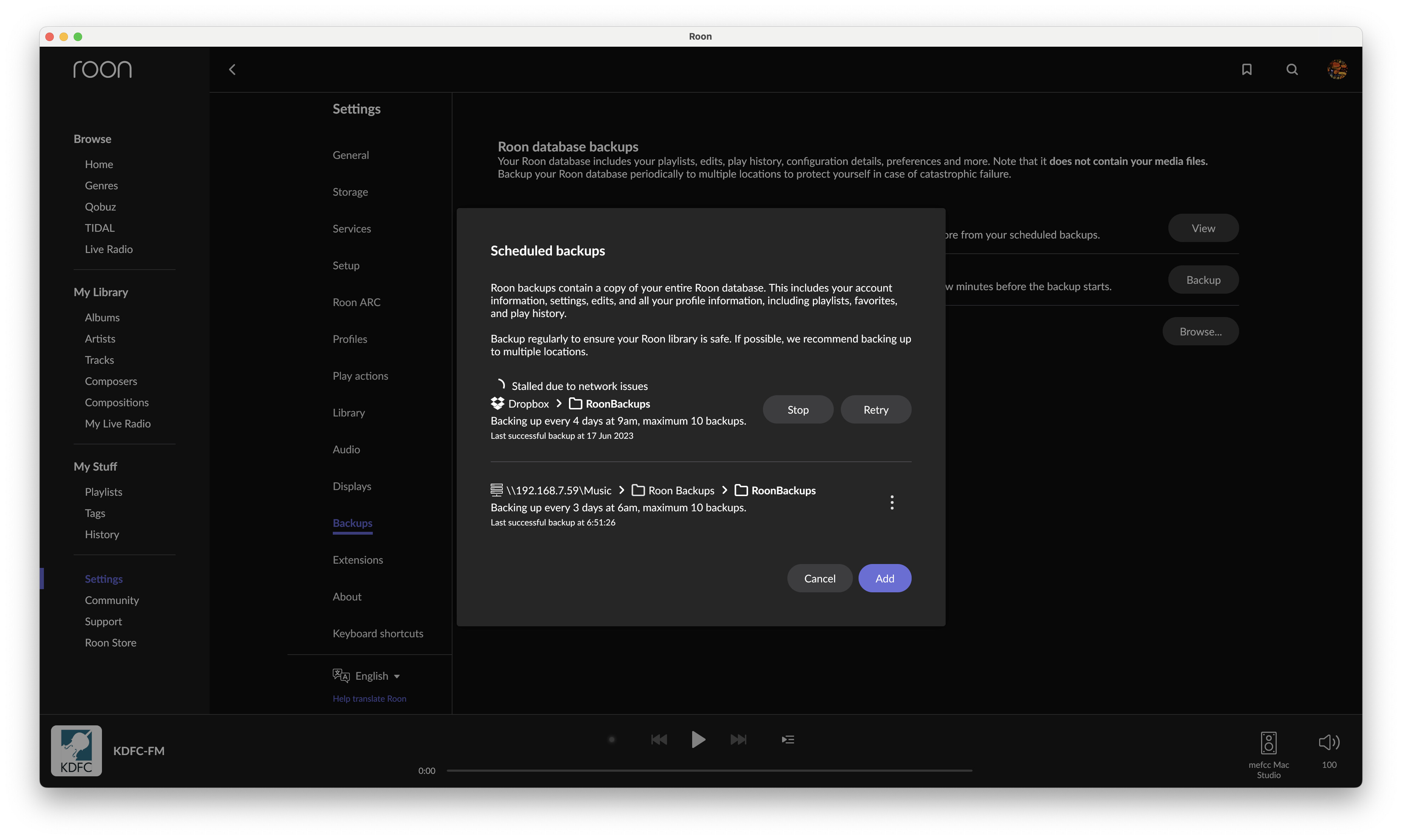

The Dropbox backup ran from 9:00am until almost 6:30pm, and only completed “successfully” because I was keeping and eye on it and hit the “Retry” button every time the process “Stalled due to network issues.” That stall/retry thing happened at least four times. I’ve attached screenshots depicting a couple examples. When it runs properly, the remote backup to Dropbox runs in a bit less than 3 hours.

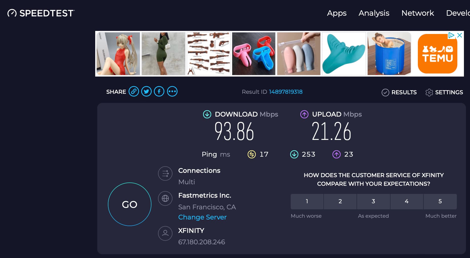

I’ve also attached a screenshot of Speedtest showing the upload/download speeds at the Mac in midafternoon. These speeds are typical and quite consistent.
I can’t prove it to you absolutely, but I’m pretty certain there are no connectivity problems with the local network that would prevent Roon from accessing the Dropbox account. I can upload and download data to Dropbox all day long with zero issues. I have a third-party backup service that runs continuously on both Macs in the household, and it has not had even one connectivity problem in the several years we’ve been using it. The iPad backs up wirelessly every night over the same eero router and Comcast cable modem – and never a problem. None of the other connected devices in the house – and there are many by now – has ever experienced a network connectivity problem.
So, I think the problem lies in Roon hardware or software.
I talked to my Roon dealer about this issue earlier this morning. He told me that the Dropbox backup was so unreliable that he stopped using it on his store network. He was experiencing a failure rate of about 1 in 5 backups. According to some of his contacts inside Roon, Dropbox connectivity is a known problem inside the company and it just is what it is. Which is disappointing.
In any case, I’m not sure it’s worth either of times to keep chasing this issue. I’ll either disable the Dropbox backup altogether, or just leave it on and let it fail whenever it gets stuck.
If a larger issue arises (e.g., if local backups begin to fail), I’ll open a new problem ticket.
Regards,
Chuck
