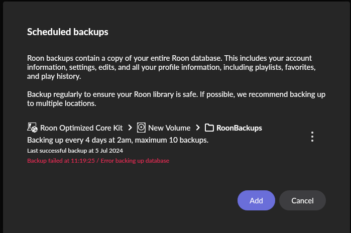

My last successful Backup was made on July 5th. Since then all backups (both scheduled and manual) are failing. The backups are set to be made to a USB SSD attached to my ROCK/NUC system. This drive is 120GB with 62GB used (so plenty of free space for additional backups). The drive is accessible by Roon OS and via Windows File Explorer over the network. Is there a problem with the Roon Database itself that is causing backups to fail?

Just a follow-up here; I got fed up of making manual backups and I think I’ve now got back to a working system.
I reset the database and reimported everything. Once that was complete, I restored the last good backup (from July 5th). That seems to have fixed whatever it was, because Backups are now working again.
Obviously there was a small amount of work to be redone for edits made since July on newly imported albums, but I can live with that.
