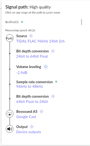

2026-05-21 at 15.12.50 - First track in playlist playing

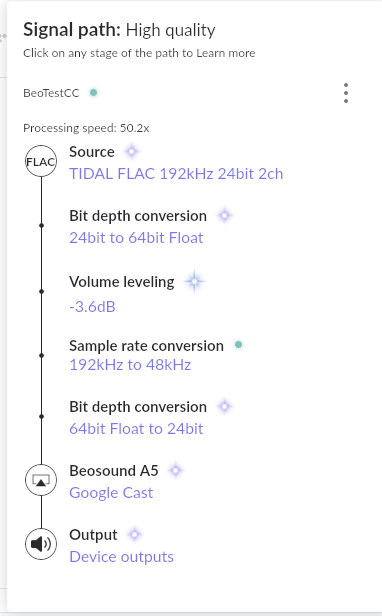

2026-05-21 at 15.15.04 - First track not advancing to next track

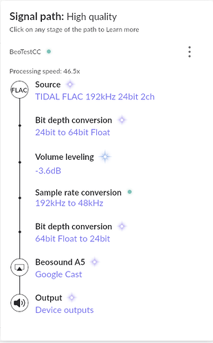

2026-05-21 at 15.17.25 - Manually skipped to next track,

Here is the signal path
First track
Track not advancing
Next track after manual advance
