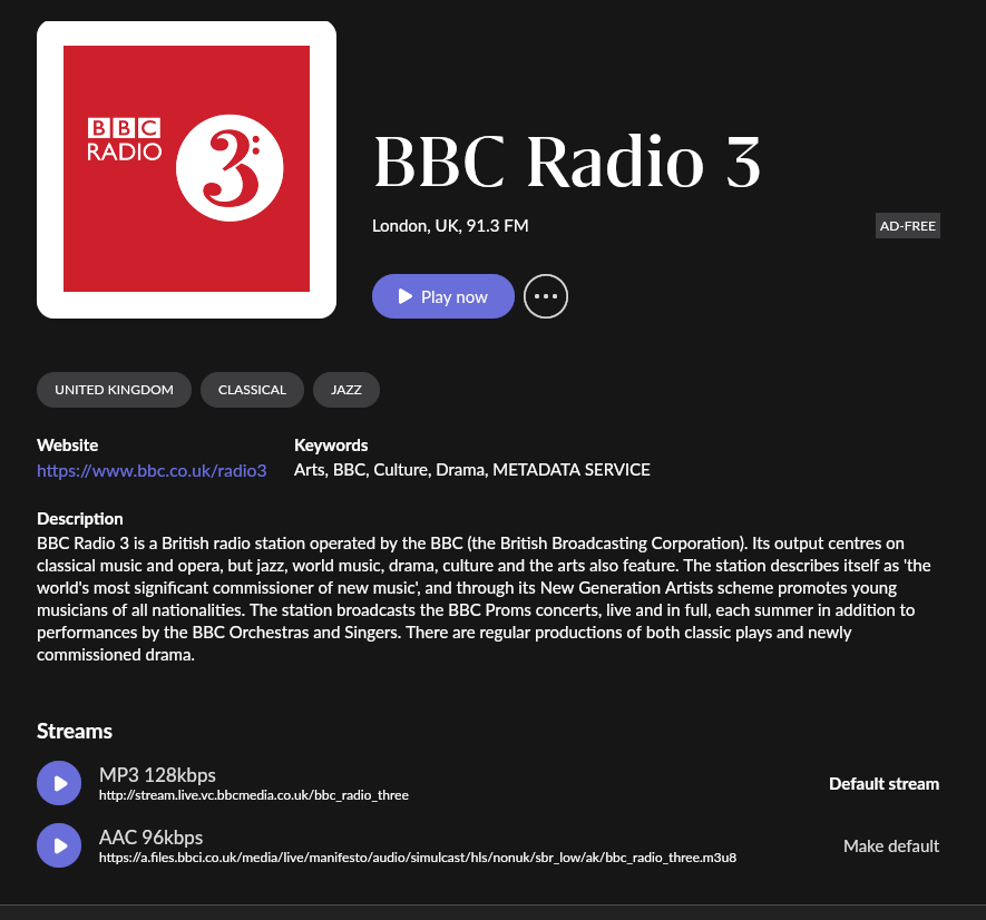

Many BBC radio stations stop playing after a few seconds in Roon. On any of my endpoints.
The stations play fine in my browser - using the same URL used by Roon.
All other streaming radio station that I’ve tried - work without issue. It’s just BBC Radio that’s doing this. Mostly BBC 3 and BBC 4 that I’ve tried.

I see that they have several steam options have you tried them all?

Yup, also tried the lower bitrate streams for BBC R 3
