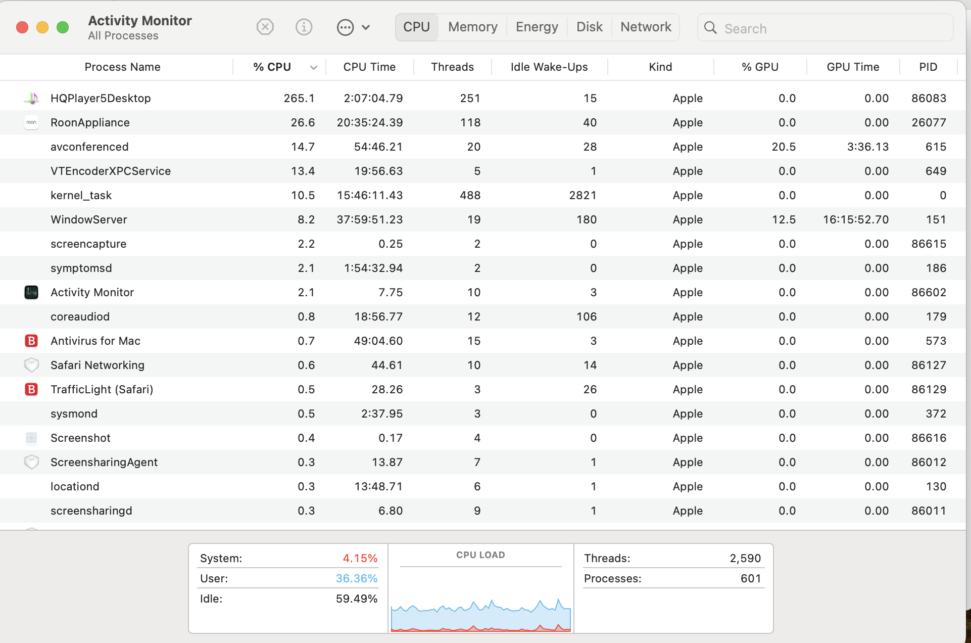

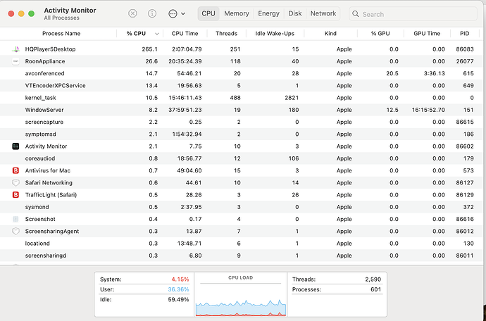

I’m no longer using a Mac mini M2 Pro. Now using an M1 16gb. It seems to be able to handle DSD256 with ASDMSEC-light and DAC correction.
I don’t understand the 265.1%, but the overall CPU usage seems to be a modest 40%.

This means “worth 2.65 cores”. IOW, having one core worth fully loaded is 100%, having two cores worth fully loaded is 200% and so on. This is standard Unix “top” way of reporting loads. So one single-threaded process could use at most 100%. You also get 100% load if two cores are loaded to 50%. Or 200% if four cores are loaded to 50%. So 8-core CPU has theoretical maximum load of 800%.

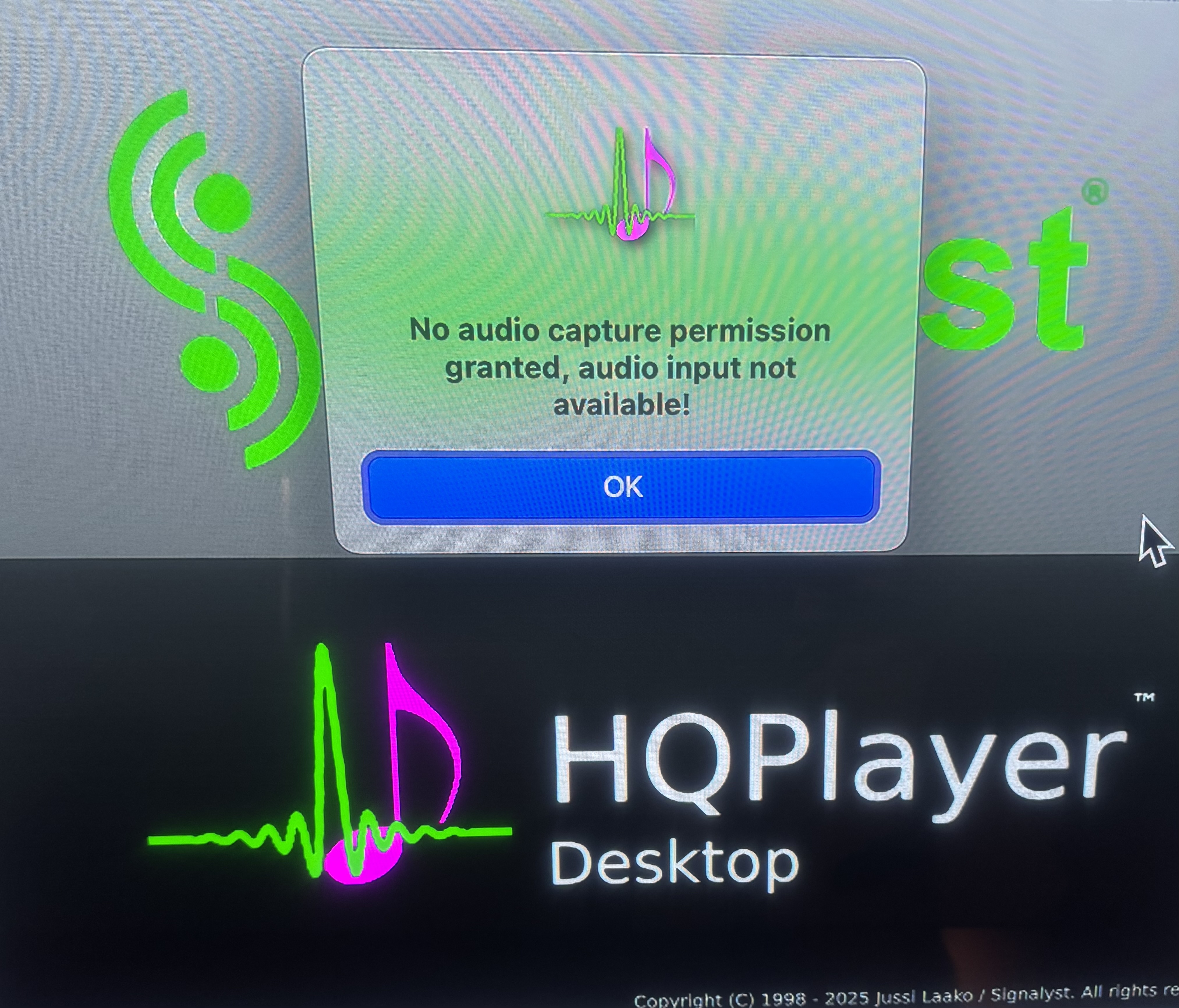

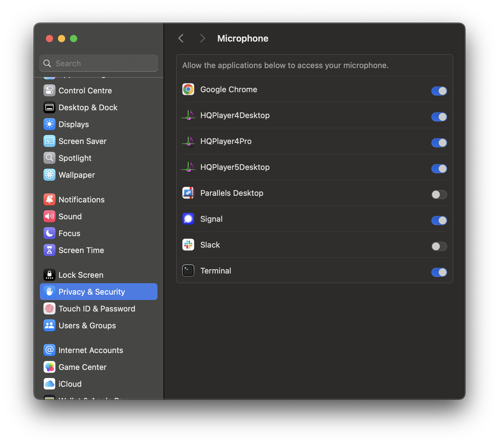

But I have a problem. Every time I’m launching your HDPlayer, there is an inscription on my screen.
When I press OK, next everything works.
I think, I’ve given every possible permissions in settings.
What I have to do to rid of this problem?

This is the one missing:
Microphone = any audio input, not very logical, but it is the same on Windows too…

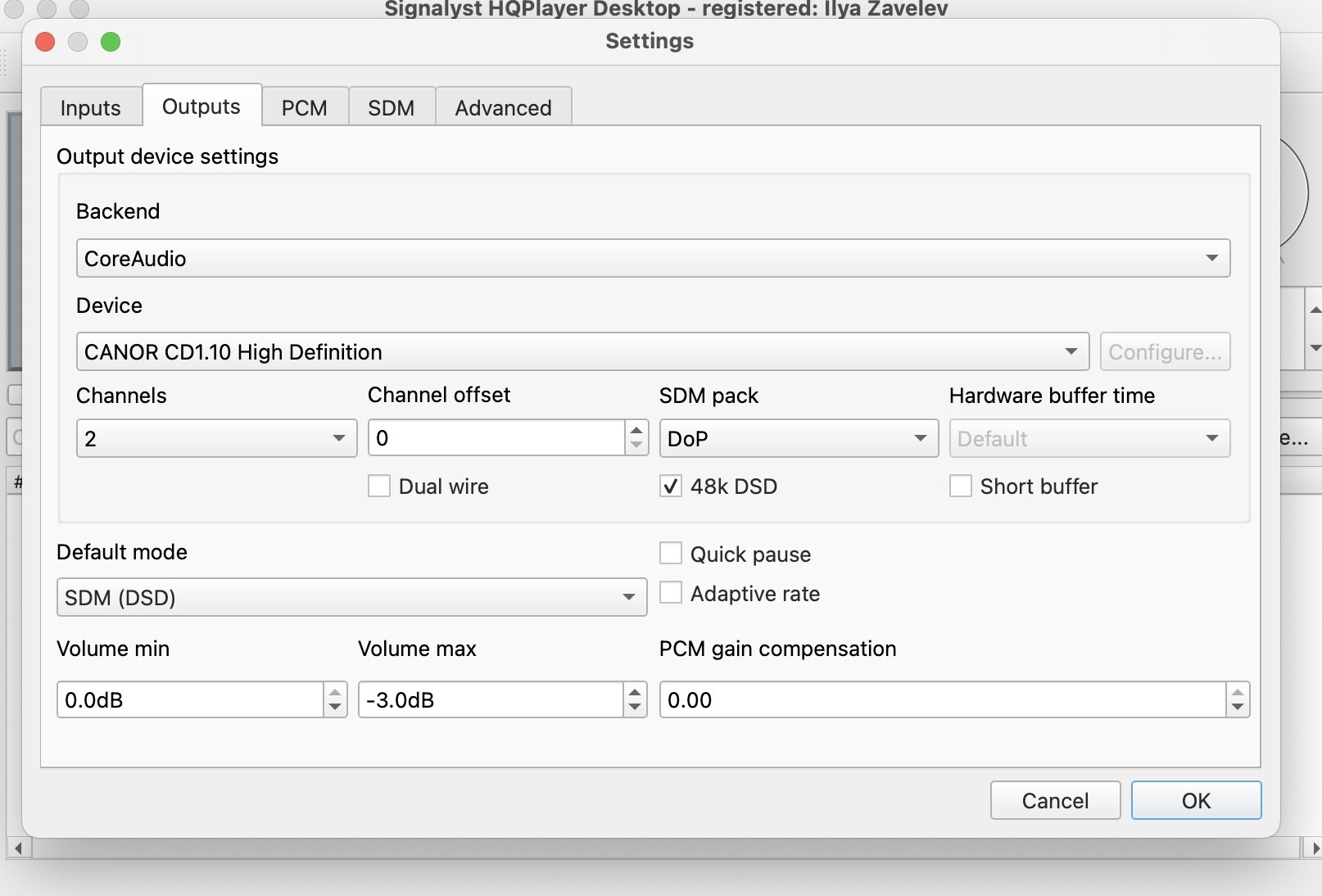

In the Output device settings, I have to mark 48k DSD?
When marked, the system works. But is it necessary, or not?
It should be marked only if you are absolutely sure the DAC supports DSD also at multiples of 48k. Most devices don’t, so it is safest to leave it off. To make use of 48k DSD you would also need to increase rate limit to 48k x256. When 48k DSD is not available, keep “Adaptive output rate” off.

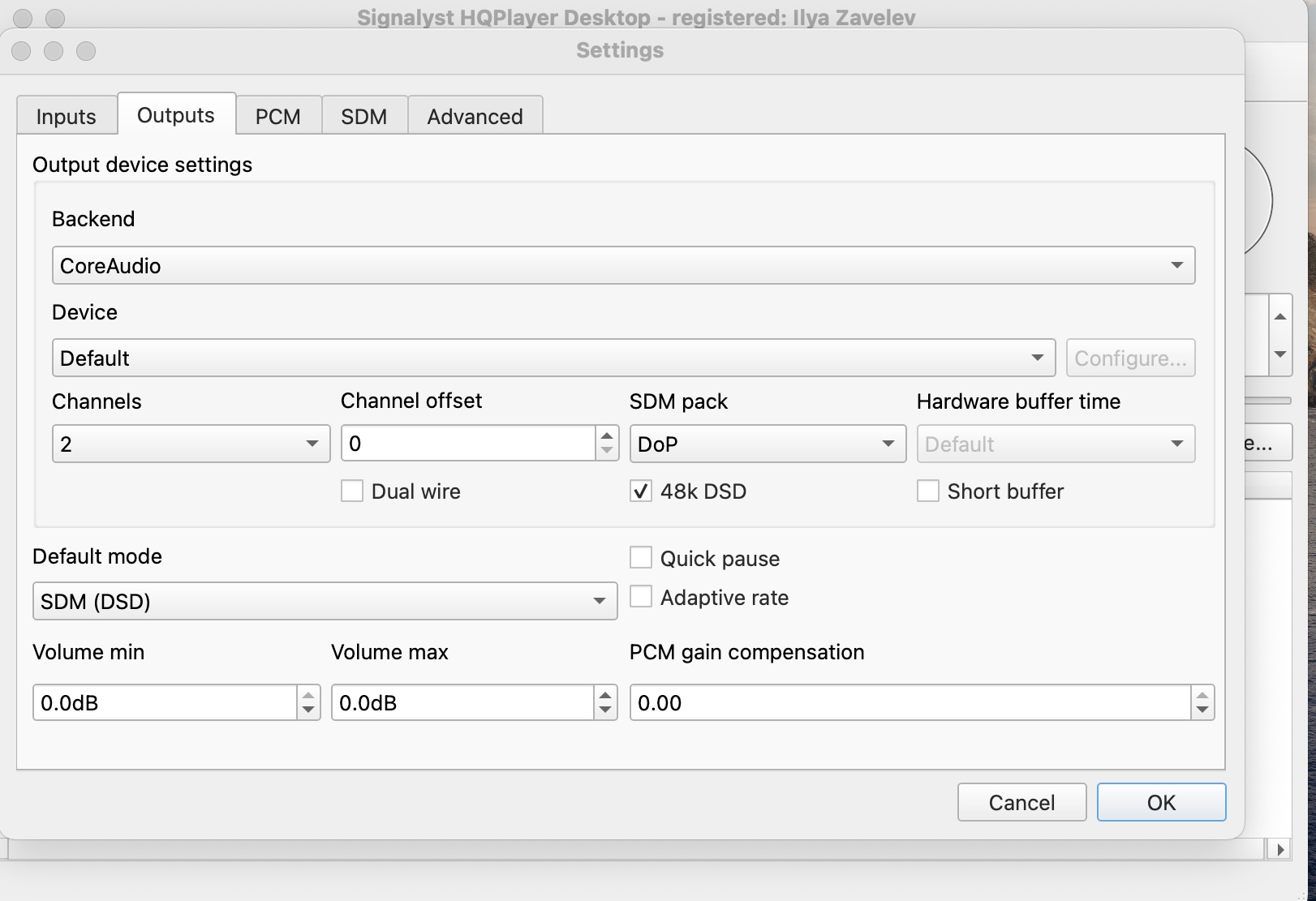

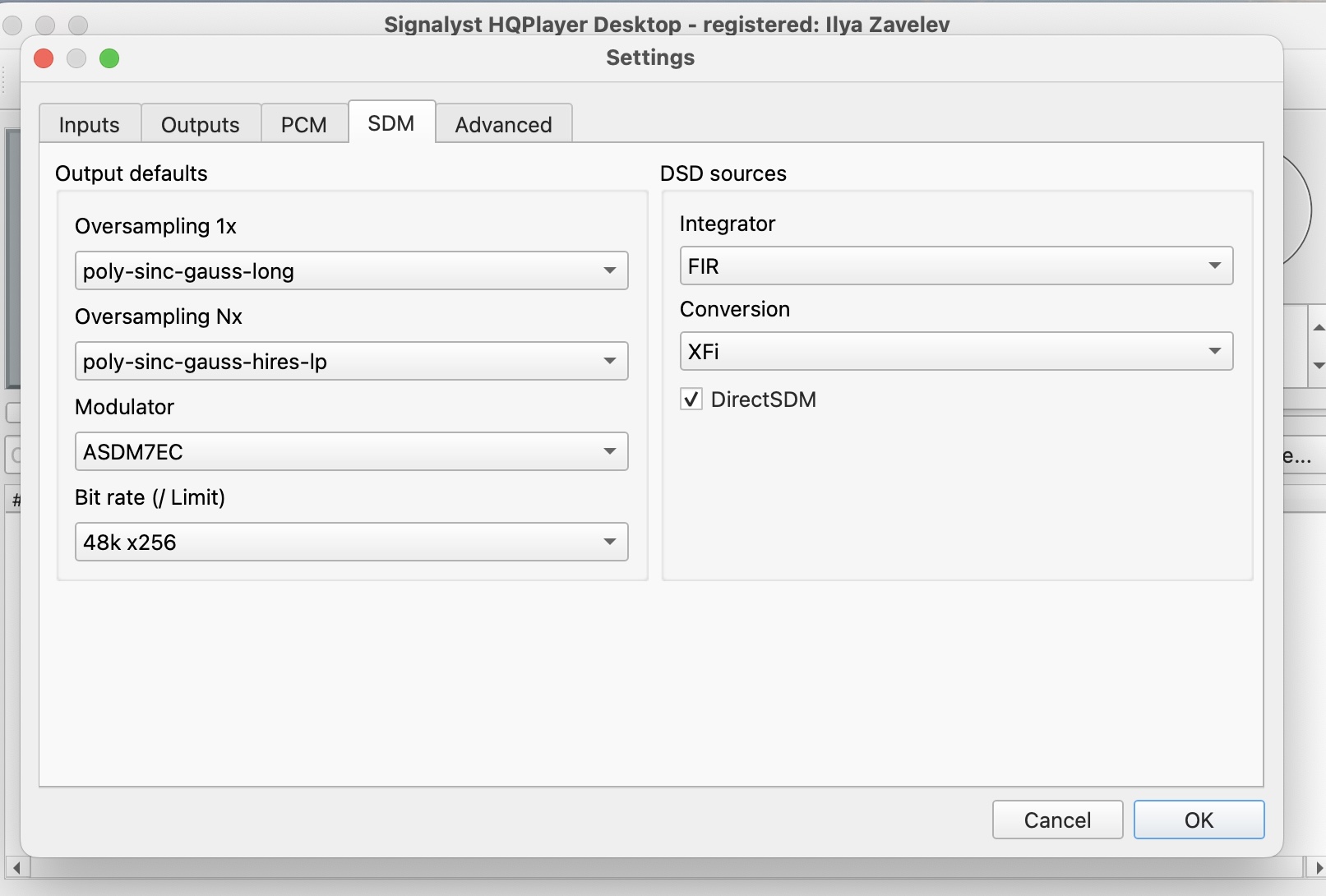

I tried settings from those pictures
Sound is like from vinyl.
When Adaptive rate is on, system doesn’t work with any other settings.
First thing, please select your DAC instead of “Default” and also check that your DAC is not set as default output device for macOS.

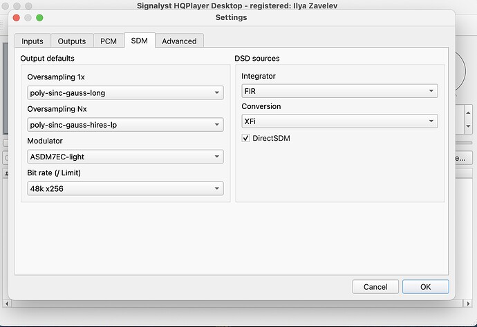

Please uncheck “48k DSD” unless you are absolutely sure that it will work. Please also set 44.1k x256 as output rate limit, and that Adaptive rate is off. And Modulator to for example ASDM7EC-light. Please also check that your HQPlayer volume setting is not higher than -3 dB.

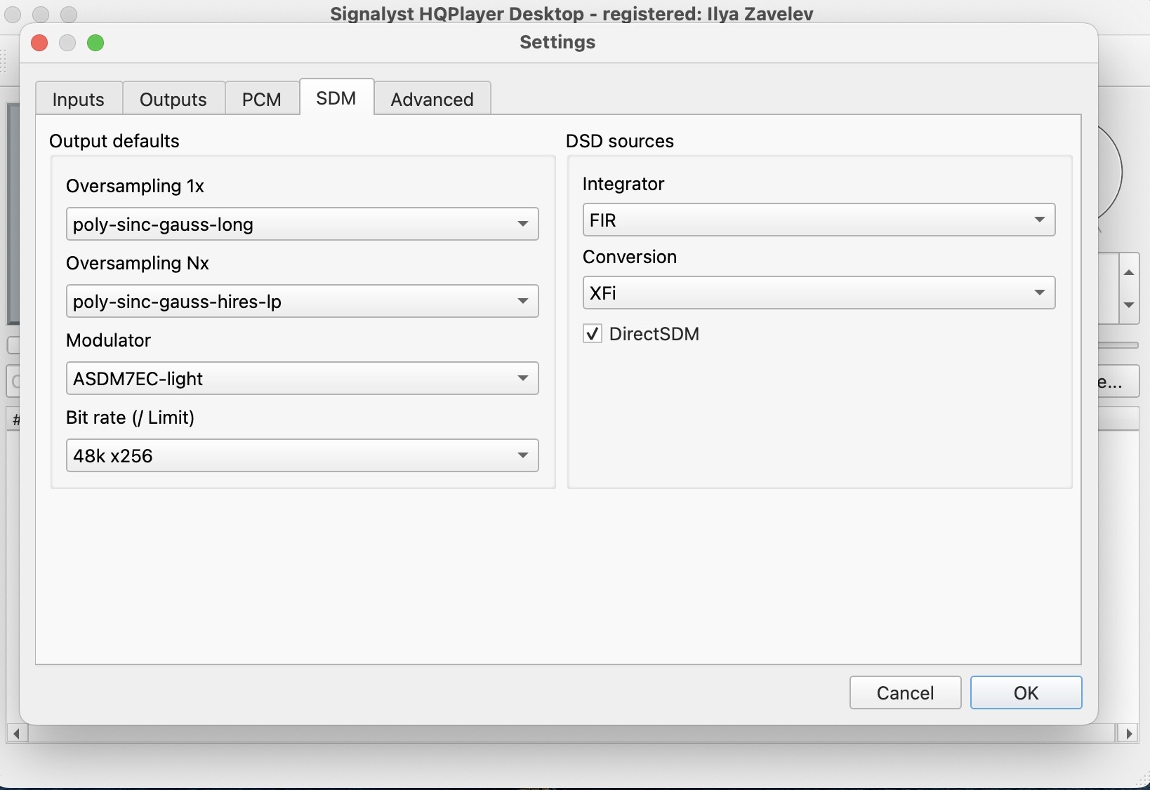

I followed your recommendations, and now, my settings look like this:
My system keeps going, and I’m satisfied with results.

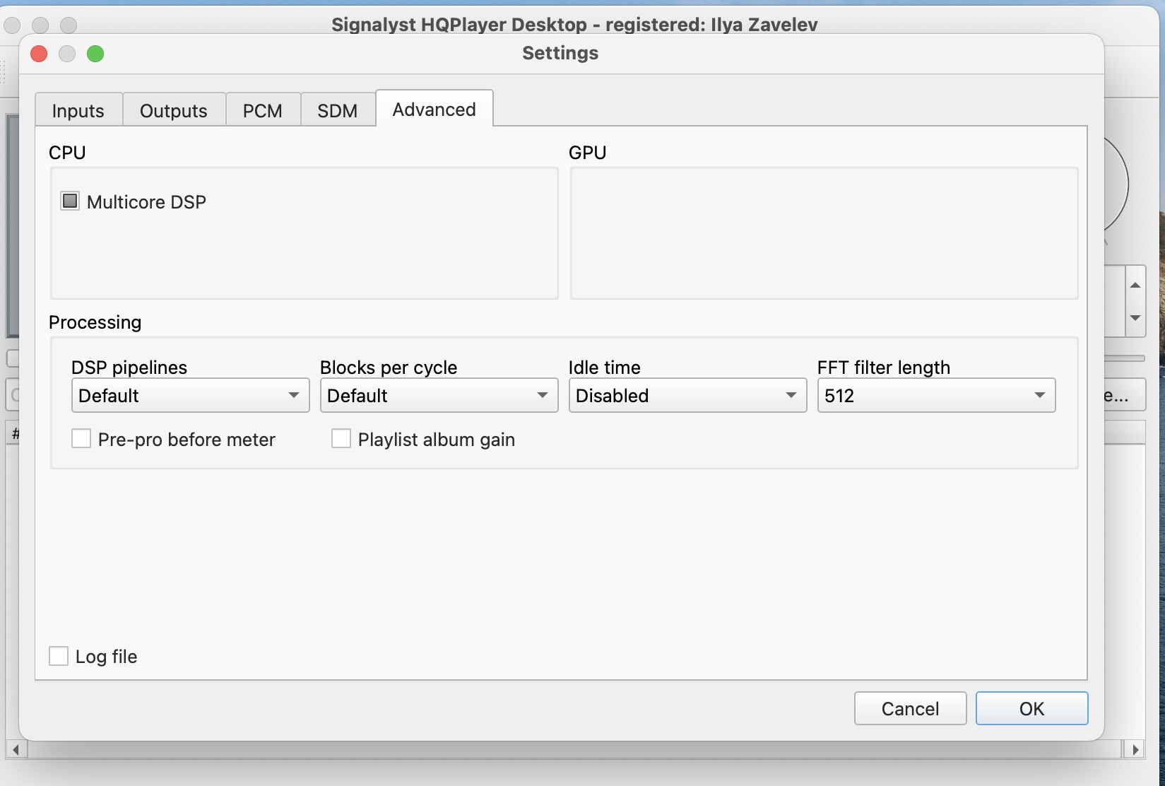

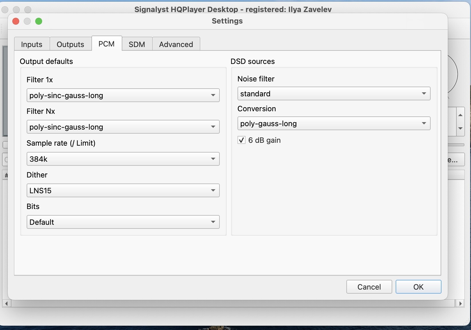

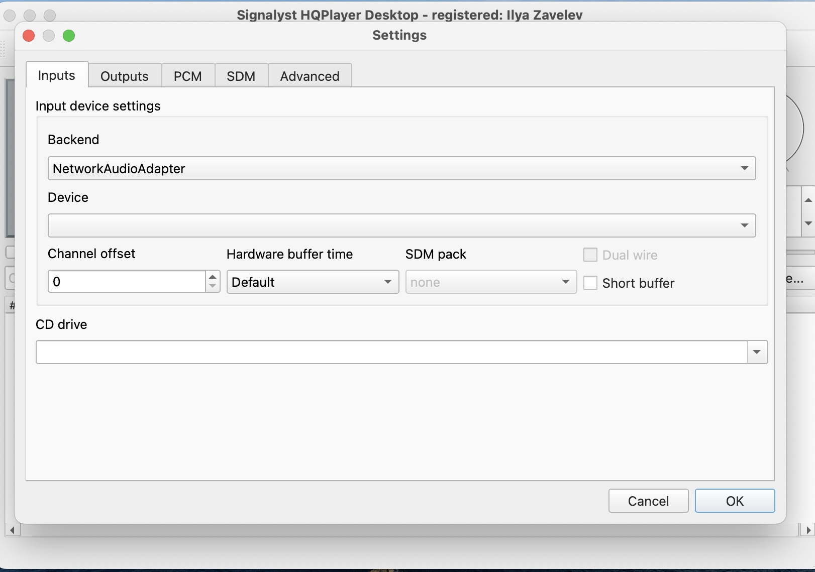

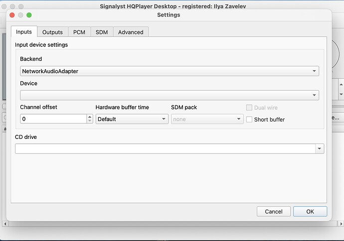

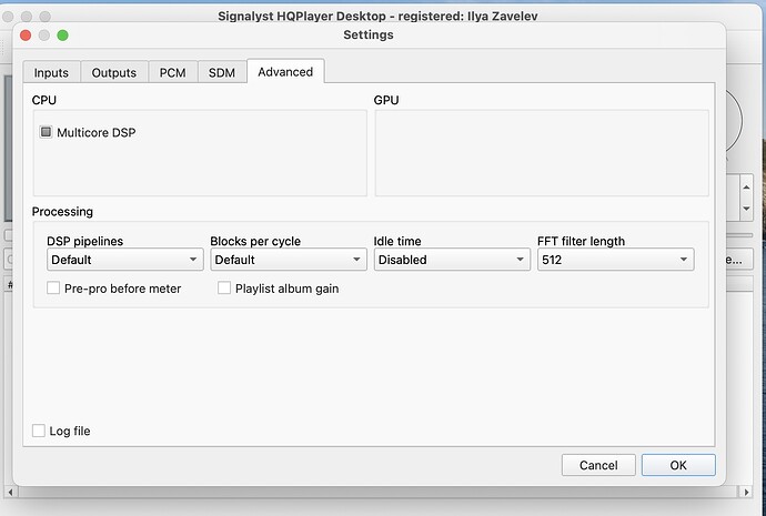

Please, could you look at these pictures of settings, and give me your opinion :pray:
Input backend should be set to “[none]” here.
Uncheck the 48k DSD here.
And here set bit rate limit to 44.1k x256.
When using Roon as source, I recommend setting Idle Time to 10 or 30 seconds. I personally use 30 seconds. This makes Roon interaction much snappier.
