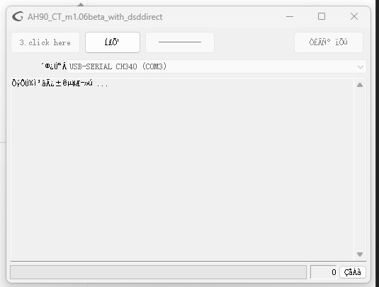

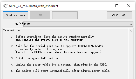

Hi, this will not work. I have tried to place the unzipped file under boot folder. Problem is there is aother boot folder under the root foldet named “boot”.
This “boot” folder under the drive letter “boot”, I cannot access. So I placed the new software under the driver letter boot folder, ie over the underlaying boot folder.
When clicking that software when copied over, it is Chinese (of course). I do not have a clue what I actually do. But it starts something. But it does not seem to finalizing anything and there is no progress bar visible. I waited a while. Closed window, unplugged and restarted, but no new DSD Direct.
I wonder why these brands find it so difficault to make at least english tutorialS???
Otherwise, it looks great! Hope to be able to say it plays well also … :wink:
Edit: How to make sense of this???
Audalytic installationsruta
in the top left it says step 3 “click here” in english
try that and wait until it finished and report back
Once you hit the “click here” button, unplug the DAC, leave it for 15secs and plug it back in, then the upload happens instantly and only takes about 2-3secs.

Shall the installation go to drive letter named “boot”, or the folder “boot” or “GustardCore02” inside the drive letter boot (root)?
You who’ve done this, the status bar lower part of windows does not show progess even after 1 minute. I did close the process anyway, and powered down the DAC, and disconnected cord. Waited at least a minute after disconnecting the cord, pushed the stand-by button to quickly empty the cap energy bank inside and reconnected the cord again, to power up DAC. No f*cking Direct DSD :rage:
I tried to blank out the mikroSD, start all over with Gustard Image file and their propriatery USB image writing software and got it back fully, with the drive letter D://boot, and two folders inside; “boot” and “GustardCoreo2”. That took appr 3 minutes to perform. So, how difficult can this be???
Now I have allowed the built in image writer to do what the h*ll it is supposed to (no progress report, what so ever like the Gustard Image writer) for more than three minutes. There is nothing indicating success or failure or the slightest hint. Just the same “simplyfied chines” runes your see in attached pic.
I closed the windows, a new dialog box came up in simplified chinese, probably asking me something, with a Yes and No button. Since the DAC is shut off, cord disconnected, I just clicked Yes and hope to get a fortune cookie in mail, in a few days.
Now the DAC has rested more than a minutes without any juice on, so I plug in the power cord and wait till LAN port said ready. Then I pressed knob and selected the Upgrading option, if the DAC machine is not smart enough by itself to understand it needs to check the microSD card for new FW when re-powered up. I will let it stay there for a couple of minutes, remembering the time needed performing the only update I managed to do successfully so far…

This is the instructions I followed which showed in English. The update happens during final power on.
There’s no images required to mess with
Interesting @steven_goodier had a different method that also worked
This step by step tutorial I have used (many times). Without success. Will try again. The com1 does not come up, it must be according to text the USB-Serial CH34x, in my case the std Windows CH340. Then click the 3. click here. Here it pauses and do not proceed, at least not with any visable acknowledgement. After minutes of letting it be, I simply pulled the cord and connected again. Wait … Maybe I did not do this correct, this window must be left up and in this window the reconnected DAC will start process the update???
F*ck the back, down under again, digging out the DAC … Luv’ye :heart:
I had a saying when working in a HiFi dealership; If everything else fails, read the f*cking manual … Better start living that truth …

I have been able to play now. There a bit of a hazzle to understand sudden dropouts but it seem that the new DAC/renderer made the DHCP confused. I had to yesterday go through all devices and instances and restart the switches, to renew all IP addresses.
Now it works, with one exception (will come back to that).
Just a couple of details for anyone new trying for this upgrade
  1. Download the software and unpack it on your PC
  2. Connect the DAC to mains and a USB to the PC where the upgrade software is
  3. Turn it on on the stand-by button/remote, if not already running
  4. To update following steps you do not have to use menu Upgrade mode
  5. Just start the un-zipped softare on your PC. Make sure you get a USB-serial CH340 (COM)
  6. Hit the button marked “3. click here”. Keep this window open in your PC!
  7. Hold on just for some seconds (keep the PC → DAC USB cabel connected)
  8. Disconnect the DAC power cord (with the PC → DAC cabel still connected)
  9. Connect the cord again after some 20 seconds (still online to the PC via the USB cable)
  10. The DAC powers up and start auto upgrading, providing yoy have done all steps to the letter
  11. You will see in the progress bar down in the window.
  12. When done, power of the DAC, disconnect USB cable, close window
  13. Power up again, press menu and check that the Direct DSD option is there (second line)
“Things”:

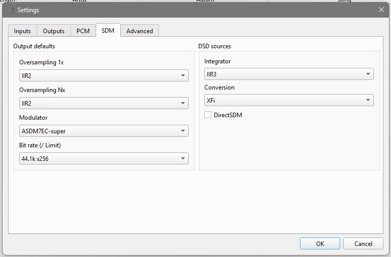

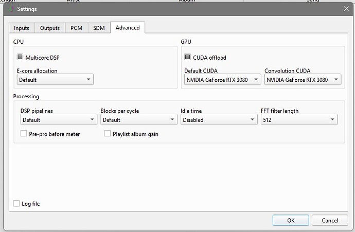

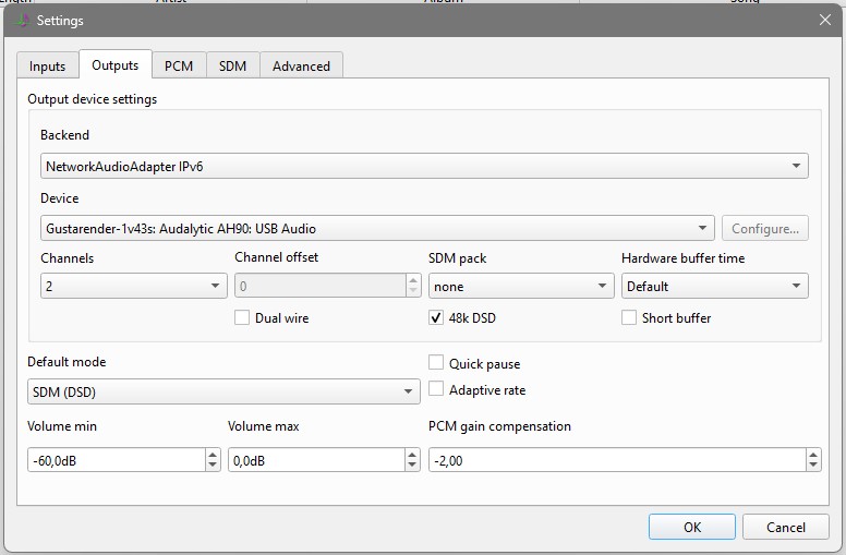

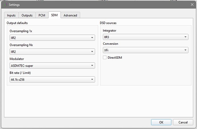

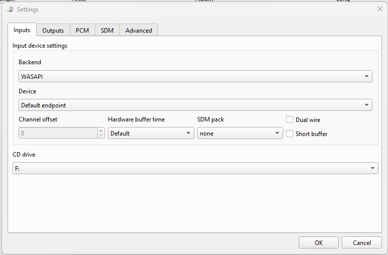

@Stefan_Jorma I wonder if we can check your HQP settings.
I have the RME also and I wouldn’t called AH90 laid back at all. At least in my setup. We all have different setups obviously
But curious if you can share the settings you use. Screenshots if possible
Also do you use USB isolator with RME?
And which USB streamer?

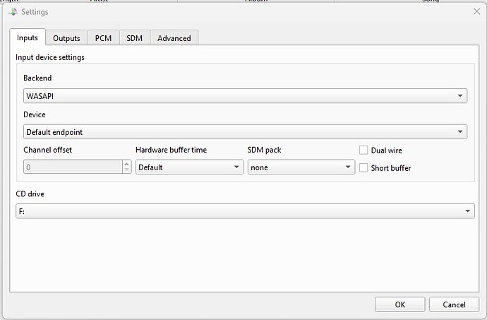

Here comes the screens shots. More answers below the pics to your other questions

Untik the option for “48k DSD”
Set Volume max to -3dB
So now without your Matrix your RME doesn’t have USB ground isolation?
But your AH90 does have ethernet isolation (with unshielded UTP cable)?
Will 48k base source rate even be playable, if I untick the 48k?
I am never up there at -3dB
No my RME does not have isolation. It is not even in my speaker rig anymore, it is the headphone DAC/amp, for my computer.
There is a sheilded ethernet cable between the optically fed switch, linear power supplied, protective earth grounded. No cable shield noise remains. Measured.
Yes of course. This option is about output, not music/source (input)
Some filters cannot work at all with 48k → DSD256x44.k
If you have sound then your filter works :blush:
