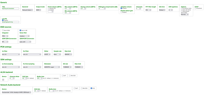

I notice when playing back DSD to the AH90 there is a small static pop at start of playback and between tracks. Is this phenomenon specific to the DAC or to DSD in general? Is there a way to avoid these clicks and pops?
Did you update firmware for DSD Direct?
Are you at a fixed sample rate of 44.1kHz x 128 or 44.1kHz x 256?
I don’t have any pop - I am fixed DSD256x44.1kHz rate

Yes, I’ve updated the firmware to enable DSD direct mode. Even just changing the mode from off to wide, I’ll hear some clicking. Then when NAA enables output, I’ll hear some just before playback. When changing tracks it also happens. I’ve tried disabling the quick pause option, it seems to diminish occurences but I wonder if it has anything to do with buffer size or some related parameter

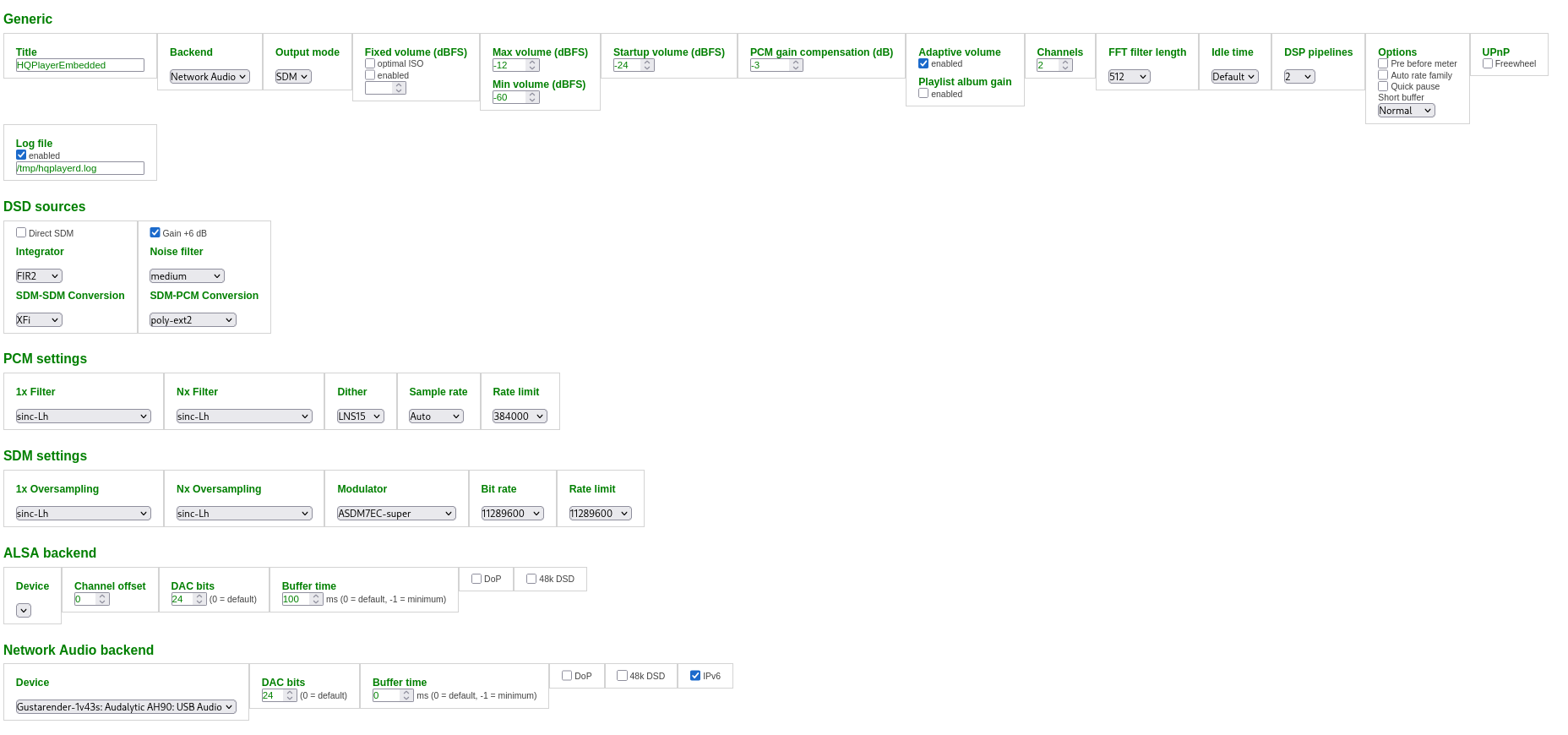

And sample rate output? Can you share screenshots of all your HQP settings
I recommend to have “Idle time” set to for example 30 seconds. This greatly reduces the amount of DAC start/stop cycles with Roon. And makes the overall interaction much quicker.

Ok, I’ve added the idle_time attribute to the engine element of the config. But I am not playing from Roon. Right now I am directly using HQplayer library either through web interface, or client.
I think disabling the quick pause option has really reduced the number of occurrences. I notice it the most when changing bitrate, but can still hear it just not as loud between tracks. This might be also be on DAC firmware side also.

Your web config still shows “Idle time” as “Default” which means disabled for most cases. If you manually modified the configuration file, did you remember to restart the hqplayerd service afterwads? Otherwise it doesn’t get loaded and can get lost if you store the configuration from HQPlayer before it gets reloaded.
It is also helpful with Client, as many times 30 or 60 seconds is enough when selecting next set of music for playback. Thus the engine and DAC doesn’t need to stop meanwhile.
