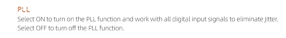

As the proud owner of a Cyan 2, I’m going to replace it very soon with a Spring 3 KTE.
For those who already own this model and for Miska, I’m wondering about the PLL function, which doesn’t exist on the Cyan 2.
By reading the documentation, this PLL function can be activated or not
What is preferable to choose knowing that I now have the following settings on HQP desktop 5.13: SDM1024, and the AHM7EC8B filter?
Another question: is the Spring 3 like the Cyan 2, i.e. only NOS mode or not?
If you use USB connection with the Spring 3, like you should for the best sound quality, the PLL setting is irrelevant.
Yes, Spring 3 is NOS only.
Thanks.
yes, USB connection, so deactivate PLL, right?
Yes, and with other connections you can experiment with it to find out what sounds best.
I wouldn’t expect, that (using only the USB in) you’ll get a better SQ with the Spring KTE.
I’m using a Cyan 2 and a May KTE (but here all inputs, but every time in NOS mode) and the difference in SQ with using the USB in and the same HQPlayer settings are for me not really noticeable.
The setting doesn’t apply for USB inputs, since in that case the DAC always owns the clock. It applies only for cases where the DAC is clock slave, such as S/PDIF, AES/EBU and I2S. These clock slave cases are best avoided.
