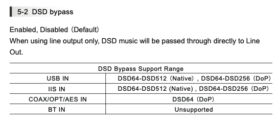

  1. K11 R2R new firmware M79, now supports 1bit DSD native decoding!
Since its launch, the K11 R2R’s 24bit R2R DAC sound quality has received widespread recognition and praise. We sincerely appreciate your support.
After release, we maintained close communication with users and received requests about implementing DSD native decoding on the K11 R2R. Through relentless efforts by our engineers, the K11 R2R now achieves 1bit DSD native decoding! Interested users can upgrade firmware to experience this (Note: the K11 R2R doesn’t support OTA upgrades. Please download the upgrade tool on the PC for manual upgrade). We would like to receive your feedback on the listening experience after trying the new firmware
That’s not about the topic of this thread (at least as I understand it). The name of this thread causes confusion.
From the link you posted: “Rotate the knob to switch the settings menu DSD DOP to DSD 1Bit.”. From that sentence it is clear it is about supported USB transfer mode of DSD data (DoP vs. native) but not about internal direct DSD path.
See more explanation for example here: Which DACs bypass digital filtering? - Page 34 - DAC - Digital to Analog Conversion - Audiophile Style

I’m not confused, at least I hope not. :slight_smile: If you read the documentation, the firmware update is about decoding 1 bit DSD, not USB transmission changes. I am curious to hear Jussi’s take on what this is doing and if he has had a change to test it, or, will be testing it.
If anyone is unclear they should read the section in the document (which Michael provided a link to above) called " 2.2 Working principle of 1bit DSD native decoding" which the firmware is enabling.

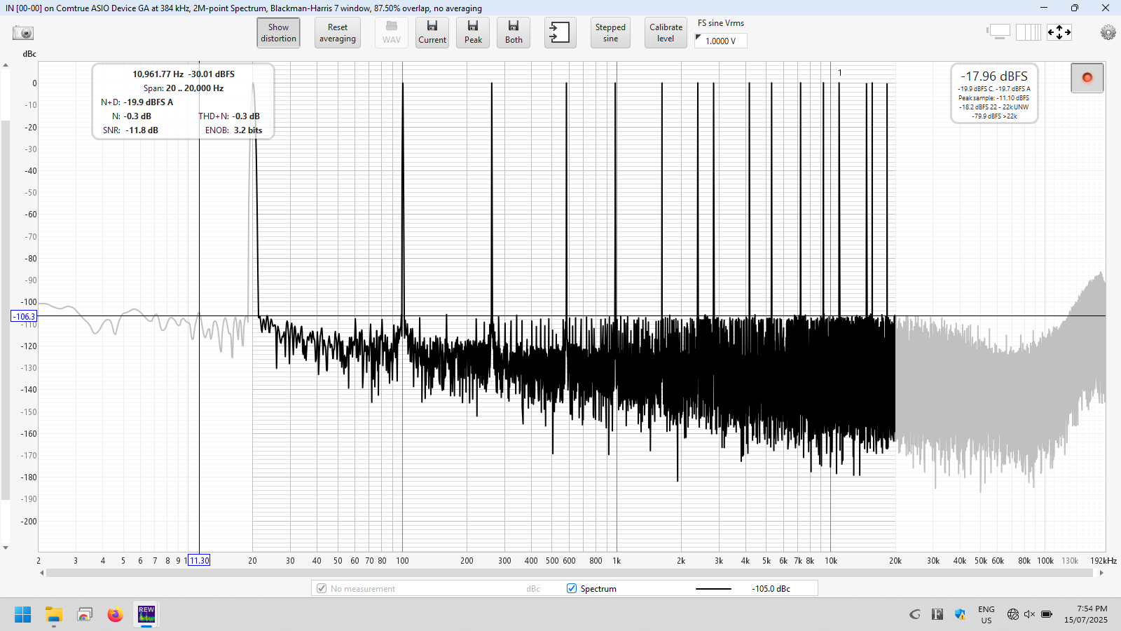

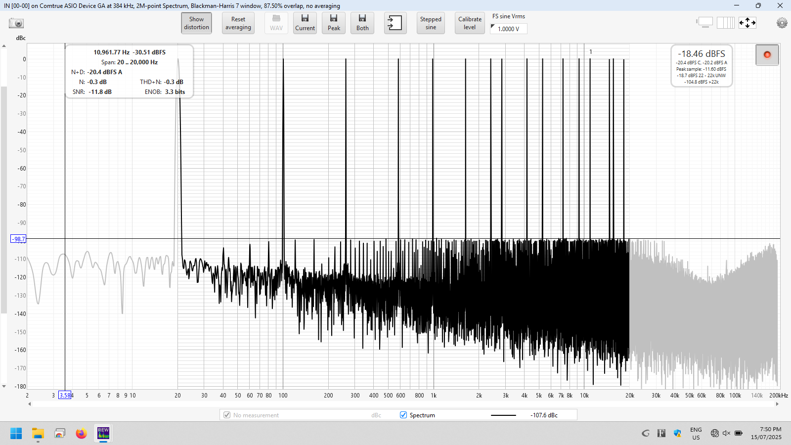

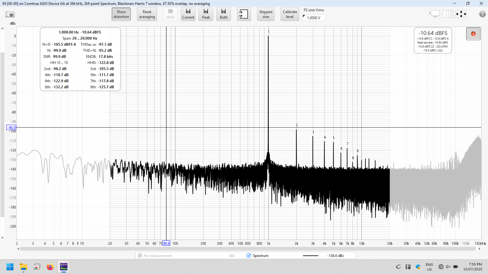

Have the iFi Zen DAC 3 in for measurements.
DSD512 has really nice wideband performance but all other measurements under 100kHz take a hit, so DSD256 is what I would recommend for lower noise and lower distortion.
Freq response is -1dB down at 60kHz. Maybe could benefit from DAC Corrections?
I wonder if this performance is similar to your Neo iDSD @jussi_laako ?
Jitter is excellent. DSD Direct is supported with both 44.1k and 48kHz family rates.
Not as good measurements as my AH90 in DSD Direct but very good value for money and it is true DSD Direct out of the box, i.e. without having to load some custom firmware.
I haven’t listened yet. Was measuring while watching some news :grin:

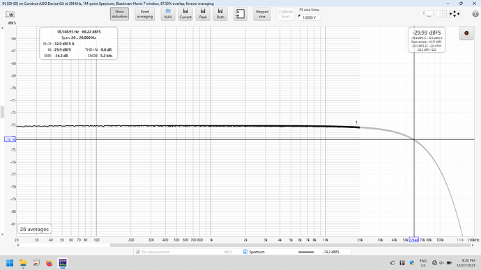

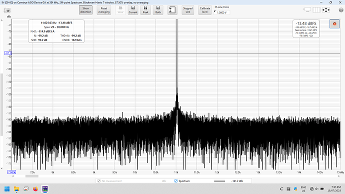

I measure with gauss-long-xla for most measurements. Freq resp with sinc-S. ASDM7 modulator. Haven’t tried ASDM5 yet.
DSD256 jitter

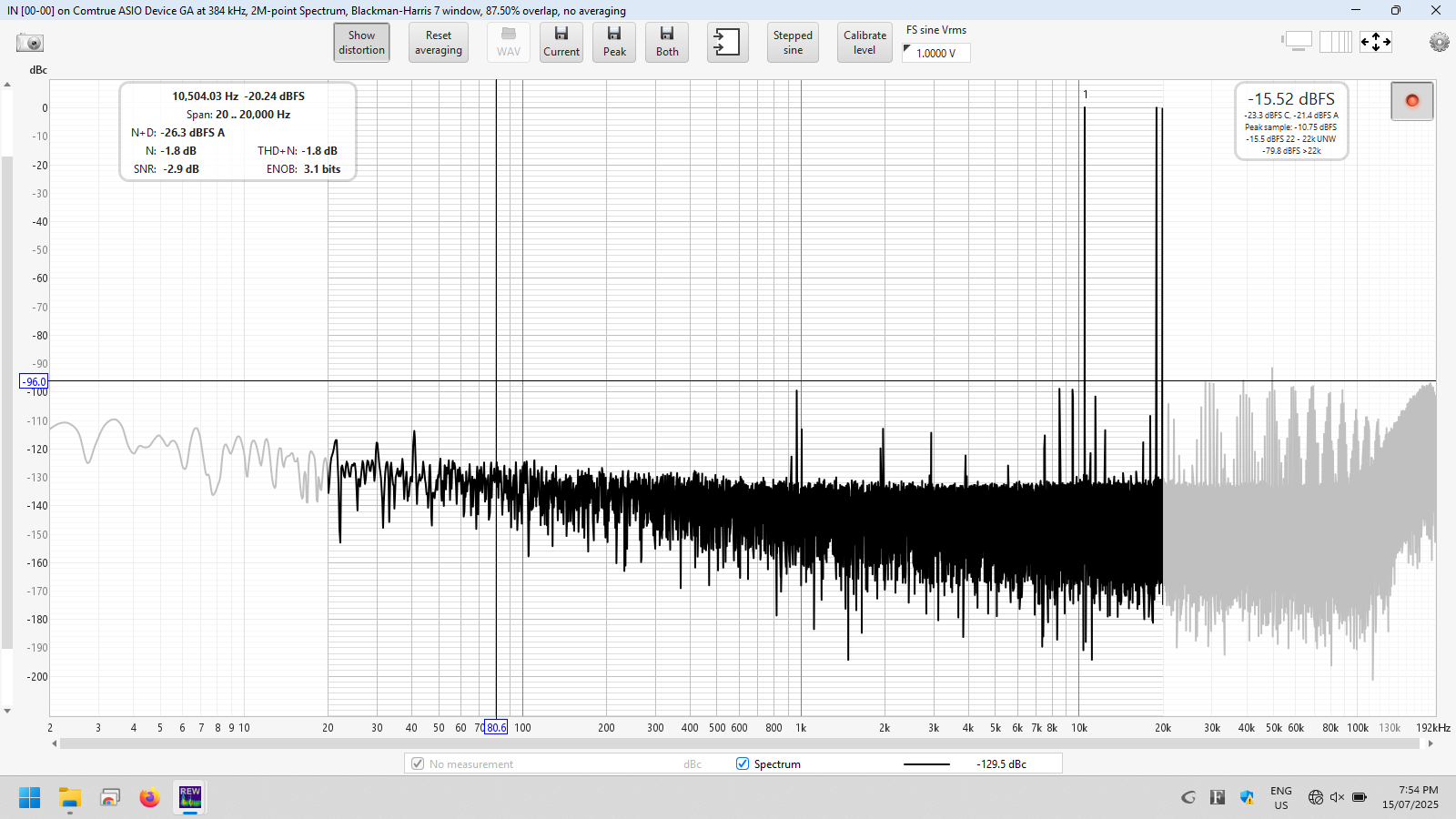

DSD256 multitone

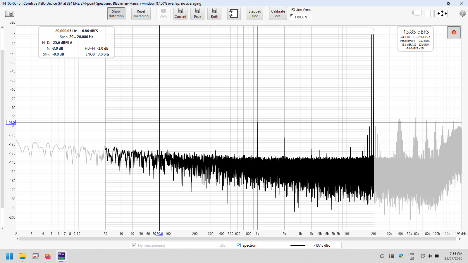

DSD256 triple tone
DSD256 CCIF dual tone

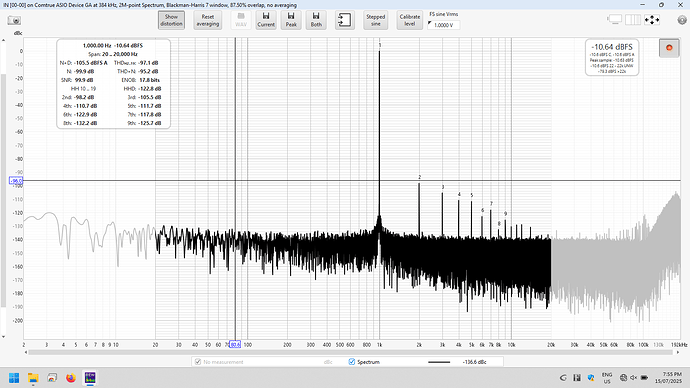

DSD256 1kHz
DSD256 freq resp
DSD256 x 44.1kHz wideband
DSD256 x 48Hz wideband

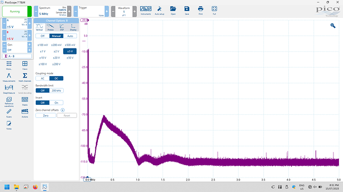

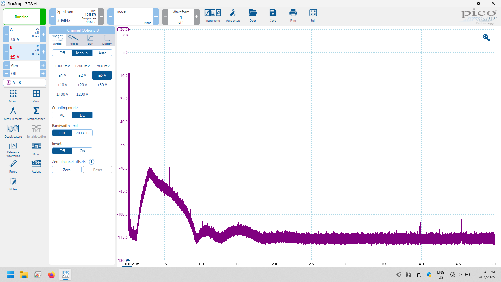

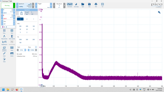

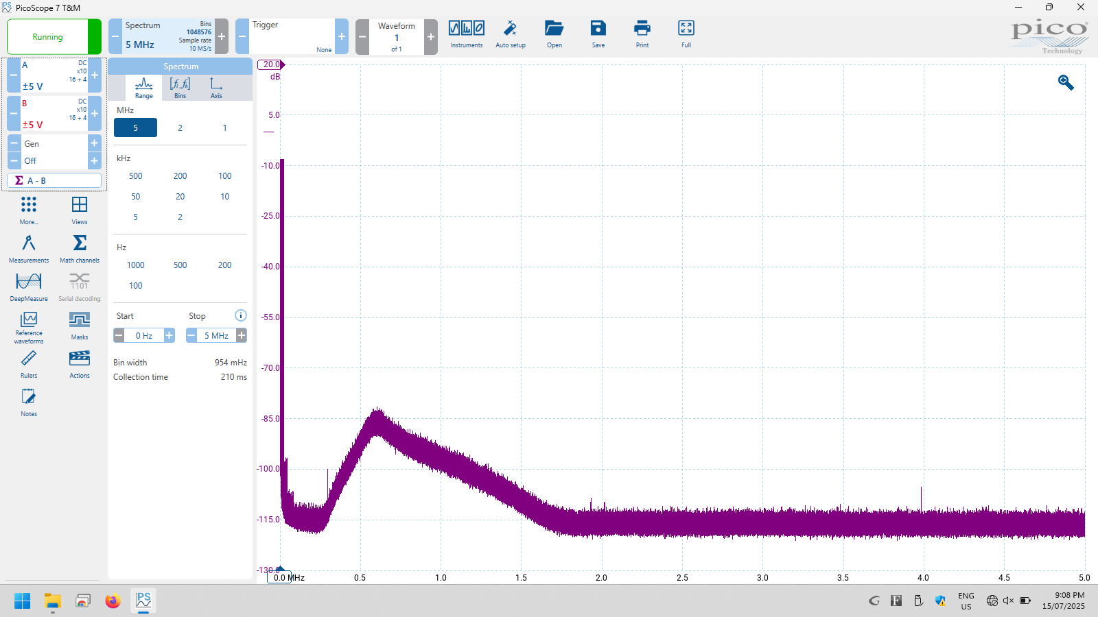

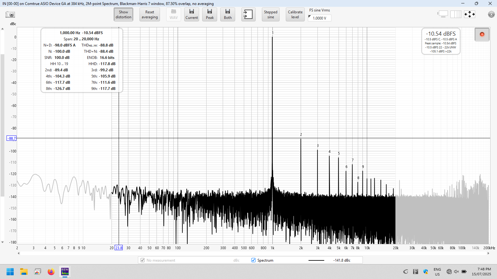

DSD512 wideband
DSD512 multitone
DSD512 1kHz

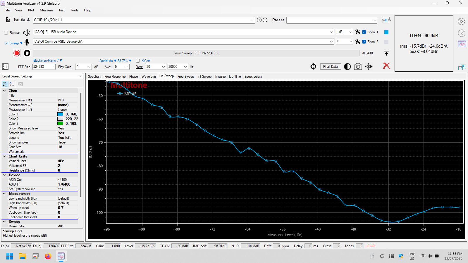

IMD vs level , the noise floor itself is higher than other DACs but this is not the worse I’ve seen.
