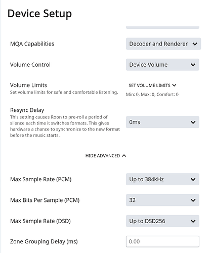

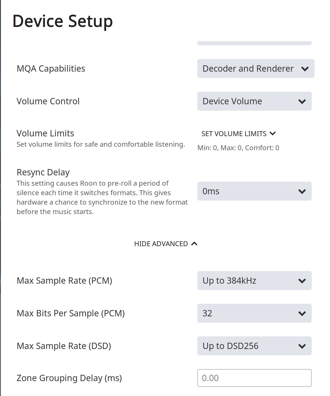

I’ve installed the MQA optimized Firmware (5.3) on my iDSD Micro. Which are the best Settings? I posted a screenshot of my settings. Is that how it should look like?
Second question. Does anyone know why pcm can only selected with 384 and dsd with 256? The iDSD should be capable of DSD512 and PCM768
THX

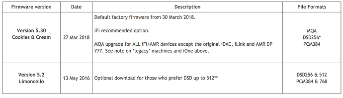

Hi ManInTheHighCastle
The MQA optimized firmware won’t support DSD512 at all. You have to choose whether you want MQA decoding (v5.3) or DSD512 (v5.2), with separate firmware to load for each.
Hope that helps.
ok. good information. does anyone know if my settings are correct (decoder and renderer)?
Else: is the overall performance with normal flac playback degraded with the mqa optimized firmware?
Choose Renderer for the iFi portable DACs and look for the magenta coloured LED indicating MQA rendering.

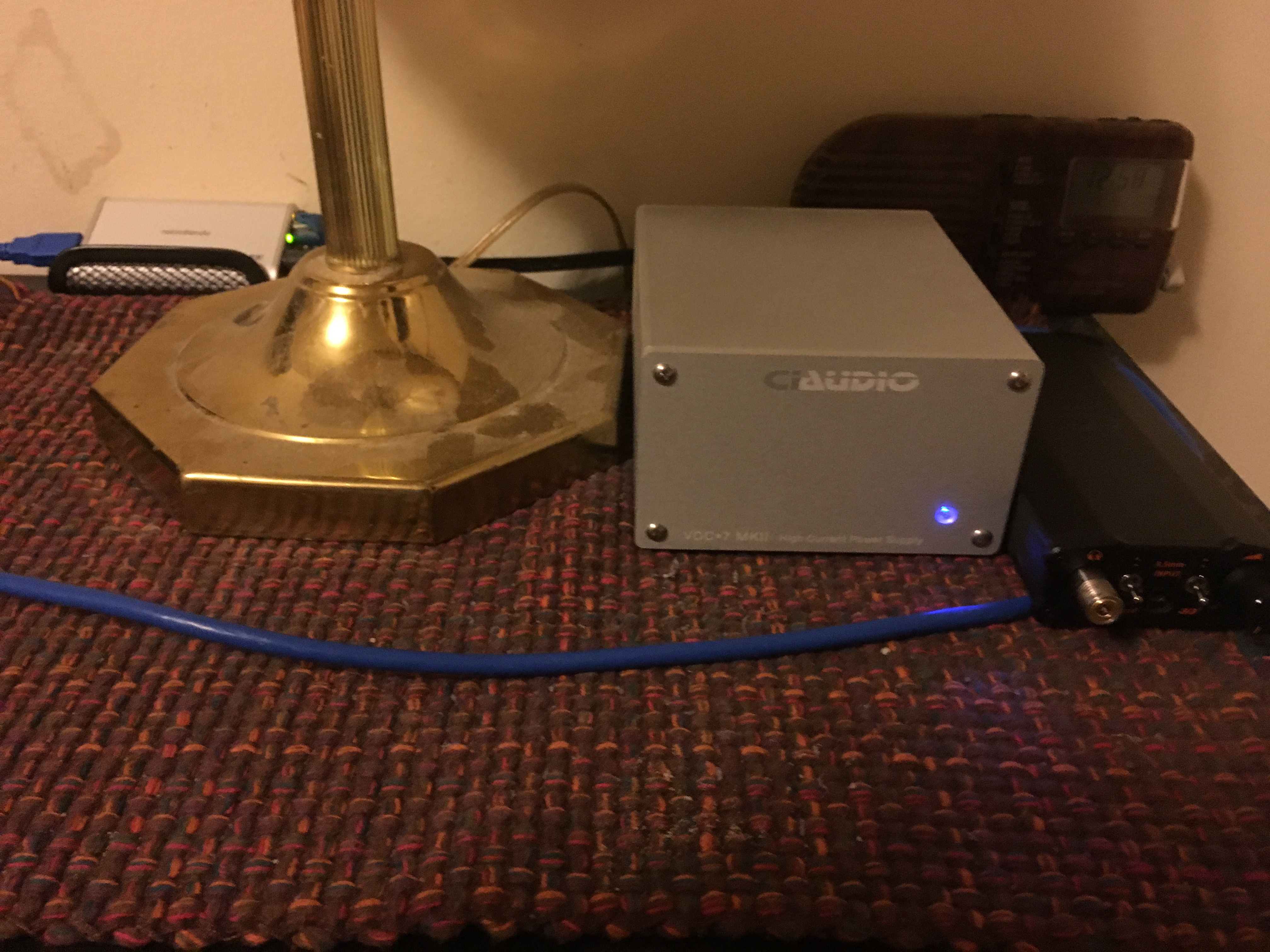

I have a Micro iDSD. I was running it at both 768 and DSD512 thru an SMS-200.
I have it plugged into an Nano USB3, which is always plugged into the wall.
I can’t keep the battery charged. Very annoying.
Do you have any problems like that?
