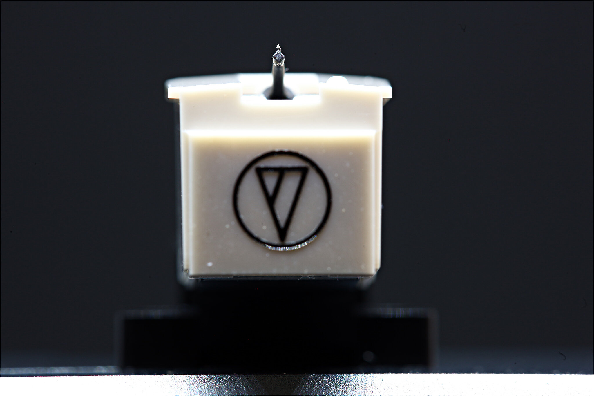

It is likely the AT-3600L, perhaps with some OEM modification.
