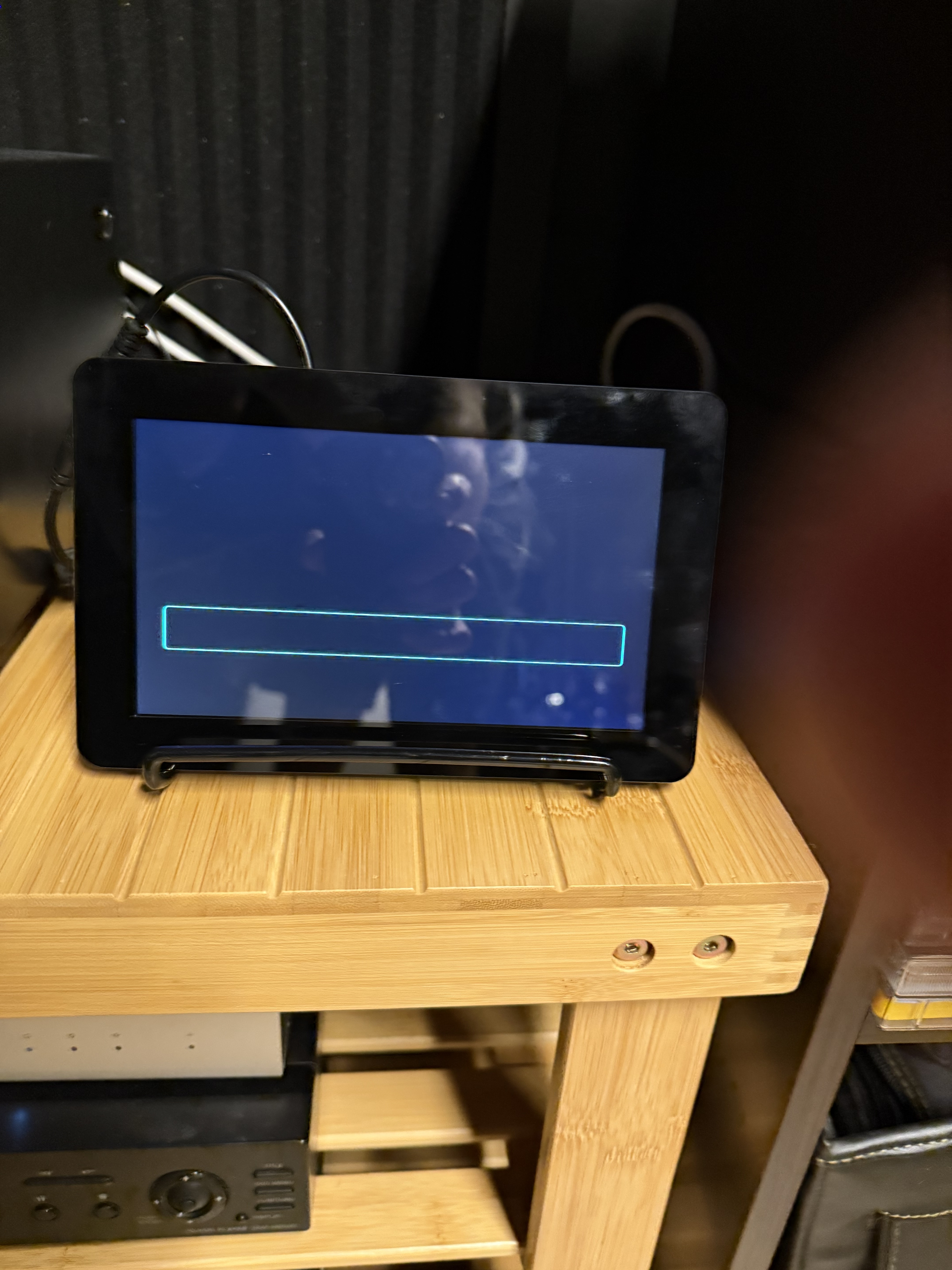

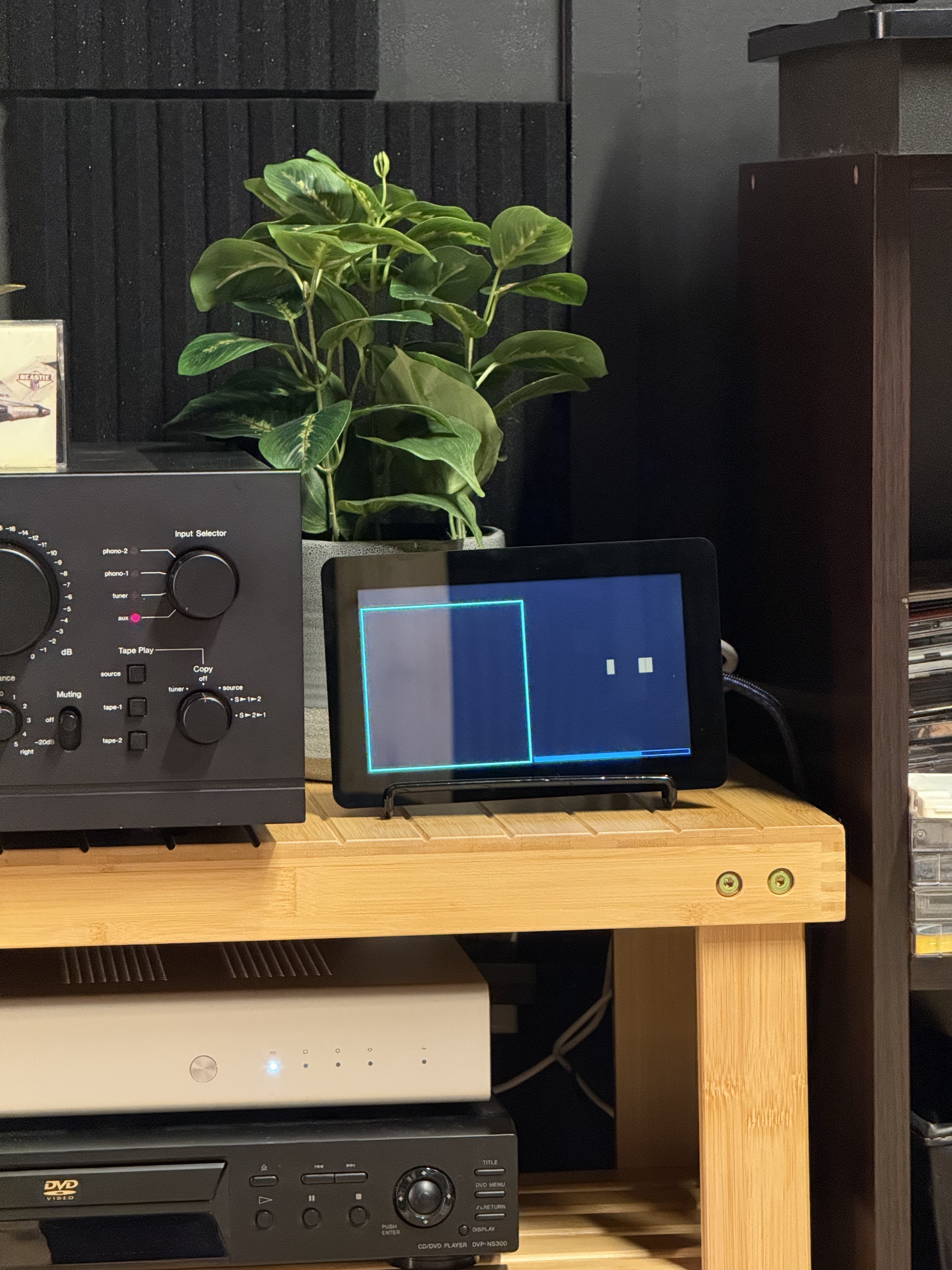

Sorry for the confusion. Same story meaning - boot screen comes on, is normal, but official display 2 with official power supply and cable just show a blue box. This is what happened when I removed the DAC and just tried to use it as a display for a Roon zone.

Unfortunately the issue as seen by Will is not solved for now, but I’m out of ideas (and not convinced it’s not a hardware issue).
Thanks
It may be a hardware issue. I will keep troubleshooting on my end and see if I can figure it out. Thanks for all of your help!

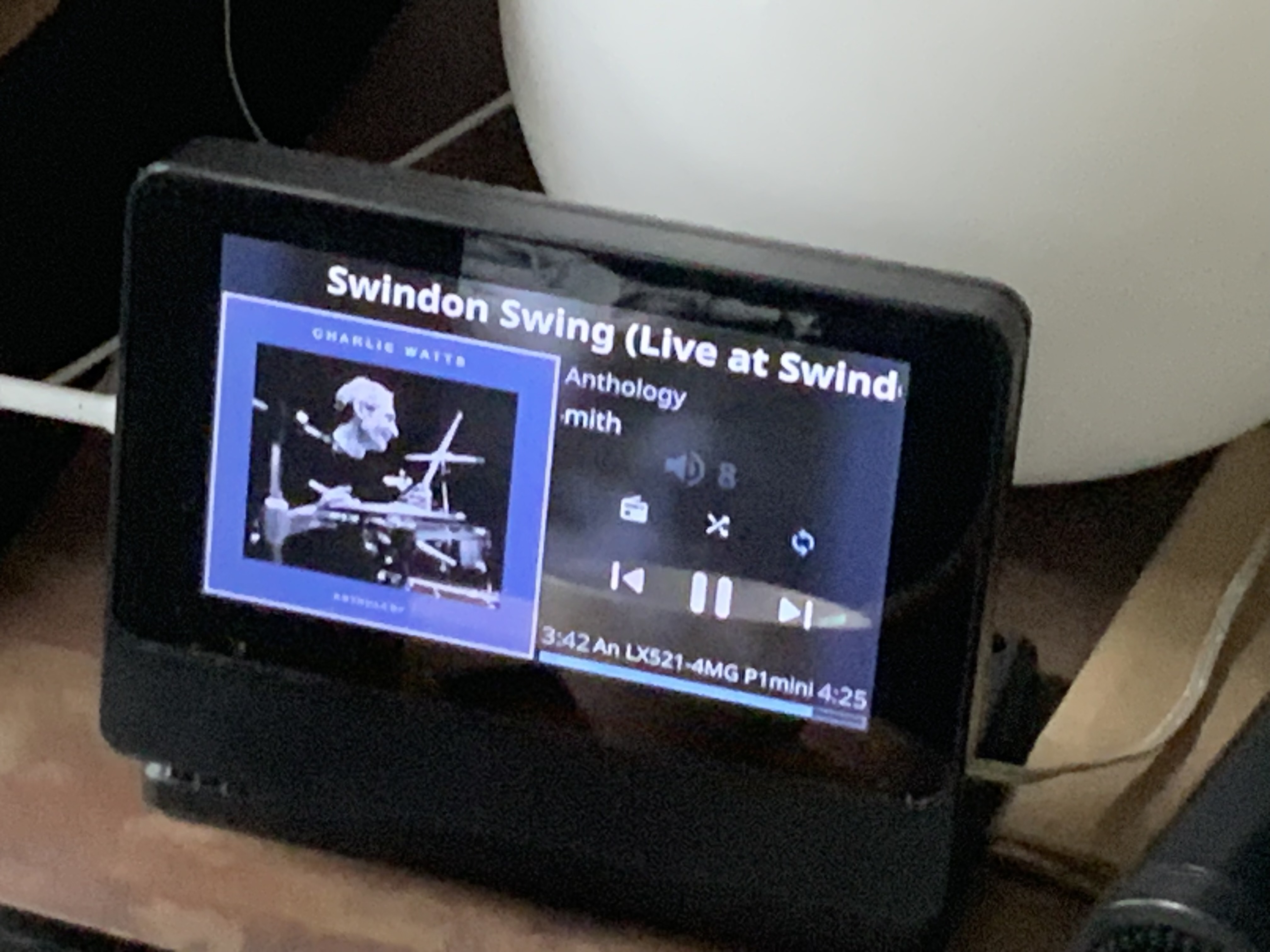

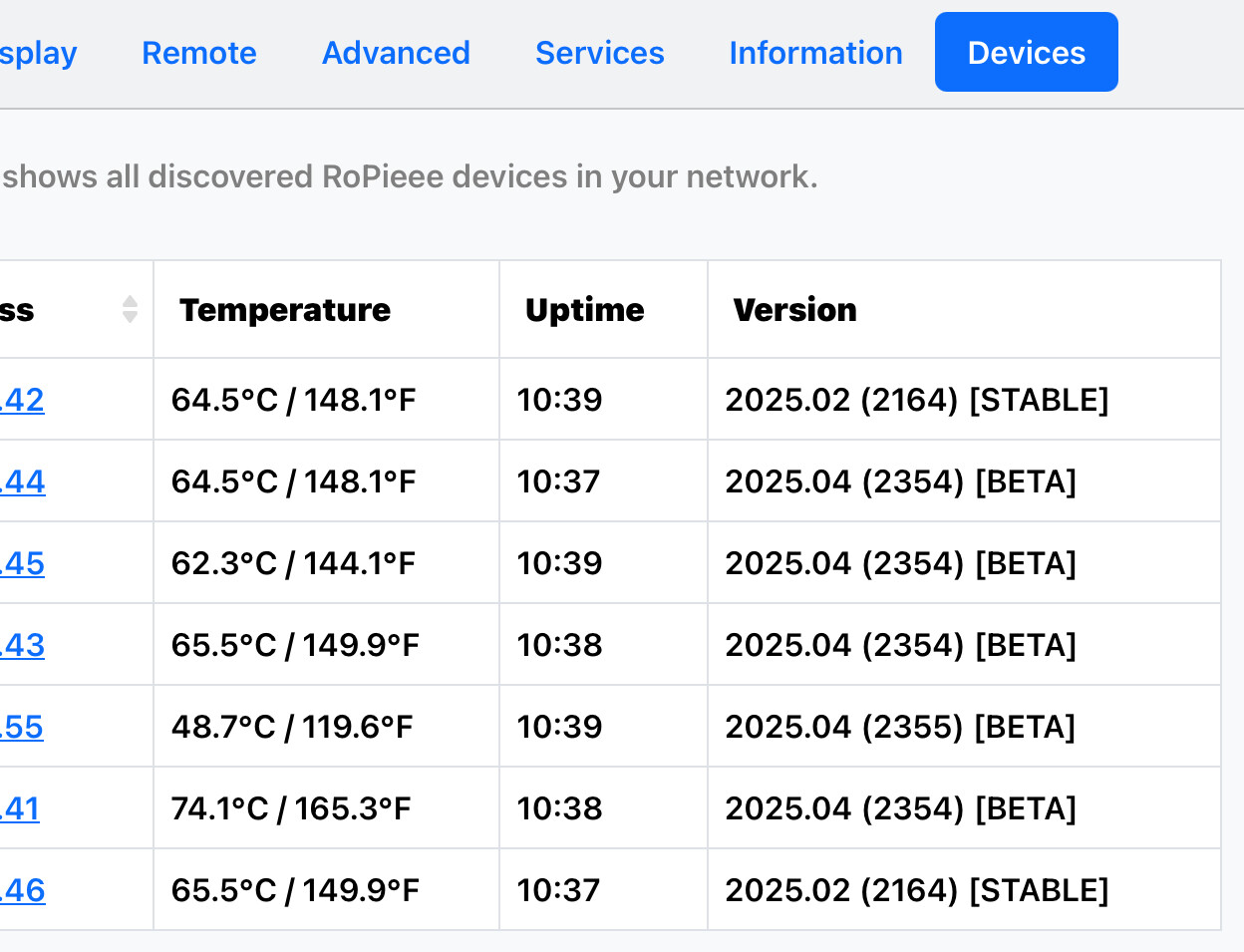

Hi Harry,
I installed the latest RoPieee to all my RPIs All went well.
My 3 RPI3s with build 2354, all with display 1 connected and in “auto-detect”, are still working correctly.
My 2 RPI4s with build 2355 do not have a display and are OK.
My one RPI5 with build 2356 also doesn’t have a display and also remains OK.
Thanks a lot for all the hard work, Frank.

I will add, that this same screen (Display 2) cable and all, worked with my Pi4. It really is a head scratcher that it does this with the Pi5. Like I said though, I will keep at it and see if I can ever get it to work.

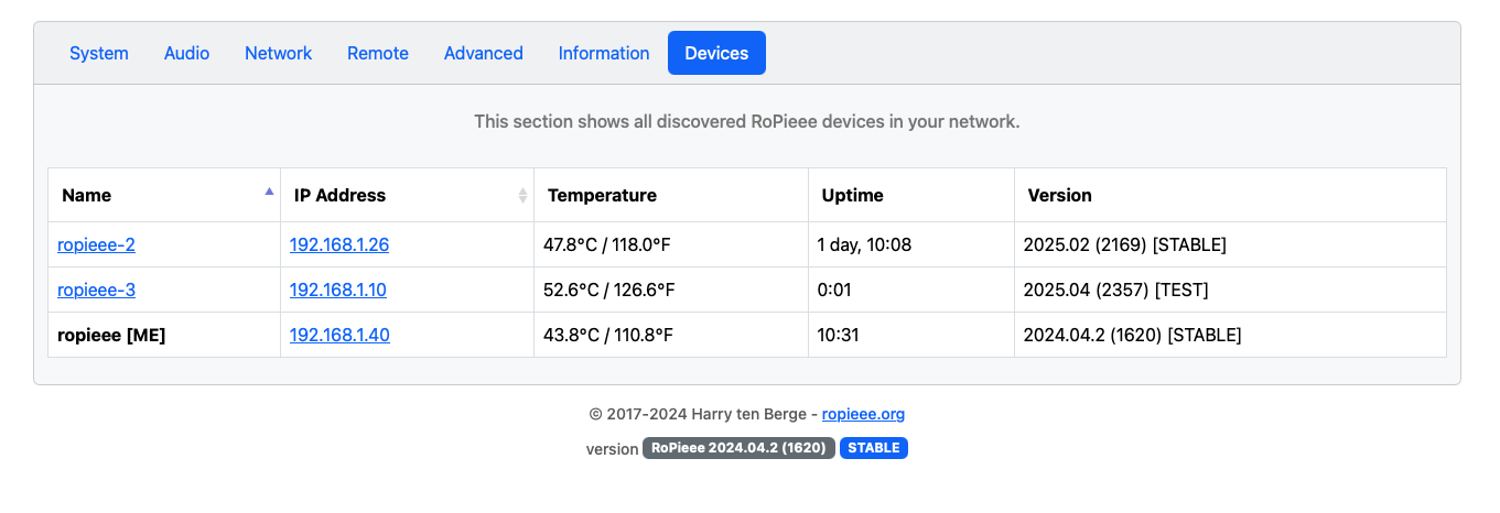

Thanks again for sending the image @spockfish , I uploaded on one of my USBridge devices :
as you can see the .10 device is running the test version while .26 is still on 2025.02 stable . (,40 is an RPI4, pls ignore).
