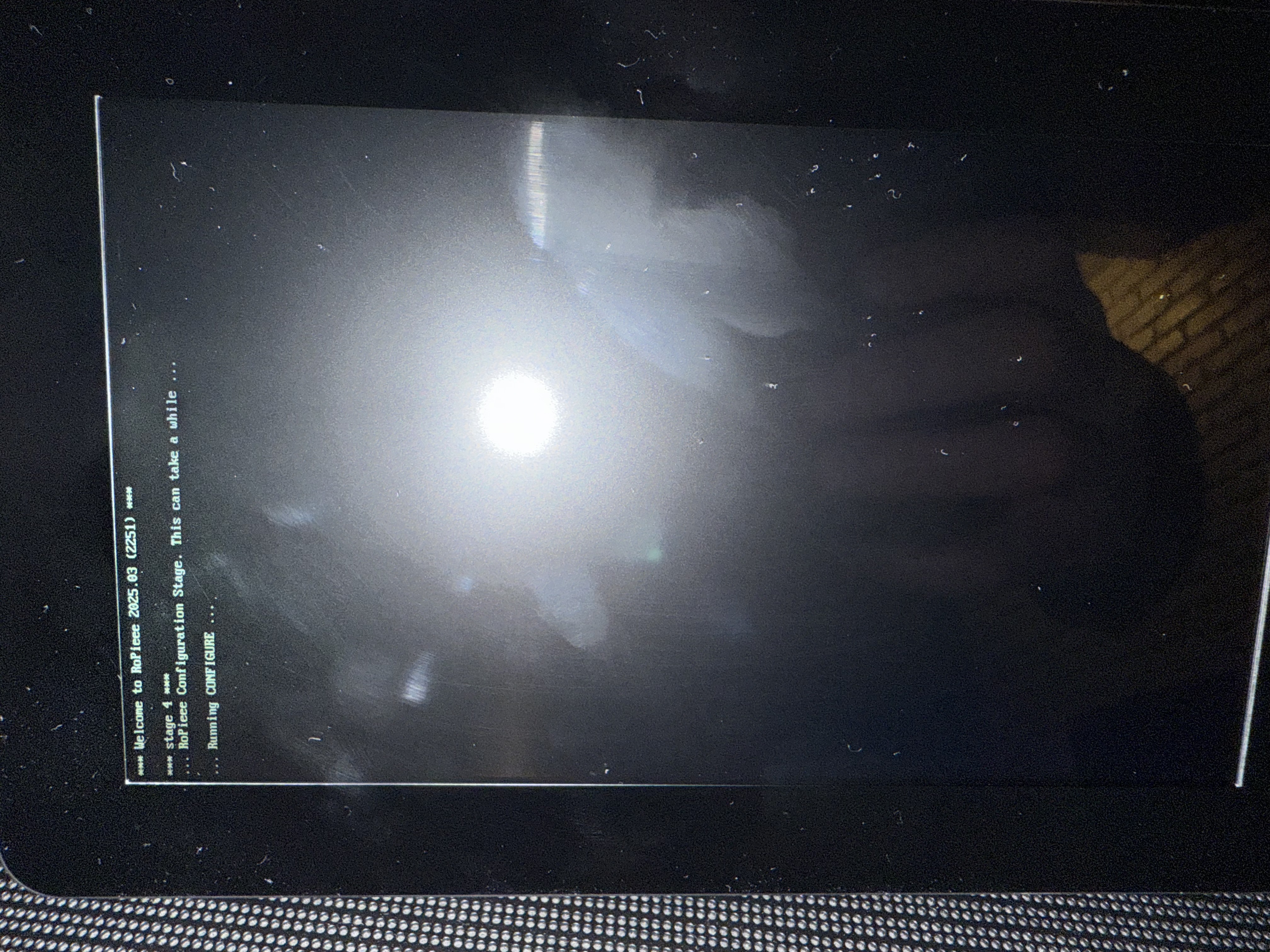

Yes. Something is happening, but after this screen(image attached) the screen goes black and nothing else happens. I am not able to access it through the web interface(ropieee.local), I have also checked under the audio settings in Roon and under “Devices” through the web interface of my other 2 Pi’s with Ropieee. No the device isn’t showing up on either. The status light on the Pi 5 is solid Orange

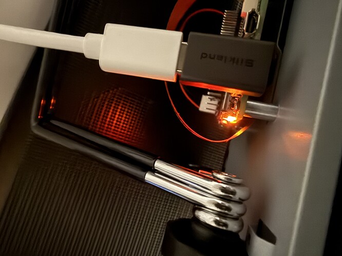

Display 1 with Raspberry Pi 5 isn’t working. Display never turned on (which is fine) and IP access isn’t available. This is with Beta 2025.03 (2253) that you provided earlier. Status light blinks from Red to Orange.

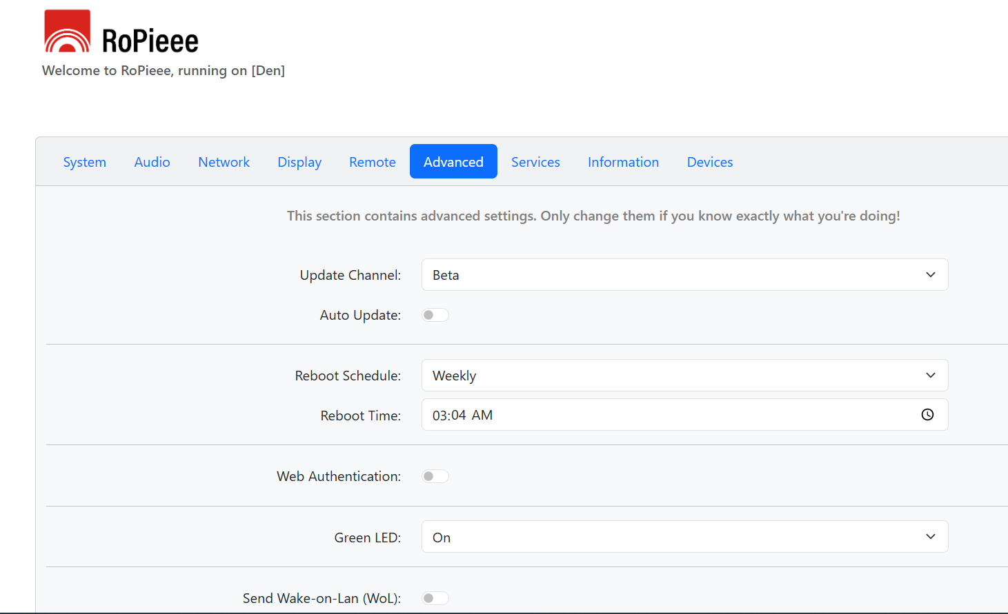

@Charles_Snider Under the “Advanced” tab, toggle to Beta under “Update Channel” and you will get a push in an hour or so.
