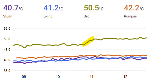

After generating the feedback I left the device sitting as is… and its CPU temp has gone up by several degrees and stayed there. I’m guessing the remote process is chewing up all CPU?

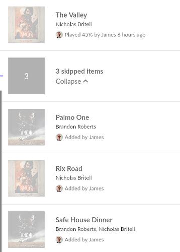

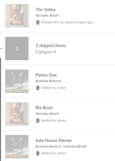

But in reality I’m not skipping them, and it never plays again (even if I then use my phone to start a new album). From the point it breaks onwards not a single sound is heard… and the display shows 0 seconds of music and then skips through tracks like they’re unavailable (whether it’s cloud or local). Maybe it’s just a broken USB remote, but the CPU temperature change seems like a clue that some sort of process is pinned on the endpoint.

I then use the phone to control the endpoint, and hit play (again it started back at volume 26) and then I used the volume slider on the phone to drop to 15). It immediately broke the audio on the endpoint, and then I watched the phone skip through the next 3 songs before it displayed “too many failures, stopping playback” (unfortunately I wasn’t quick enough to screenshot it but I’ll do this later).
