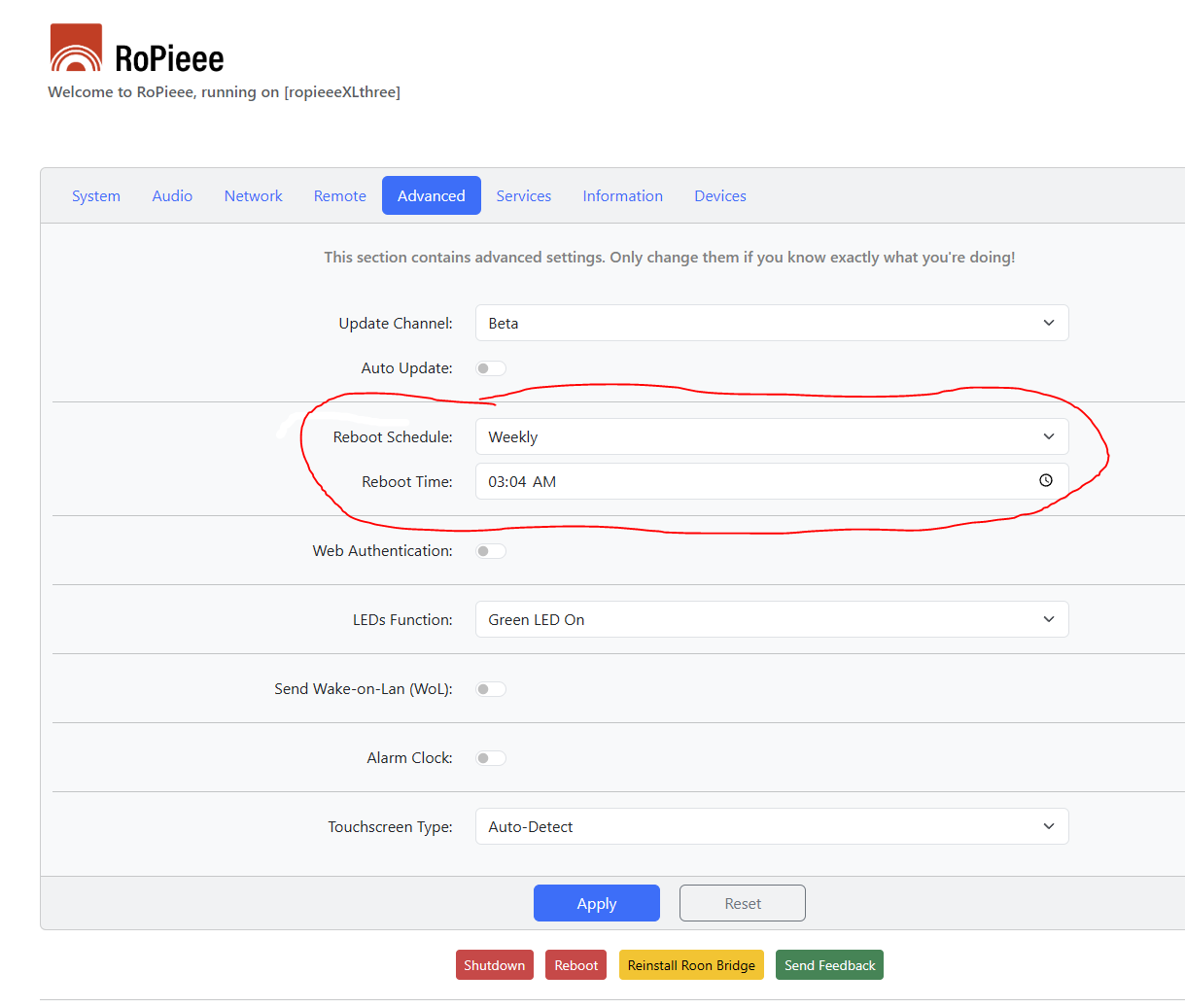

Did you check the advanced tab to see if “reboot schedule” is setup?
Also, not sure if would help harry but what timezone are you in? “8:00 this morning” could be anytime.
Thank you for your message.
In the settings, no reboot is sheduled.
And I am in the same timezone as Harry, so it is 8:00 AM for both of us. That is the reason I didn’t think of stipulating my timezone.
