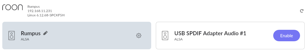

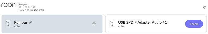

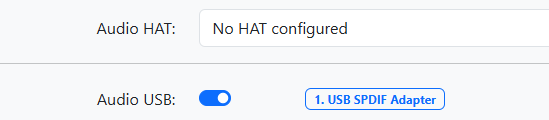

Hey Harry, I can’t do it right now but I can later today or tomorrow. I have several usb DACs of the same make/model. For what it’s worth, previously I actually tried to have both on the same Ropieee and it never worked, it never saw the second one
Hey Harry, I’ve generated two pieces of feedback.
cb16f8055c9fe06e
Just after a fresh reboot with only the one USB DAC attached (so shouldn’t be worth looking at unless you need to compare to a known good). I’ve only got the one DAC plugged in (as shown below) but for some reason this SPDIF DAC always shows up as two devices in Roon (the second named #1 but not enabled)

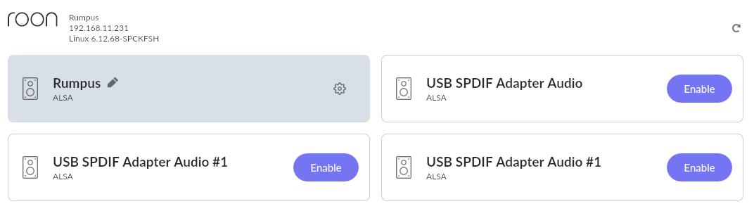

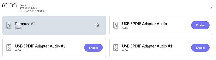

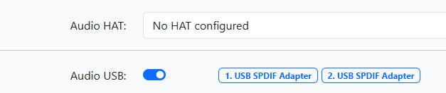

9edb407af953cfe1
After plugging in the second USB DAC (per below images, looks like both are correctly detected now)
