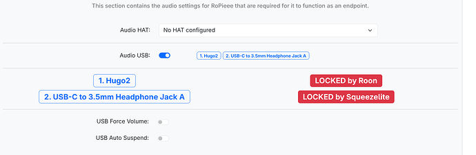

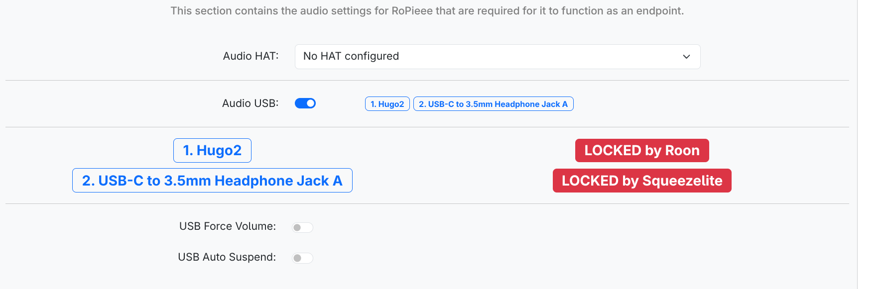

Anyways… I’ve been doing a lot of ‘under the hood’ work this release, which (among others) makes it possible to do stuff that’s been on my wish list for a long time: keeping track of who is locking a USB DAC.
So with this release the biggest change you can see on the ‘audio’ tab:
And that information is in real time.

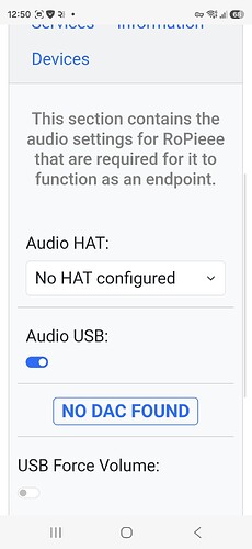

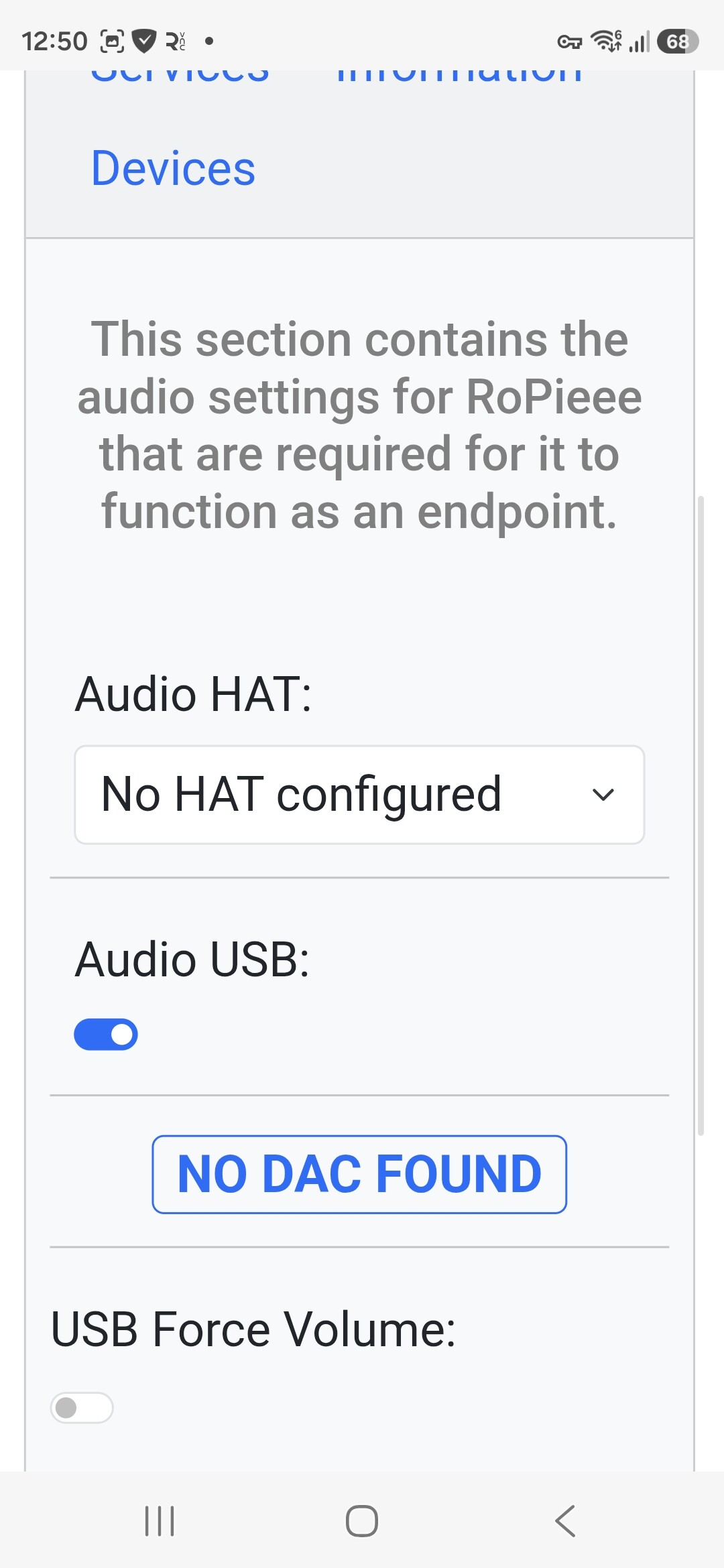

Updated RPI5 + Display2 went OK, kind of.
My RPI5 feeds two DACs simultaneously, CHORD TT2 USB and Eversolo 6 gen1 USB. Both stream music OK, but no DAC is recognized under the Ropieee GUI. I did restart the RPI5 twice, still no DAC under the Audio ran.
See log f0f0132882259b9b
Thanks
Have you tried a refresh (CTRL-R) in your browser?
I did. Several times
ok, because this is a display issue. Your logs shows that the DACs are found (otherwise you wouldn’t be able to play audio of course), so something goes wrong in the webinterface…
Which browser are you using?
I use Samsung internet browser on my android phone
On Chrome browser all is OK
Ah! that’s interesting…
Anyway, thanks for the support :folded_hands:

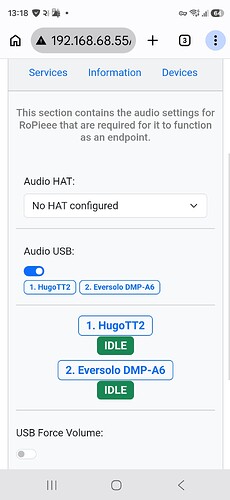

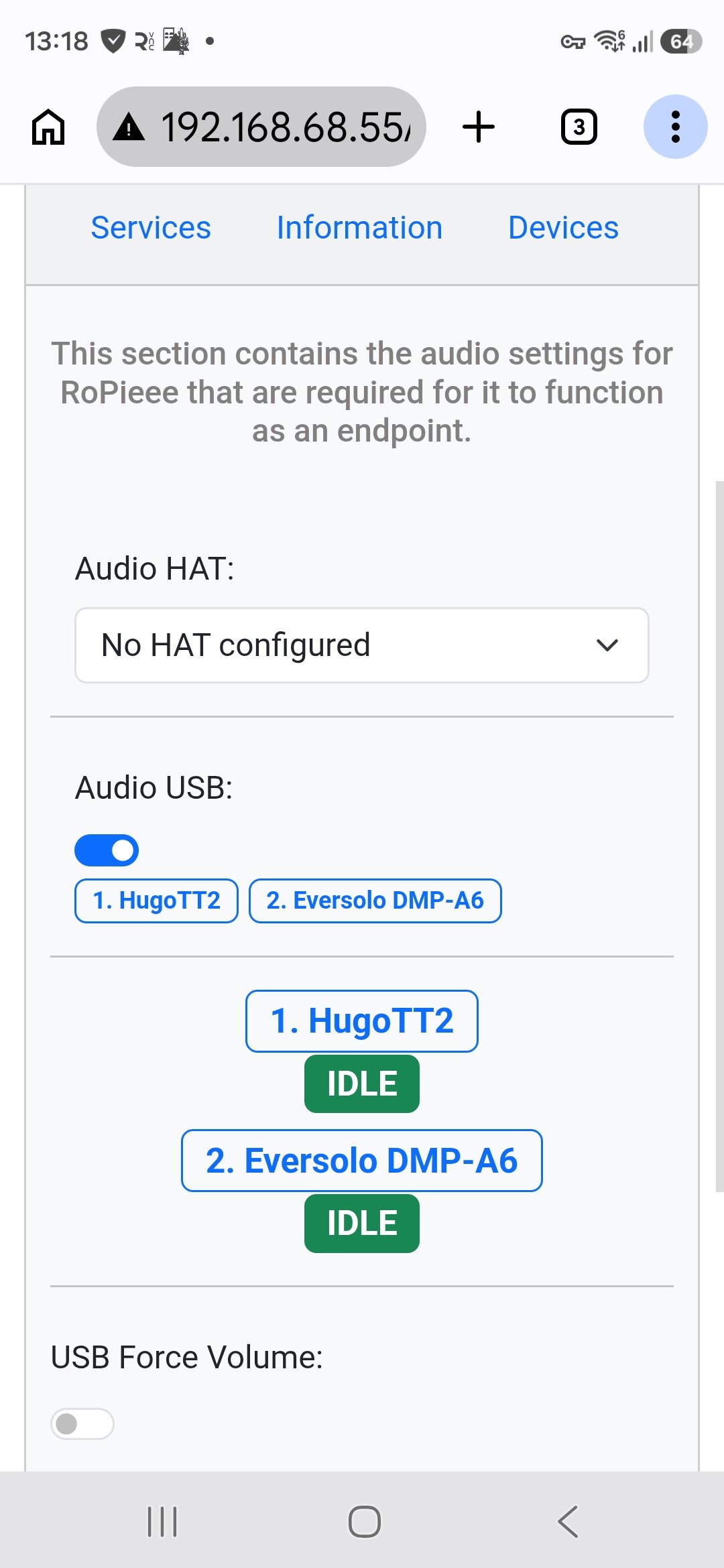

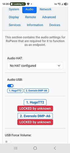

RPI5, suddenly crashed (red light on). Did a forced power up and now Chrome shows the attached screen, Samsung internet still indicates No DAC Found.
Music is streamed ok.

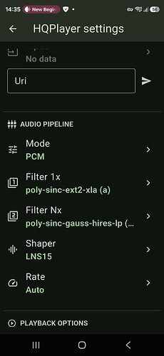

I use Roon and Hqplayer
Attached log 20683178ff53ce0a
These are the Hqplayer Filters (output set to max 768khz)
Problem solved after reinstalling the Samsung Internet browser on my phone.
The issue, was with my browser installation, even clear cache did not help.
Now everything is OK
THANKS
