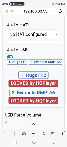

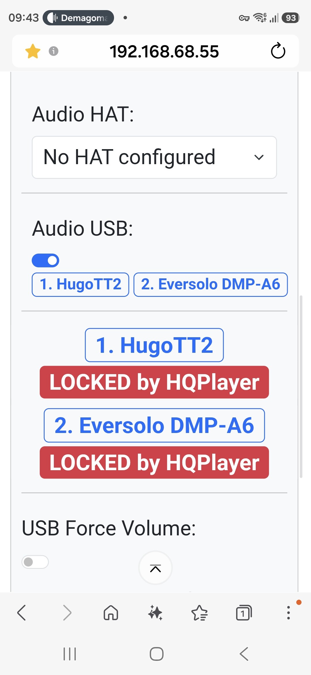

- ongoing improvements to USB DAC ‘locked by’ status
