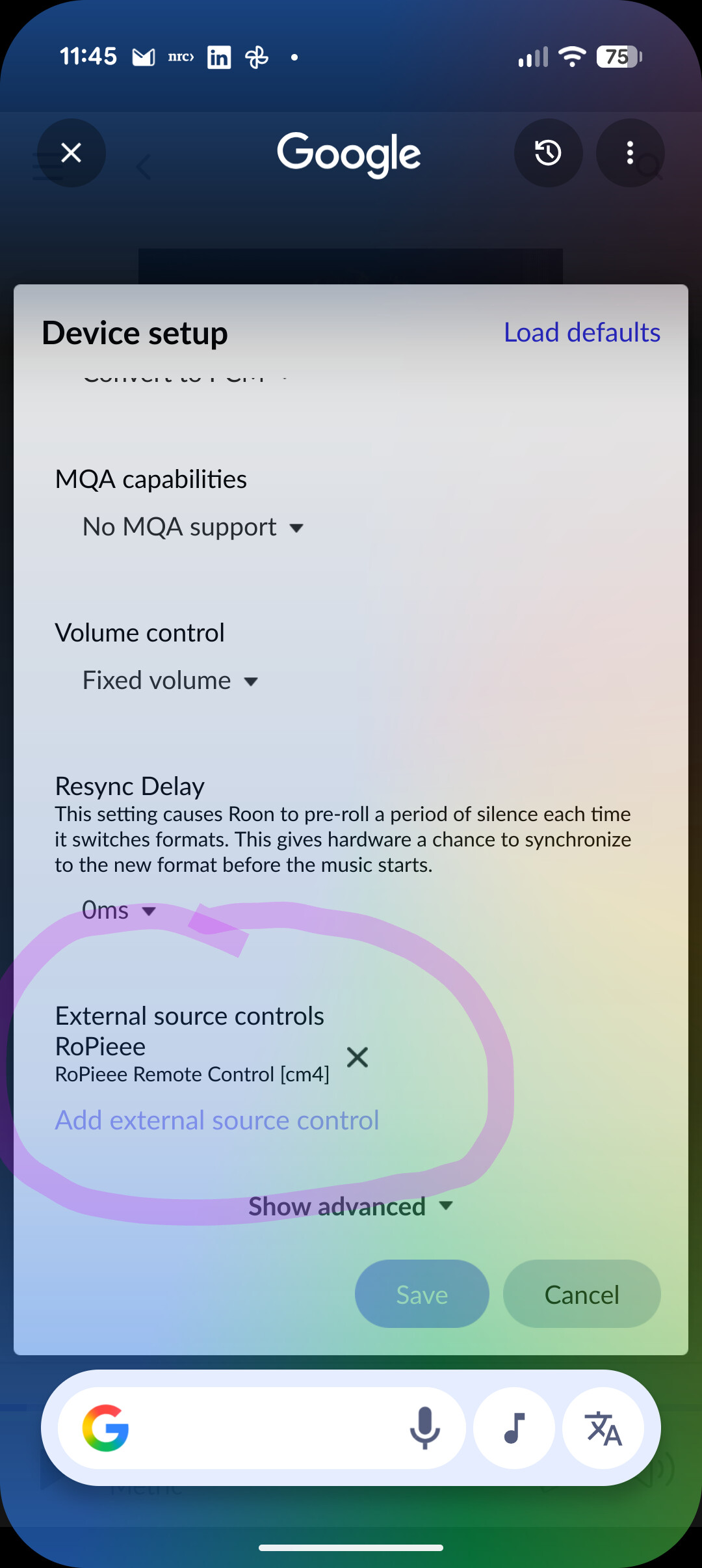

  • With Roon you need to explictely give the RoPieee Remote Extension also access to the source controls. You can find this in the ‘Device Setup’, where a ‘External source control’ option shows up. There you can connect a certain RoPieee Remote Control. It looks like this:

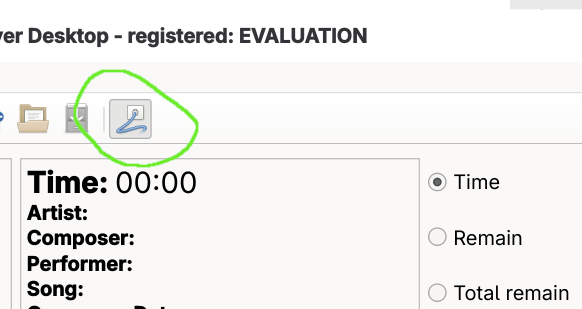

  • With HQPlayer you need to enable (once) the remote control access. A tiny, not so obvious button :wink: . It looks like this:

With HQPlayer ‘hitting play’ isn’t enough: the first time this will take care of stopping the current running services, but it needs another hit on the play button to actually start it.

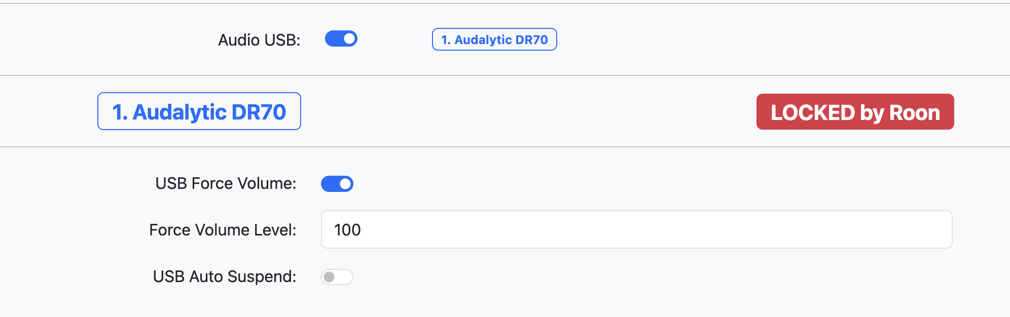

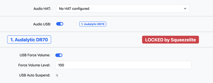

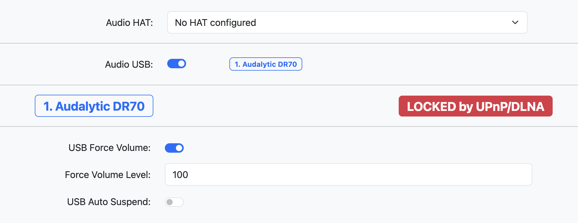

Hi @spockfish this is quite nice and just trying a couple of options out and it’s working nicely.
None of them seems to lock it when I pause the music and go back to idle, but I do remember that PlexAmp locked it a few times in the past.

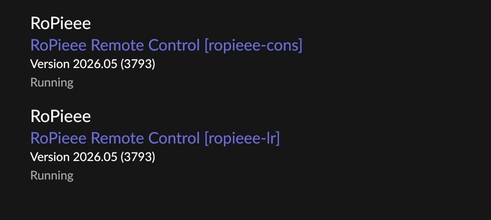

Took me a while to find the Extensions showing up in Roon Extensions as I was looking in the Extension Manager for them

Yeah, I need to properly document it, because indeed this a little bit hidden in the Roon UI.

The new convenience switching works wonderfully, thanks very much indeed Harry.
I am now able to switch back and forth between Roon/RAAT and Squeezelite; this never worked reliably before, often requiring a Ropieee reboot, but is now 100%. Excellent!
