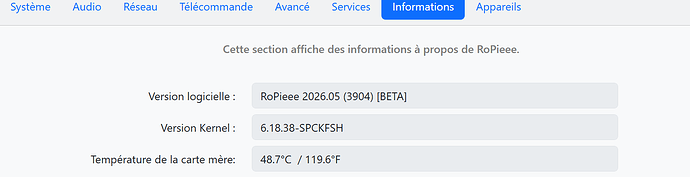

Just a quick question, how do you see the version number displayed (Release 20260717) ?
Not. The beta releases follow a simple timestamp format that doesn’t suite RoPieee’s version scheme. However, I’ve synchronized the build numbers, so 3904 properly identifies this beta build.

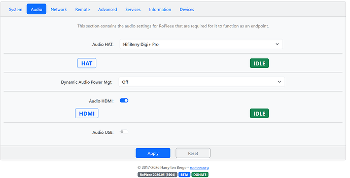

Updated both of my pi3/4 to the latest Beta. It appears that Roon does not recognize the HDMI option at all. Switched the HDMI outputs on the P4, no change. Receiver Onkyo RZ730.
Feedback here 8c9d947a12f13ca7
Roopiee output screen

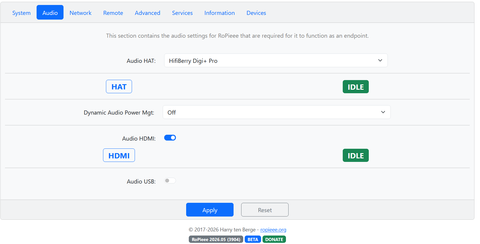

On the Pi4 side, things look ok
