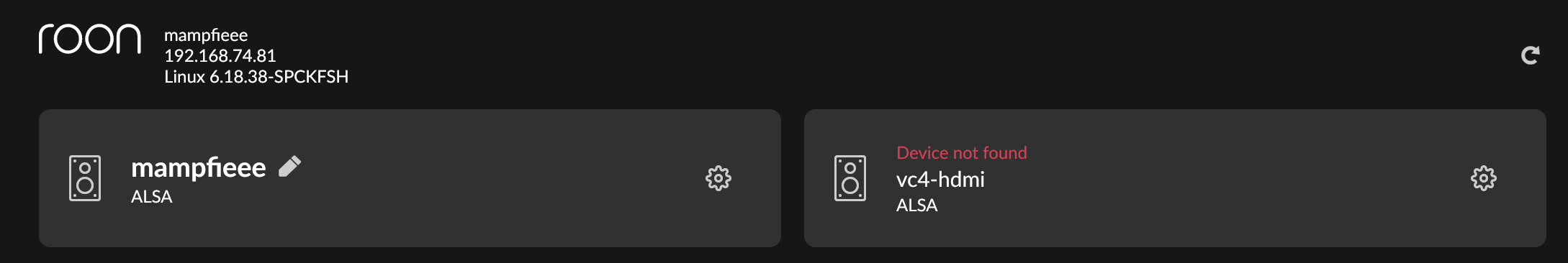

Hello Harry
thank you for this quick update.
After updating it just says Device not found. I did send feedback: 853e91b14b0a3f37
After a reboot and some retrys: 24d2f0a43b1f69ac

yeah… there is improvement, but still no green light.
I need to figure out what the difference is between your setup and mine. I’ll create another build with some more information.

Yeah, but that’s not the case here. The device is there, my changes to the Roon config have made it in, but somehow it still doesn’t see the device.

Roon does not recognize the HDMI. Switched the HDMI outputs on the P4, no change. Receiver Marantz AV8802A.
Roon Audio screen
Feedback here ebb36c37a7cea1dc
Regards
Was the receiver on at the time? I’ve had the same result with a Denon (like Marantz) while the receiver is off.

Same thing here with an Onkyo RZ730 latest firmware.

Yes, and I checked that the HDMI port was correctly configured and active.

Yes, have mine on and no change. Maybe Roon does not read the HDMI status signal correctly.
Works through a Win 11 Wasapi without a problem

Yeah as mentioned: with Roon there’s something still not working as expected. Spend the weekend figuring this one out, and I think I might have solved it…
So preparing a next beta build that addresses this.
