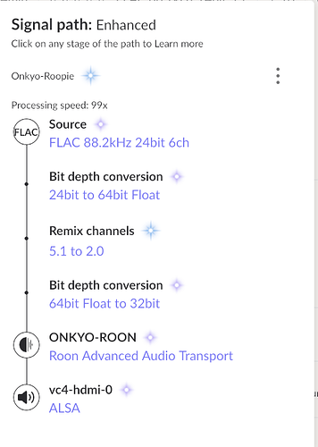

Works with an Onkyo RZ730 up to 192kHz 24 bit 2 channel.
It however down-mixes 5.1 to 2.0 with no option to change it in settings.
Any chance to get it working with multichannel?

Not for now. That’s for a another day.
It also requires me having a some sort of multi channel device to test with, which I don’t have.

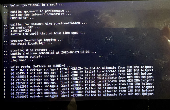

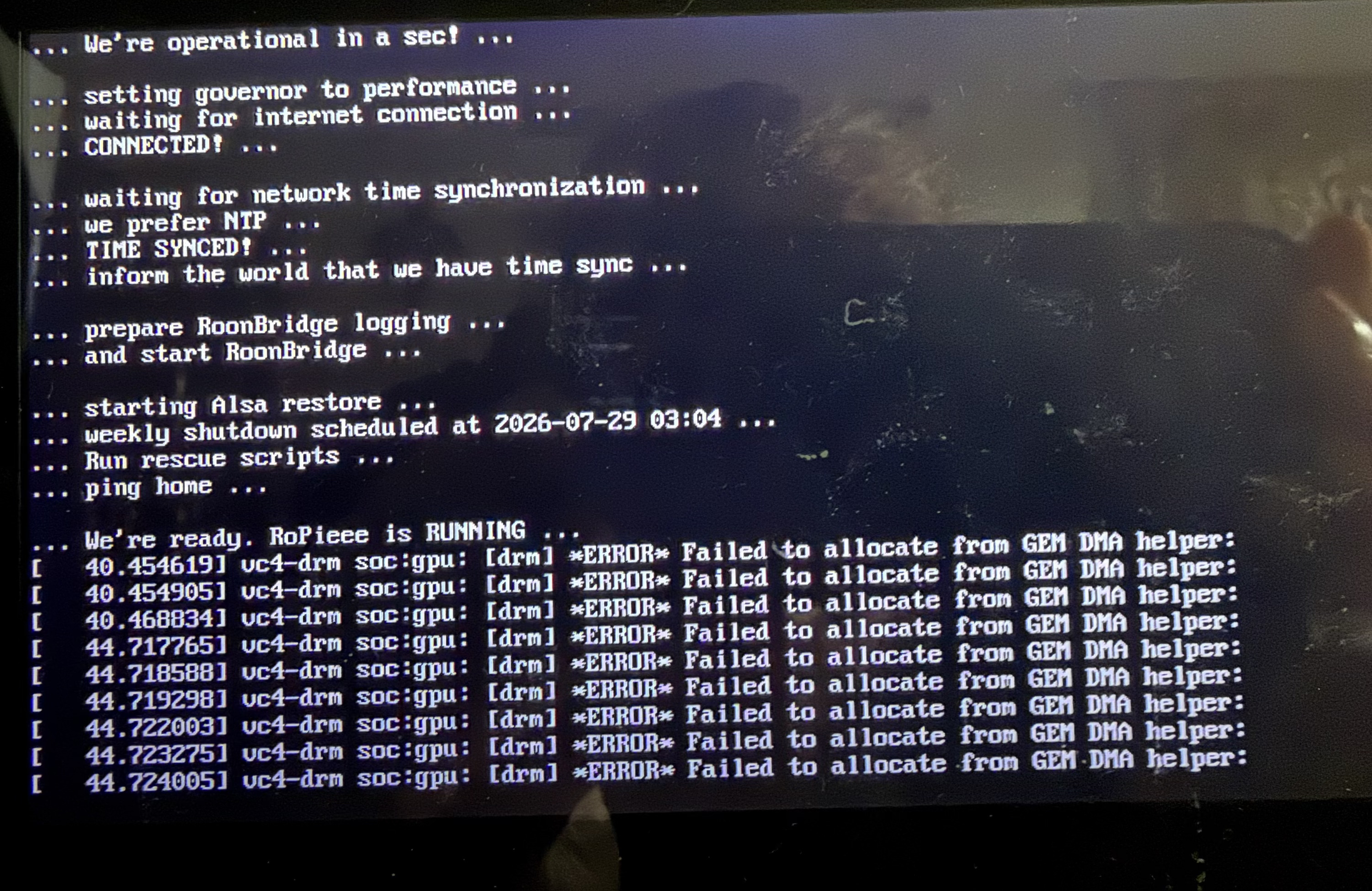

Thank you for the new Beta, it is working now with my pi3 and the VSA LX805 with several formats in stereo. Feedback: ddcedda3915dec75 There is some DRM Error on the display:
You guys do know I’m located in the Netherlands? ![]()
Yeah the warning is harmless.

Feedback: 7130567b66dbe162
I’m still investigating, but it might turn out that a touchscreen together with hdmi is not going to work…
