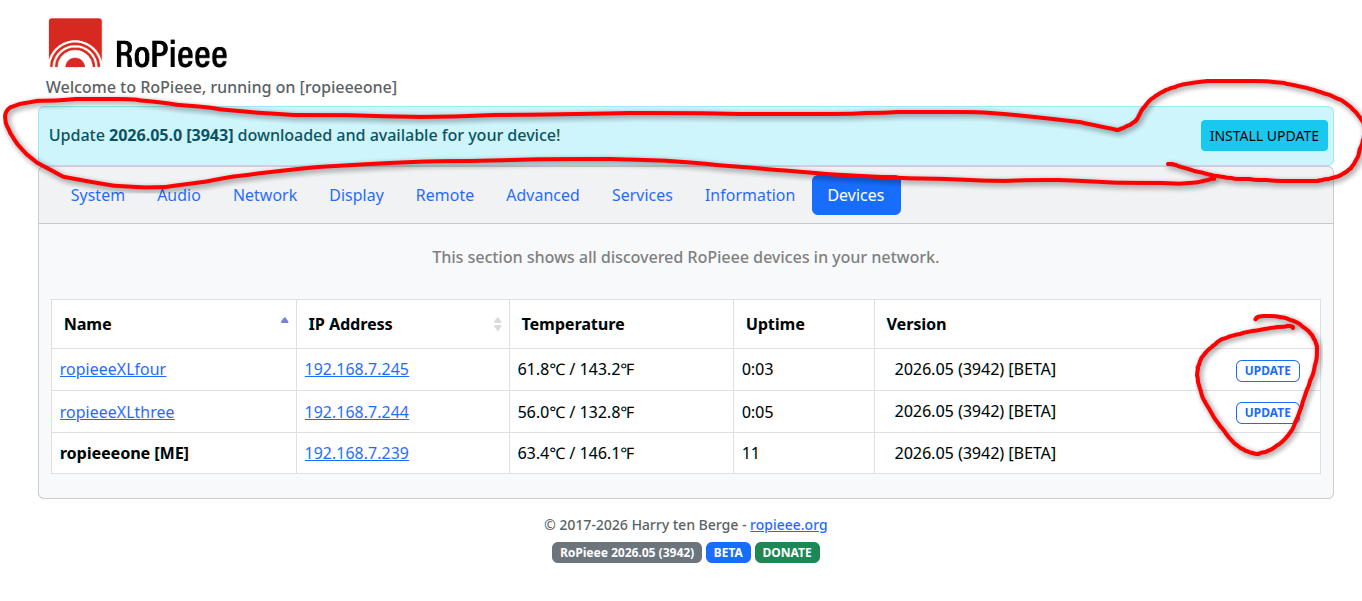

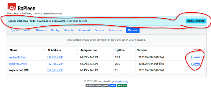

FWIW: The update banner and the update radio buttons are still showing on all devices.
Edit: feedback sent, if you need it: 10586661240aec8e
Thanks. But the issue is clear. This will resolve with the next beta.
