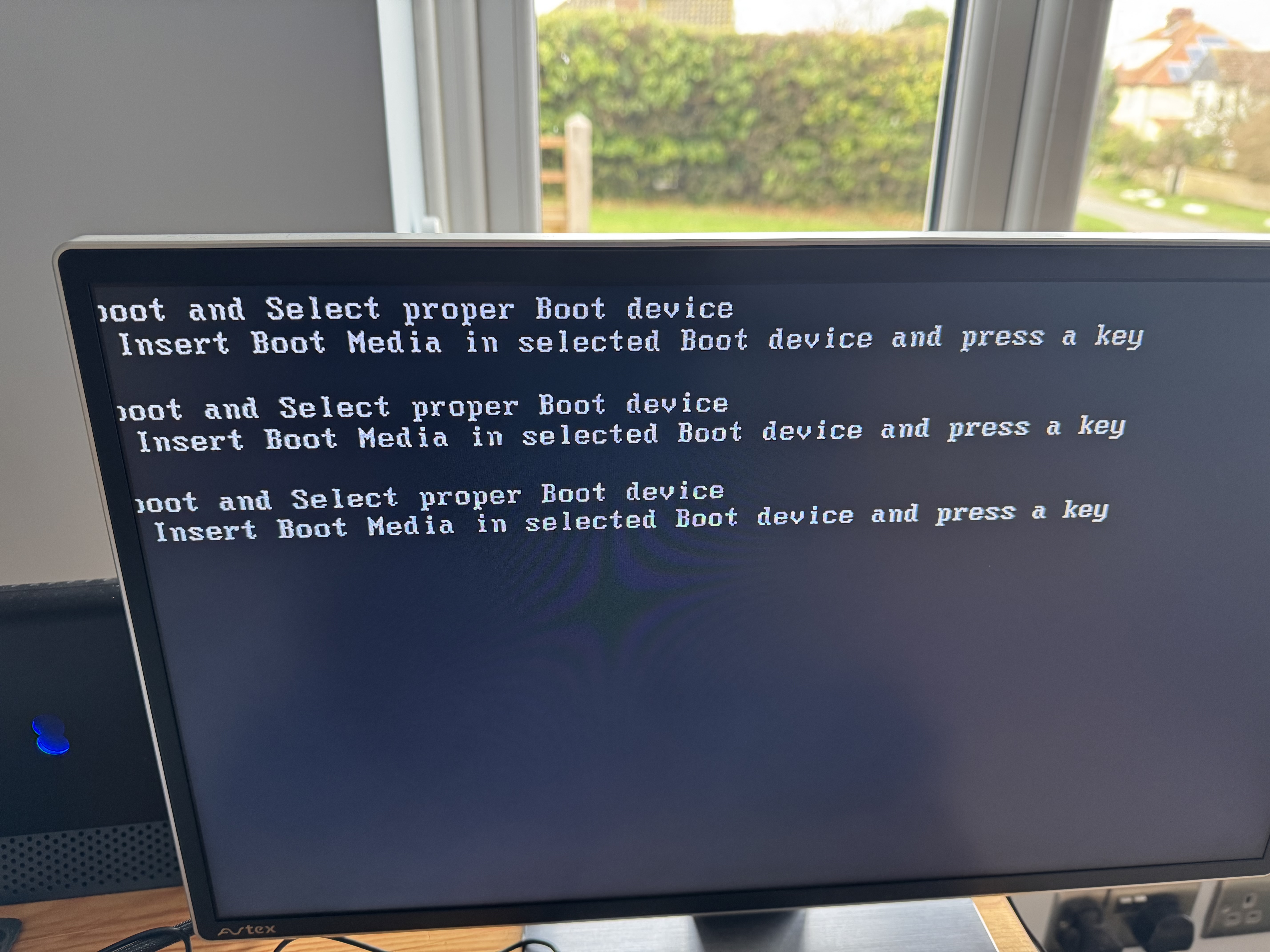

Thanks. I have connected to Nucleus to USB keyboard and TV/monitor via HDMI. The Roon logo appears with the instruction F2 Enter Setup; F7 BIOS F10 enter Boot Menu
However hitting the F2 key causes this to disappear and the screen go dark….no text. The other two options seem to offer something….F7 I can read, but F10 is off screen and I can just see a text box.
How do I proceed please? Thanks

Hi Vadim, the system stopped working and I put a new CMOS battery in. Then it seemed the hard drive failed at the same time so I installed a new one.
That is as far as I have got. I tried to install the software via USB prior to installing the new hard drive but that is when you suggested the hard drive needed renewing.
I did this and could not get the Flashed USB to install so took it to a repair shop. They also failed.
So I have a Rev A with new battery, a new SSD for the operating system and the existing storage SSD.
I’ve just tried the ROCK install guide , but as I cannot access the F2 menu nothing happens. I tried to install using the alternative method using F10. On selecting USB as boot I get a message saying
‘Welcome to Grub!’
No other text
Now what, please?

Thanks.
The grub message stays permanently.
I already tried a different USB and bought this new one as the first one didn’t seem to work.
It is a brand new SSD so I doubt it has any partitions, but I don’t have any way to connect to a PC to try to read it.
I’ll see if a local repair shop can help with that and try again, but it seems that nothing is working. It has been months that it has not worked. I will not throw more money into Roon by buying a new Nucleus as the whole system seems to be very unstable judging by my experience. A help section that is live would be so much more useful than a messaging system that has days in between answers.

I have used a different USB, checked for partitions, but it still stuck on the welcome to grub page.
I can now access the BIOs (f2) settings and followed the instructions
I have reflashed onto a new usb but still stuck on the grub page
