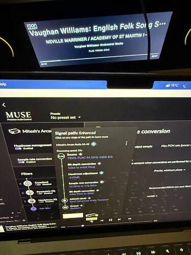

This shows the Audio file as 44.1kHz 16 bit in the signal path of Roon app but is showing as 192kHz 24 bit on the SA45 for the same audio file
The issue I see is your signal path is leaving the bit depth as 32 bit and your DAC doesn’t recognize it. I’d set your DAC bit depth to max 24 bit in Roon

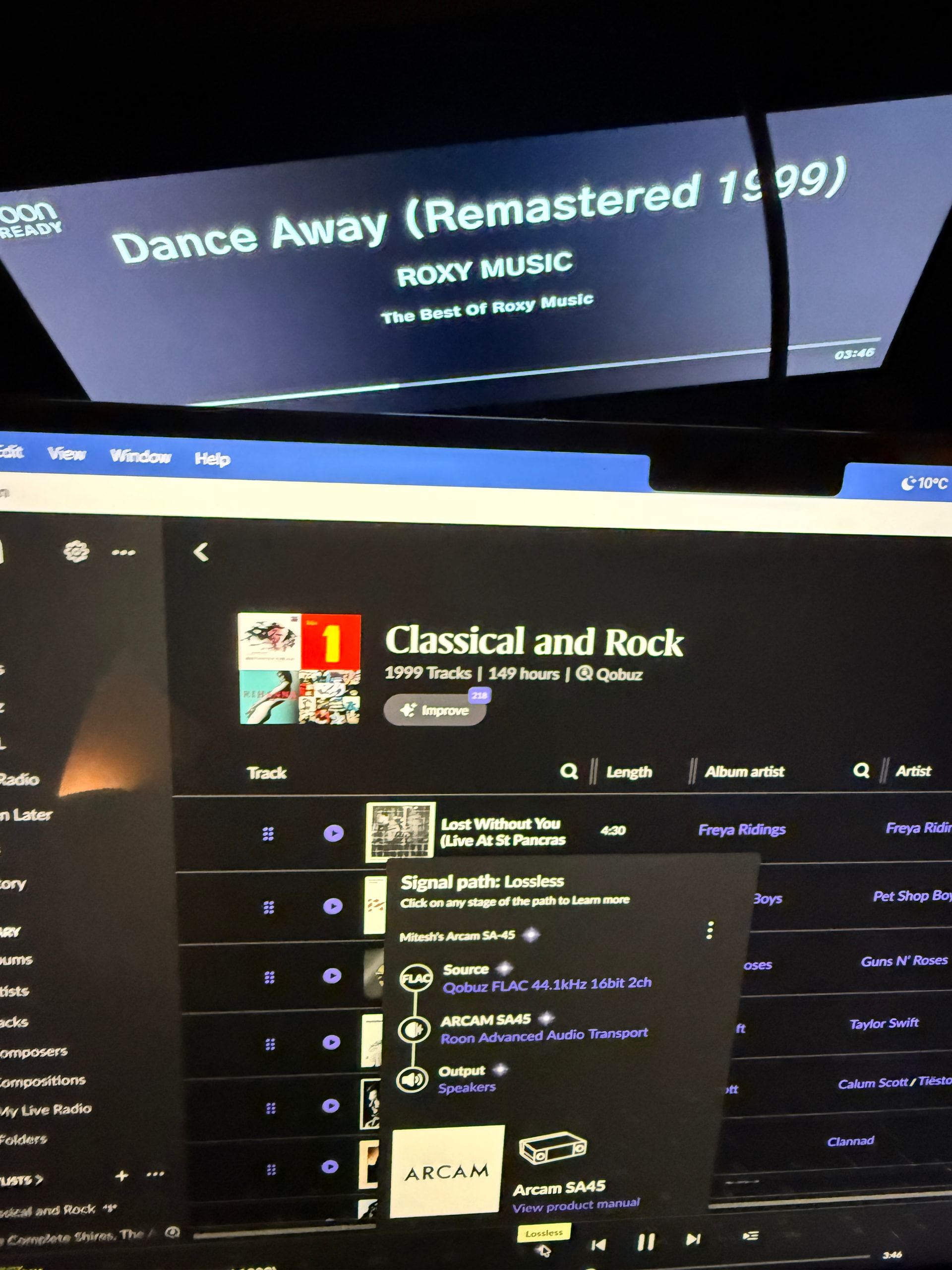

Tried Stefan_Mauron’s suggestion ….The SA45 doesn’t show any sample rate or bit depth metadata whilst as you can see below in the signal path the Roon app does…..
Looking at your two screenshots, I think this actually explains the issue quite well: In both cases you’re using Roon as the source, but the Arcam SA45 behaves differently: in one case it shows a (different) bitrate than Roon, while in the other case it shows no bitrate at all. Hence, same source, same signal path but different display behaviour on the device.
That strongly suggests this is not an audio problem, but how the SA45 interprets and reports the incoming stream.
So what you’re seeing is most likely an inconsistency in the SA45’s reporting logic rather than any real change in audio quality.
