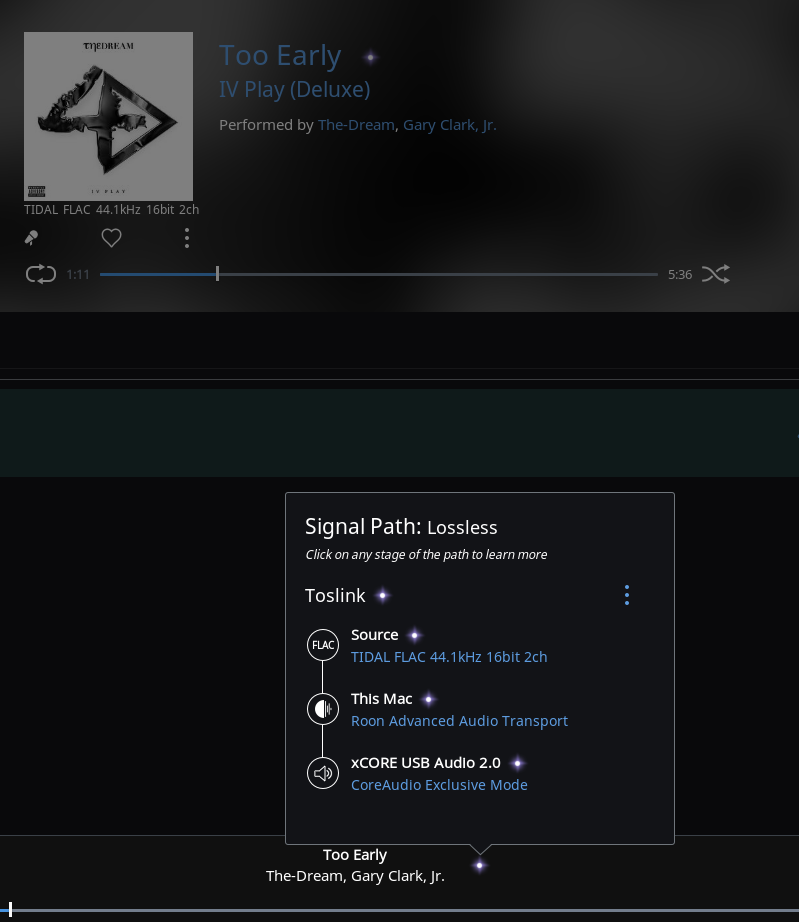

Hey @wgb113 , just to add to @xxx 's great info, if you enable ‘Exclusive Mode’ in Device Setup (see below) you don’t need to touch or worry about Audio MIDI’s settings.
If you see “Lossless” in the Roon signal path (see below), you can be assured the output from your Mac Mini is Bit Perfect.
