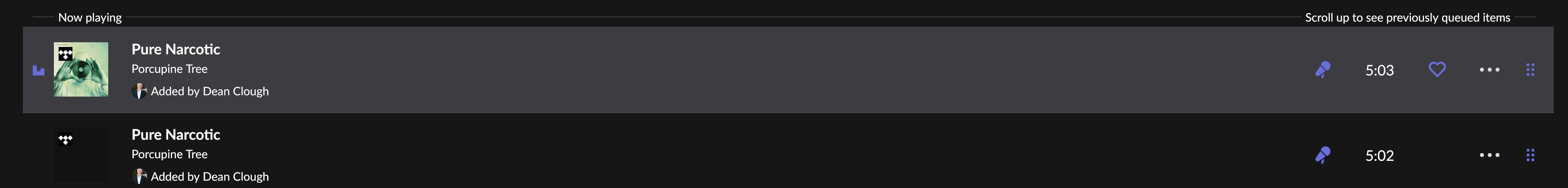

I have TIDAL playlists I am playing in Roon, where it skips a track with the “Not Currently Available” message.
But the same exact track plays fine in Roon from the album on which the track in the playlist appears, and it most certainly plays in TIDAL itself.
I know this is a common problem, but I’ve rebooted, restarted, logged out of TIDAL from Roon, logged back in, rinse, repeat, etc.
Can anyone at Roon give us an update here? Is there a fix? This is a drag of a problem, as it ruins carefully curated playlists.
Look at the queue - track from the album playing fine, but if I skip to the next track, it reports that it can’t play the same very song.
