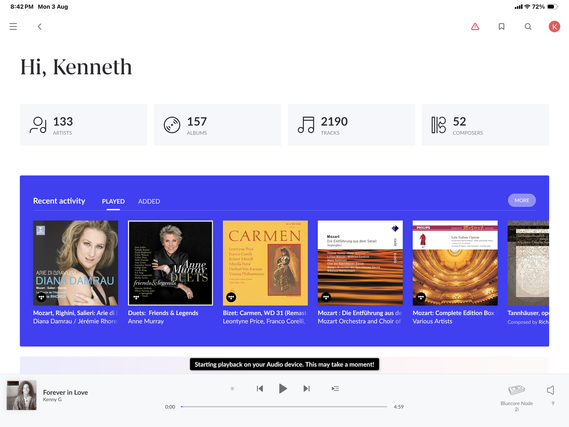

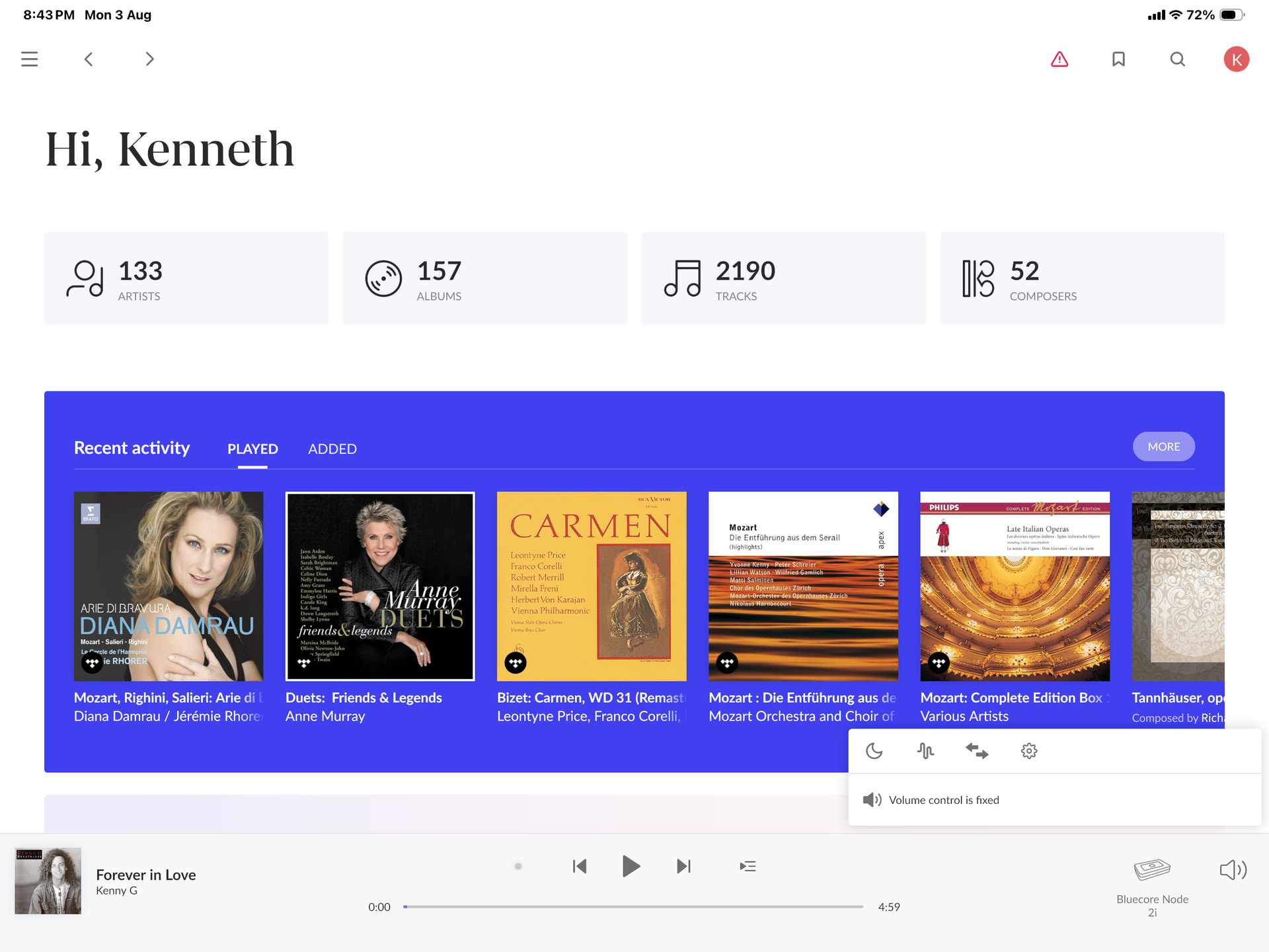

  1. When the failure occurs, the Node 2i may change spontaneously to fixed volume, whereas it is usually set to device volume. Screenshots of the two with volume set to 9 and suddenly goes to fixed volume attached for you.
Please go ahead and enable the diagnostics on my account. It is not working now.

Thanks for the logs and the volume screenshots, they told us exactly what’s happening.
The logs show that every one of these dropouts is happening on the network link to your Node 2i specifically. During playback, we’re logging hundreds of “buffer overrun” and audio “dropout” events for the Node, and none at all for your other Roon endpoints on the same Nucleus. What that means is the Titan is sending audio fine, but it isn’t reaching the Node reliably, so once too much audio has dropped, Roon stops the stream. That’s the sudden stop you’re hearing.
The switch to “fixed volume” is part of the same event, not a separate problem. Your Node is correctly reporting its volume control every time it connects; when the connection gets shaky, Roon temporarily falls back to fixed volume because it can’t reach the device to control it. So that flip to fixed volume is actually an early warning that the link is dropping.
