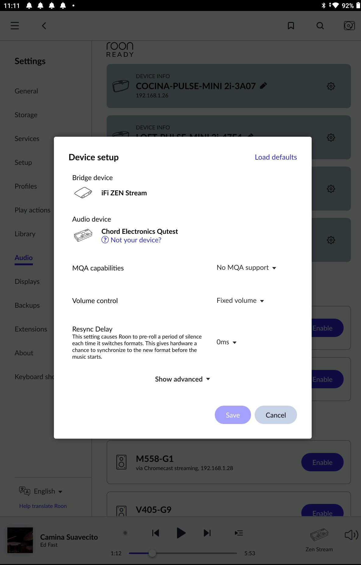

Coax is strictly one way so roon has no idea what is at the end of it, so the answer is no.
If you use USB instead of coax roon should be able to identify the Qutest, it certainly does across my Zen Stream:
