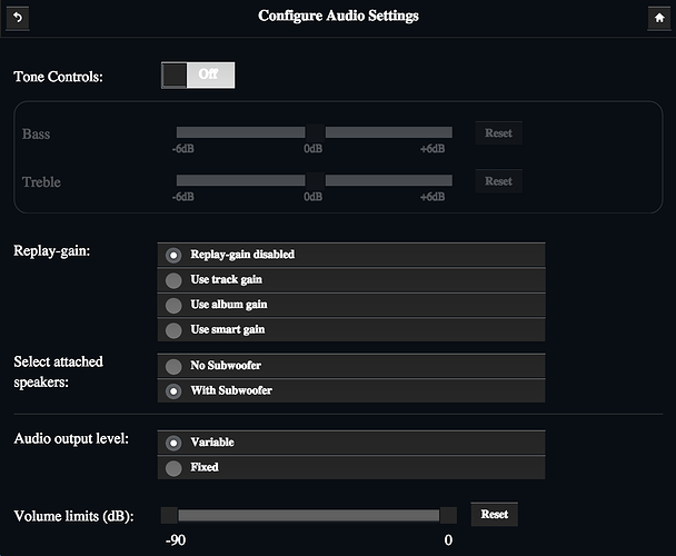

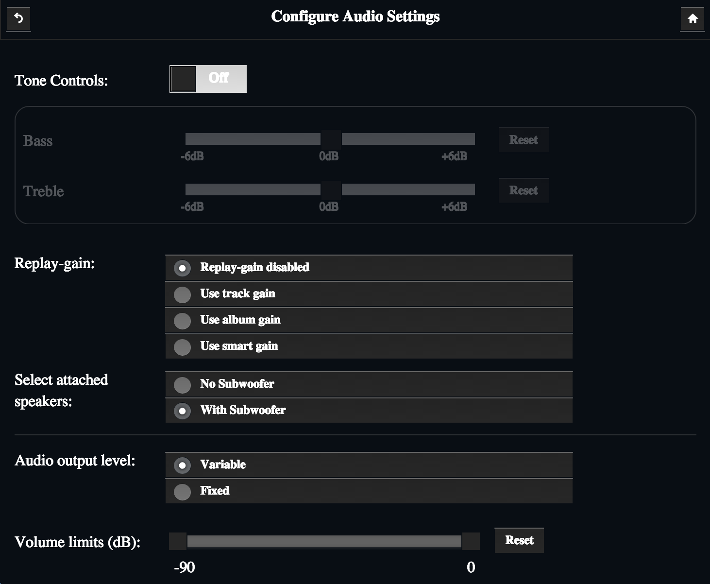

Can you check in the BluOs app if you’ve changed someting in settings -> player-> audio.
Thanks for the quick reply, stevev1.
I had fiddled with the Volume Limits setting, as well as toggled back and forth between the Variable/Fixed Audio Output level (first time ever adjusting either of these settings), but then reset it back to what it had been set at previously.
I weep
And you still see the enhanced signal path?
Yes, it is still showing as enhanced.
Total bummer
Restart roon. It should be gone
Your last message prompted me to reboot the Vault2. Signal path is now Lossless again, and Kev very very happy.
