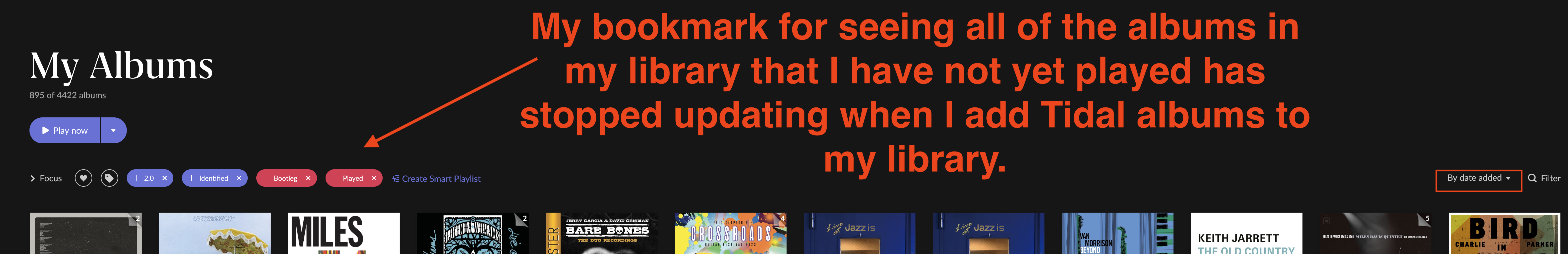

Bookmark not updating with new album additions (ref#CC1PP3)
Bookmark no longer updating when new albums added.
Not a network issue.
Hi @Nick ,
If you manually re-create this filter, does that work as expected, is it only the bookmark that is affected?

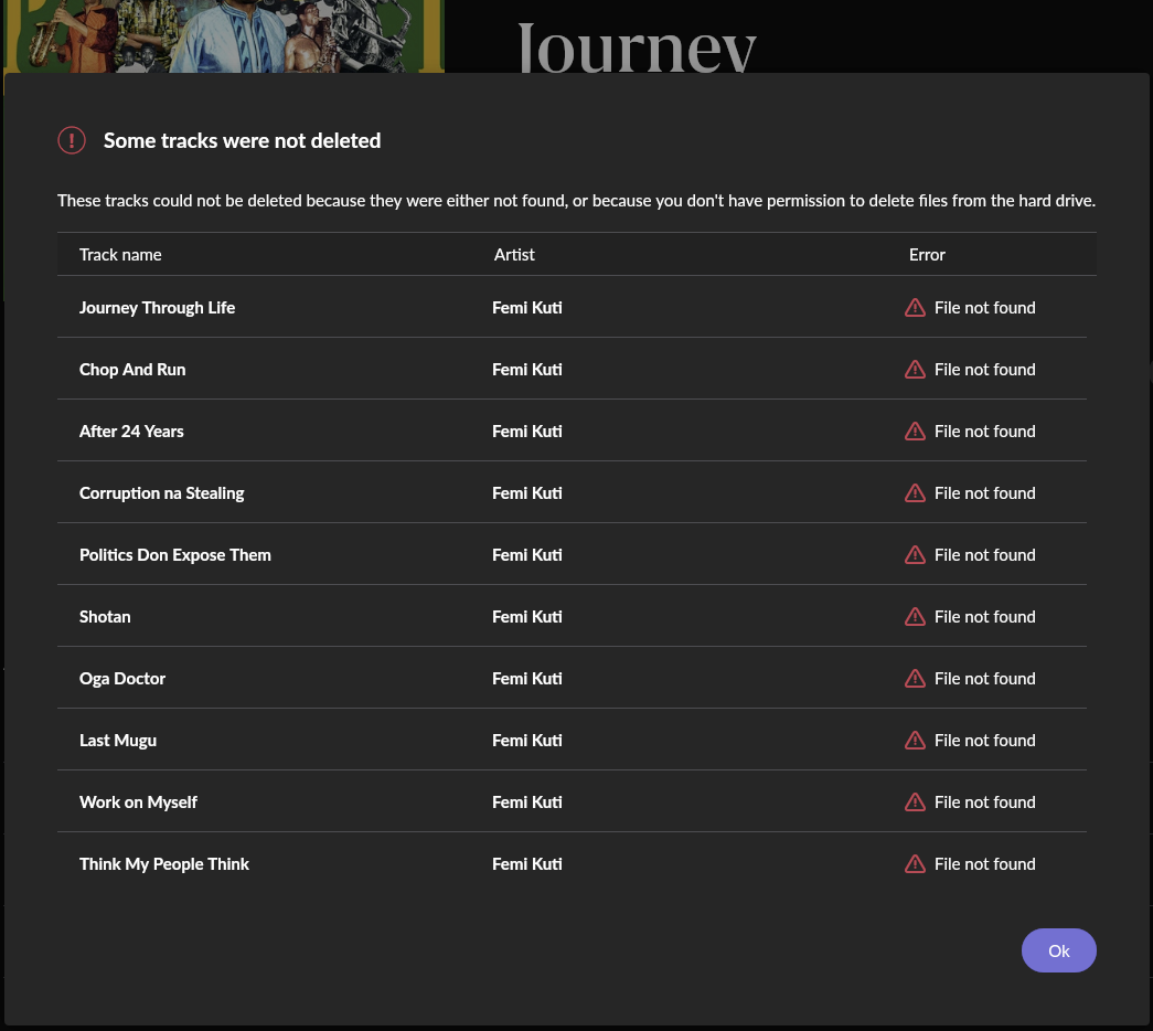

When I recreate the bookmark, it starts working. However, now I can’t delete anything shown in the new bookmark or the old one. For example, I just added a Tidal album, went to the new bookmark, clicked the album, and then on the album screen clicked remove:
After that error, clicking remove does nothing.

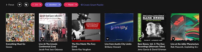

I figured out part of the problem here. I use the “2.0” tag to filter out multichannel. However, I discovered that this does not work with some newer Tidal releases even though they are two channel. I removed the “2.0” tag from my bookmark and changed it to an inverted “5.1” tag and that works. Still have the issues of not being able to delete albums though…

I think it improved things. Adding and removing albums seems to be fixed. I still see a small number of Tidal albums that I believe are two channel that are saying they are not:

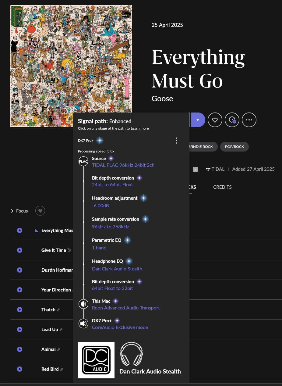

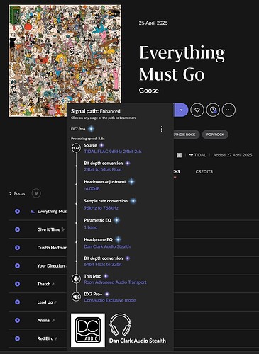

Hmm, it is strange indeed, I did try a few of these albums and they appear 2ch on my end as well. Is the behavior the same if you try to remove and re-add one of these albums? If you play them, the signal path shows as 2ch on your end, is that correct?
Using the first one (Goose, Everything Must Go) as an example:
Thanks for the screenshot @Nick -
What happens if you remove one of the issue albums and re-add it to your library?
No difference. Perhaps an issue with the Tidal data?
