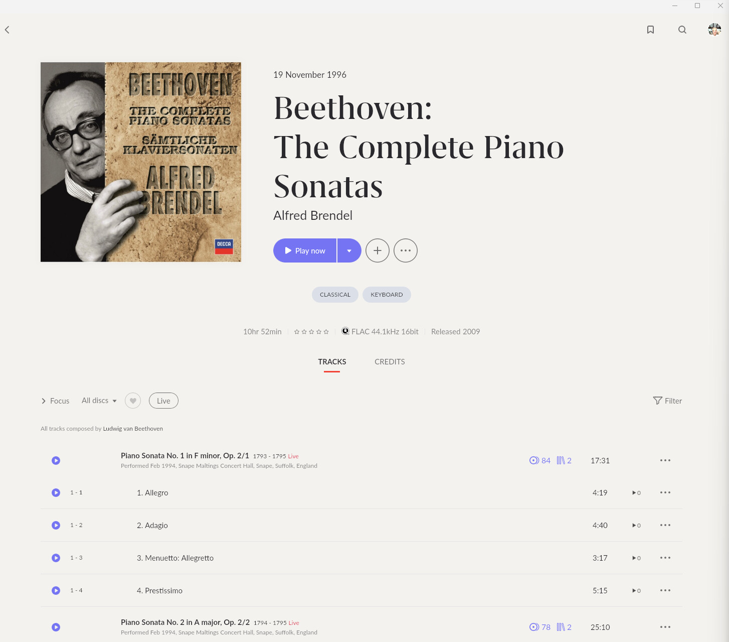

I can’t see the Philips set of Brendel’s complete Beethoven sonatas in Roon’s database, only the Decca version from 1996. And Roon knows about 908 albums and boxsets with Karajan, but unfortunately not the one you have…
Brendel is in the db.

I wonder where the difference in playtime comes from.
Ah - good to know - wonder why it is not showing up in his Discography then…
@Olivier_Lengwiler - since it’s there, you can try identifying the boxset manually to get Roon to populate the metadata fully.
Go to the Album page, click the “3 dots” icon and choose the Edit option. Then click the “Identify album” button to see if you can match it up with Roon’s database entry…
Yes, he can/should do that eventually, but the content should match the metadata or further trouble is incoming (see my remark about playtime).
Be interesting to see what happens. I notice that, at the moment, his Unidentified version says that there are just 2 other performances of Sonata no. 1, whilst my Roon says that there are 84 available…
