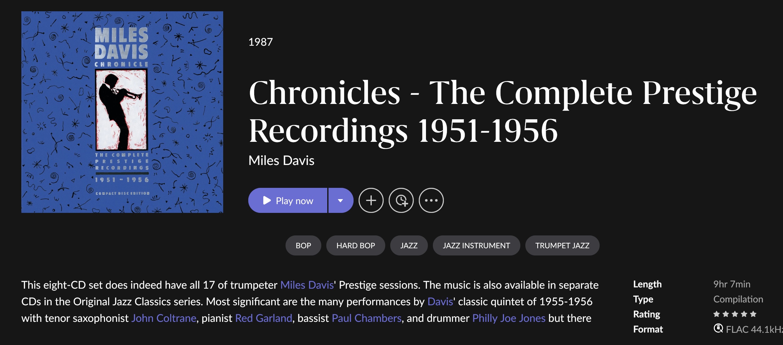

This one?

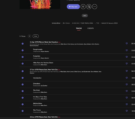

Has like 90 tracks. That is a lot, but as all are well-tagged regarding composers, performers and compositions, I kind of have the feeling it is browsable as one album. Sometimes you have to focus.
I agree, but think this is very much an early Jazz thing with lots of sessions being recorded, and maybe bootleg-worthy rock (GD and alike). This does in my understand defy any idea of structured browsing, you have to live with the vast track number within one album, and apply roon´s multi-dimensional browsing methods, like focus.

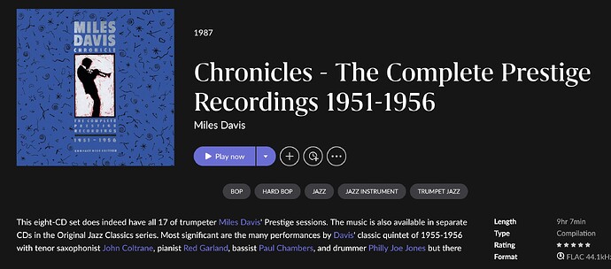

At one point Media Monkey 4 had an add-on function that allowed a particular file to be associated with more than one album. So the single file for Miles Davis’ Morpheus, for example, could be associated with Track 1 Disc 1 of the box set Chronicle and with Track1 of the Miles Davis album Miles Davis and Horns, whch is where it originally appeared on cd (it was track 2 on side B of the lp). I never did. get that to function consistently, but I appreciated the idea.

in my experience, Roon does not recognise the GROUPING tag. SECTION can be used to tag an opera Act, though I have used it in other situations, such as the live Miles Davis “bootleg” releases, where recordings were made in multiple locations and across multiple sets on the same date. Eg WORK = location, SECTION = performance date and set number, PART = the actual track. Or sometimes have WORK = location and date, PART = actual track. I know date and location have their own tags but doing it this way as well gives a pleasing result, for example:

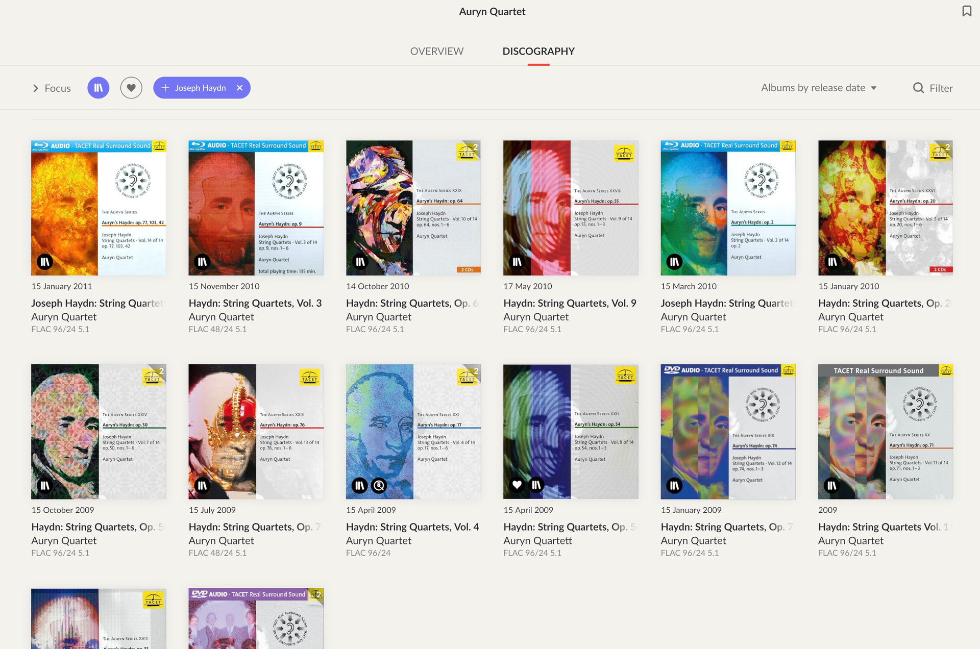

Where a box set comprises individual releases (eg Hyperion recent box set of Romantic Piano Concertos), then I tag them as individual releases with the associated performer and album artwork and use ROONALBUMTAG as “Romantic Piano Concertos”. This combined with the ORIGINALRELEASEDATE enables a smart playlist to be generated with the albums together in the correct order.

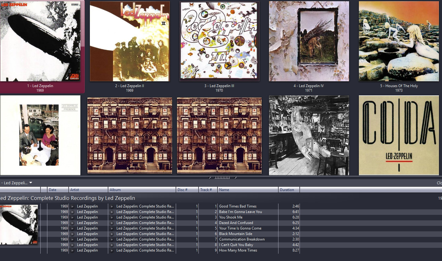

That is about what I was thinking , I have set up the same in JRiver but i have used a Custom Tags [Box Set] where you have used [Grouping]

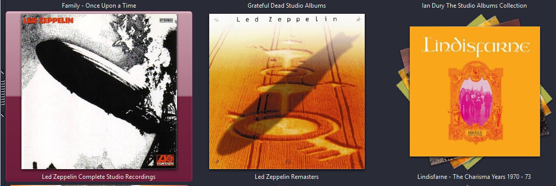

In Roon’s current infrastructure a Tag is the nearest object to box set . Fixed set , a container for a collection of albums, already a visual “Box”. Sorting default is wrong but that s a minor code change . It would be needed to have a single image “Box Image” rather than the composite 4 album covers.
BUT at best its a template for manual editing , NOT very Roon, this is a typical example BUT it is a collection of solo albums

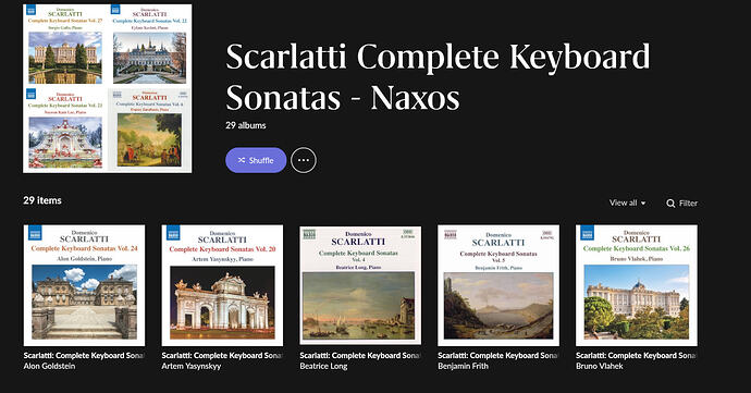

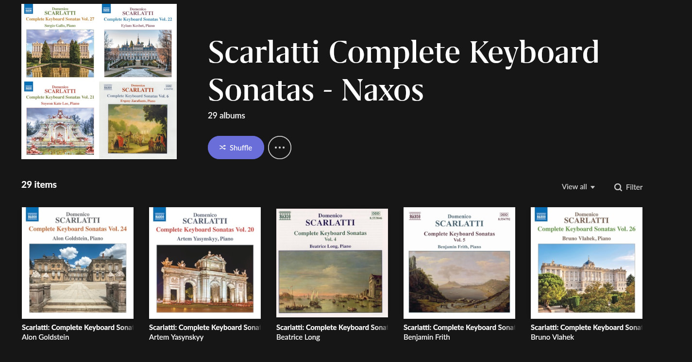

This example looks to me more like a playlist of albums, grouped by tags, than an existing boxset release. If albums exist as separated releases and have their own title, cover and release date, as sourced from Xperi/MB, I personally don´t see much value in the fact that they were released as a set as well.
Have some of these in my collection, and tremendously enjoy them, but I don´t see the problem in browsing the albums, and seeing the overview in artist´s discography, focus-filtered, or alike:
As you ask, I was thinking about examples, but I would say yes in every case I think about so far. I personally like the roon approach that album releases are the main foundation of browsing logic.
