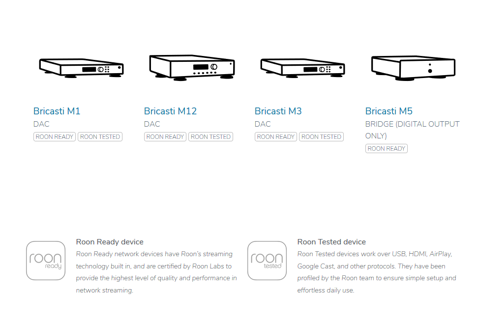

Hmm, according to Roon’s web site, the M3 should be Roon Ready and Roon puts it in the Roon Ready section of Settings==>Audio.
