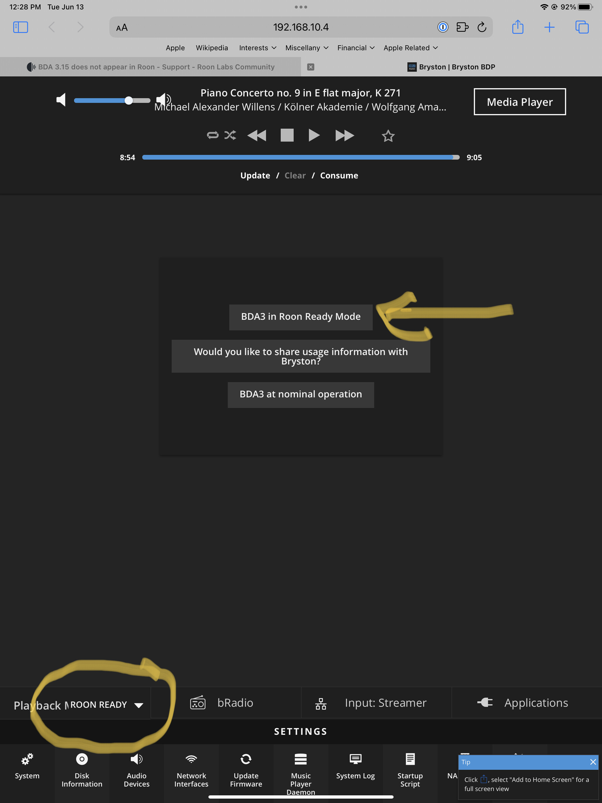

Do make sure you’re running the latest Bryston firmware. It only got officially Roon certified about two years ago, as I recall?
Then, make sure you select Roon as the streaming mode at the bottom left on the main page of the streamer interface. You can select Manic Moose or Roon, but you have to pick one.
Your response was very helpful since it is hard to find set up instructions for Roon.
